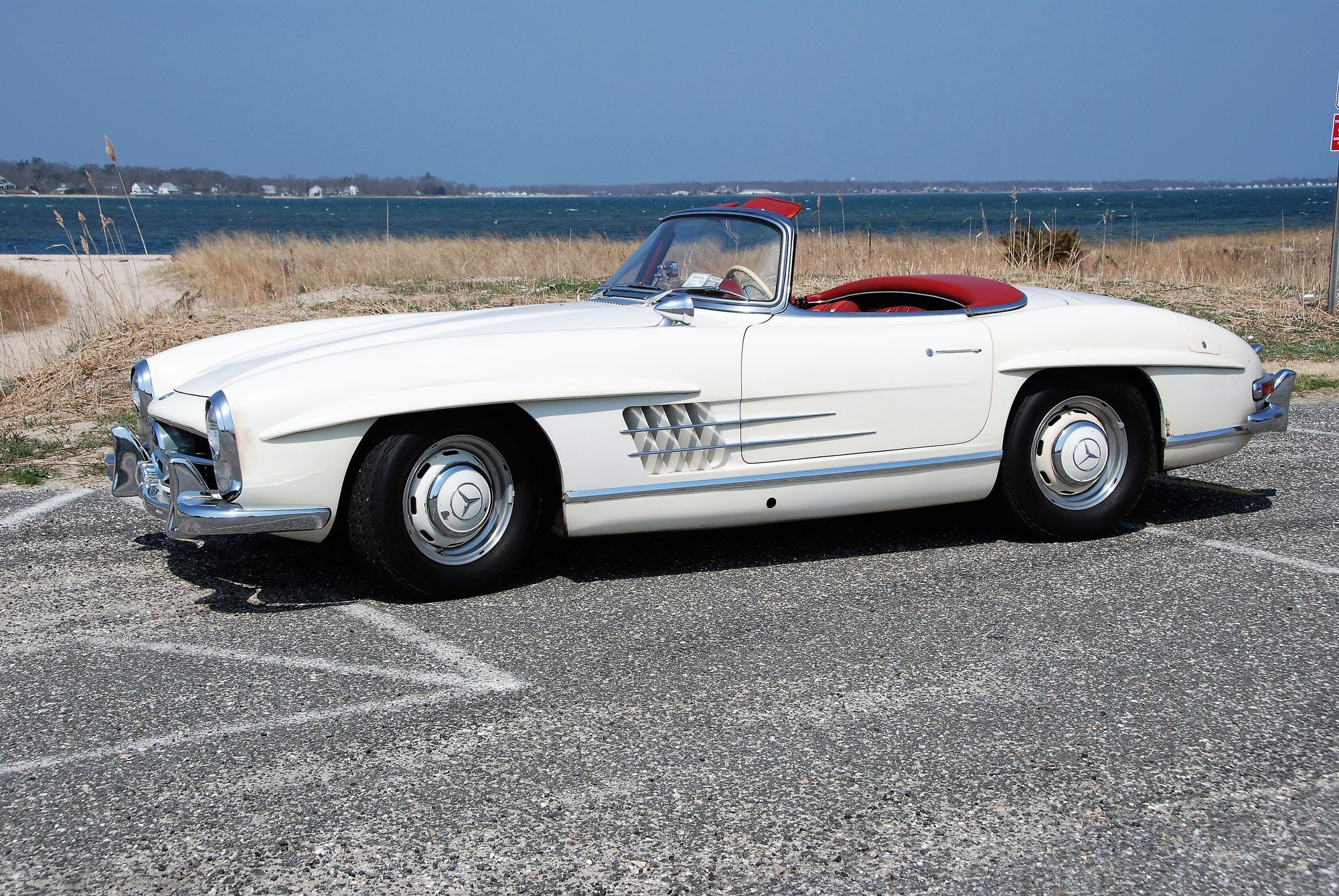

Started and drove a car today for the first time since November, 2018. Battery is a Sears Die Hard that has been in place since 03/11/1999. No trickle charger or battery tender involved, only a disconnect switch for when the car is not in use, Car was purchased new by my Mother and now has 79,965 miles on the odometer. Paint is original. I did however add some coolant before going out on the road. It ran beautifully.

Beautiful Mercedes! I've lusted after one of these since I was a small child in the early '60's. Timeless design, and worth a gazillion dollars today. Wonderful to see an original survivor like this...thanks for the post. 20 years has got to be some kind of record for a car battery!!!

Your Mother had great taste! That is a beauty. You are a lucky man.
