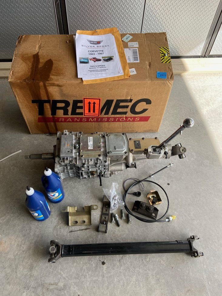

Again, the stock TREMEC shifter location is in the middle of the transmission. You will have to modify the console to make it work. The vendors such as SST modify the shifters, as and example of the differences see below:
Stock TREMEC
Modified TREMEC:
