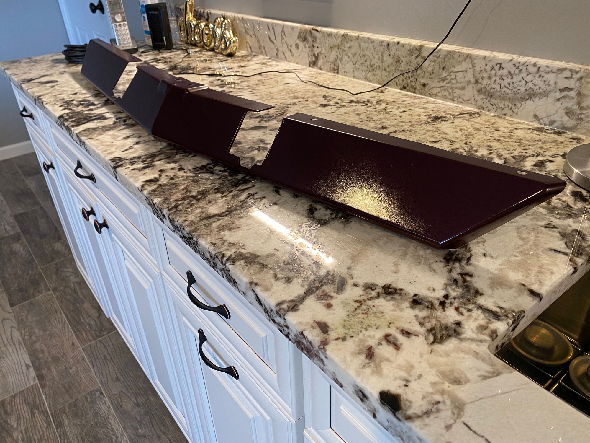

I'm going with the angle that I am dealt with....Using Tom Austin's plan.......I might add two rivets underneath in the middle epoxy area on the bottom flange........

YEARONE....Per Tom Austin's PM to me.....
part # ru1913 for $29.93

Using the YearOne Spoiler from '69 Camaro, did you use the 3 Rods for Support also....? Where Did they attach to ...?

Sam,
I'm still getting mine fitted with the bumpers. You may not have that issue with your GS. But once the fitment is correct for my liking, I will attempt to utilize (2) of the mounting holes to hide (2) Adjustable Carbon fiber jacketed stainless supports left over from my LG full front splitter on my C6Z. That's the plan, anyway! My support Rods are on Back order from YearOne...

Thank Tom Austin!!! Great Advice!

That turned out great. Thanks for the in process pics. Looks like it could have been on there from the factory.
