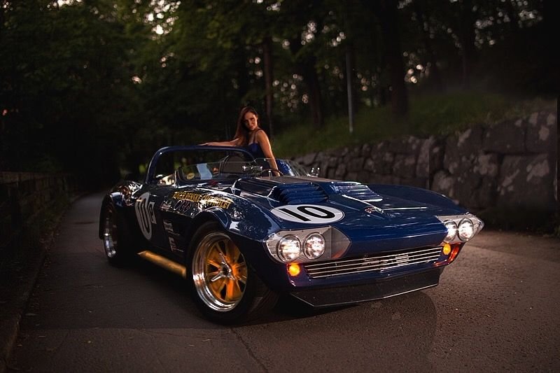

Dynamic corvette sells two different size front spoilers for a c2 . I have bought and installed two. They fit great

They have two sizes. This is the largest. One is 3/4 inch smaller

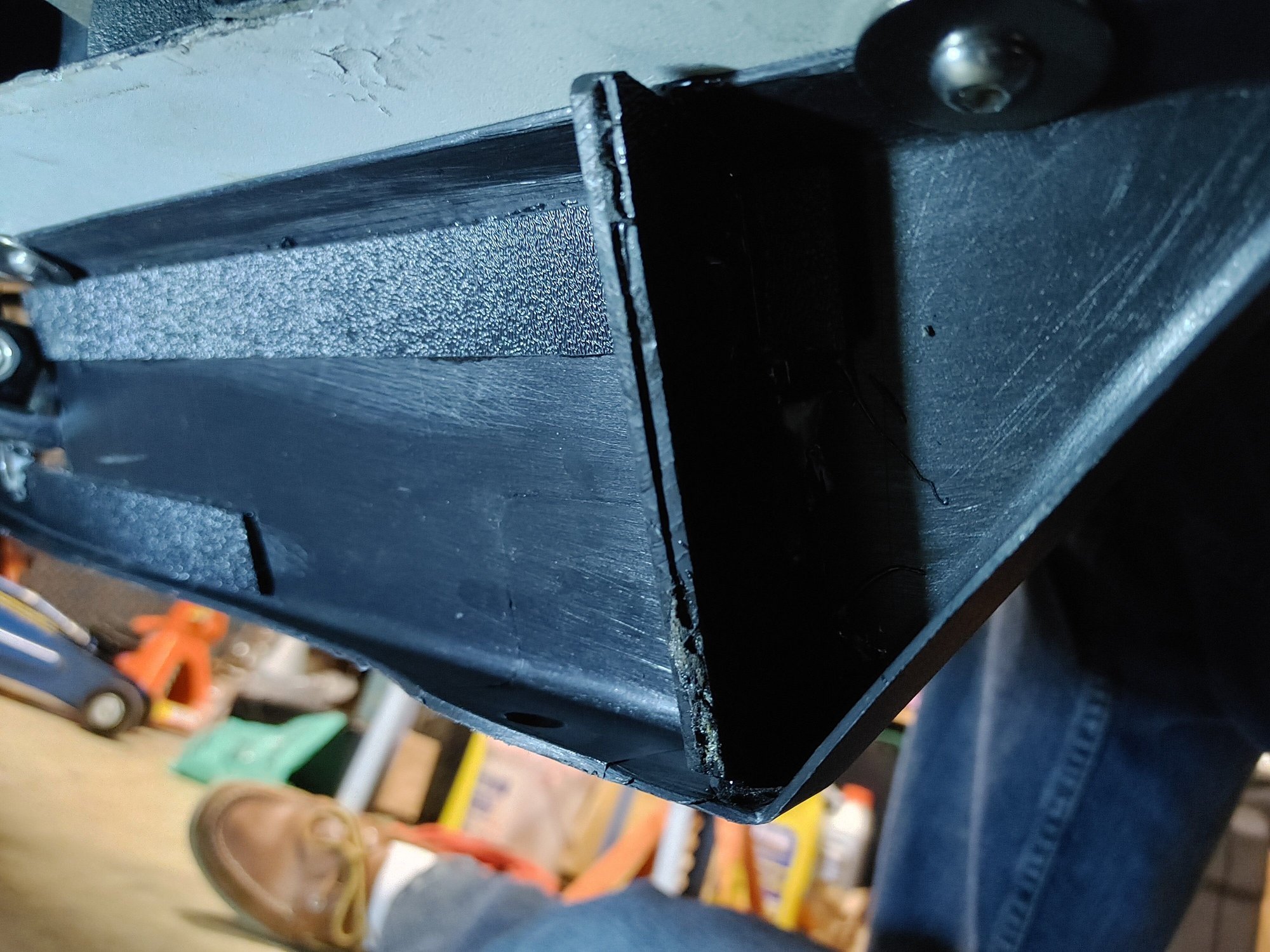

Originally Posted by Tom Austin
Tom, How many braces did you use? And approx. how far back toward the front of the valance were the position of your bolt holes? 1", 2"???

Spoiler comes with four nuts and bolts to install . Clamp in position, drill four holes and install fasteners . I don’t have front bumpers installed 🥴
Hi Doug,
Pasted below is a pic of the back side of the passenger side outside edge . . . you can see that I added a strip of abs to the top and bottom of the spoiler to help stiffen it up - and I also added a vertical piece (two thin 1/8 inches gluded together) on both ends. The spoiler is actually shaped in a shallow "V", so it's not perfectly flat . . . the outside edges are 1.25 inches forward of the lower body, and the middle 2 bolts are 4 inches forward of the body. Please let me know if you need anything else - glad to help!!!

Originally Posted by Joe Inama
Thanks, Joe, this is exactly what I am looking for! You even have the same hood and painted the same color. Any other pictures of this beauty?
