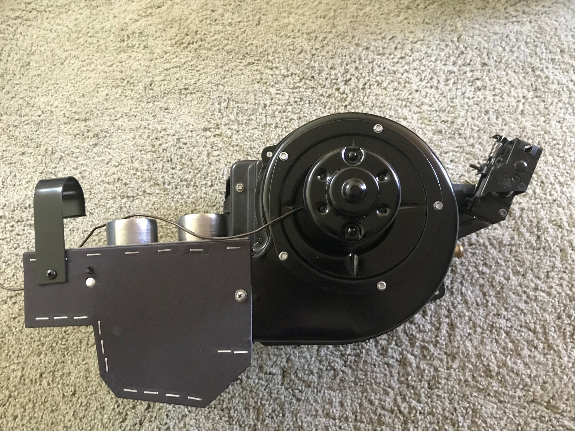

Here is some info from when I replaced the heater core on our '60.
Hope this is of some use.
Dave Z

Dave Z, such an excellent presentation! You must be a professional photographer! If there is a way it should be posted permanently on here.

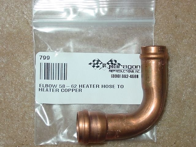

Where did you get the elbows? Can't quite make out the info on the picture (old eyes) I guess.

At the time I did that work that elbow came from Paragon; their part #799. Looks like it is still available.
From their website:
Good luck with the project!
