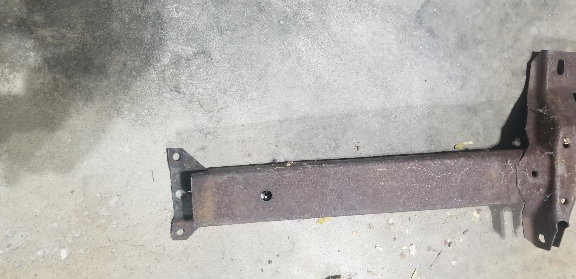

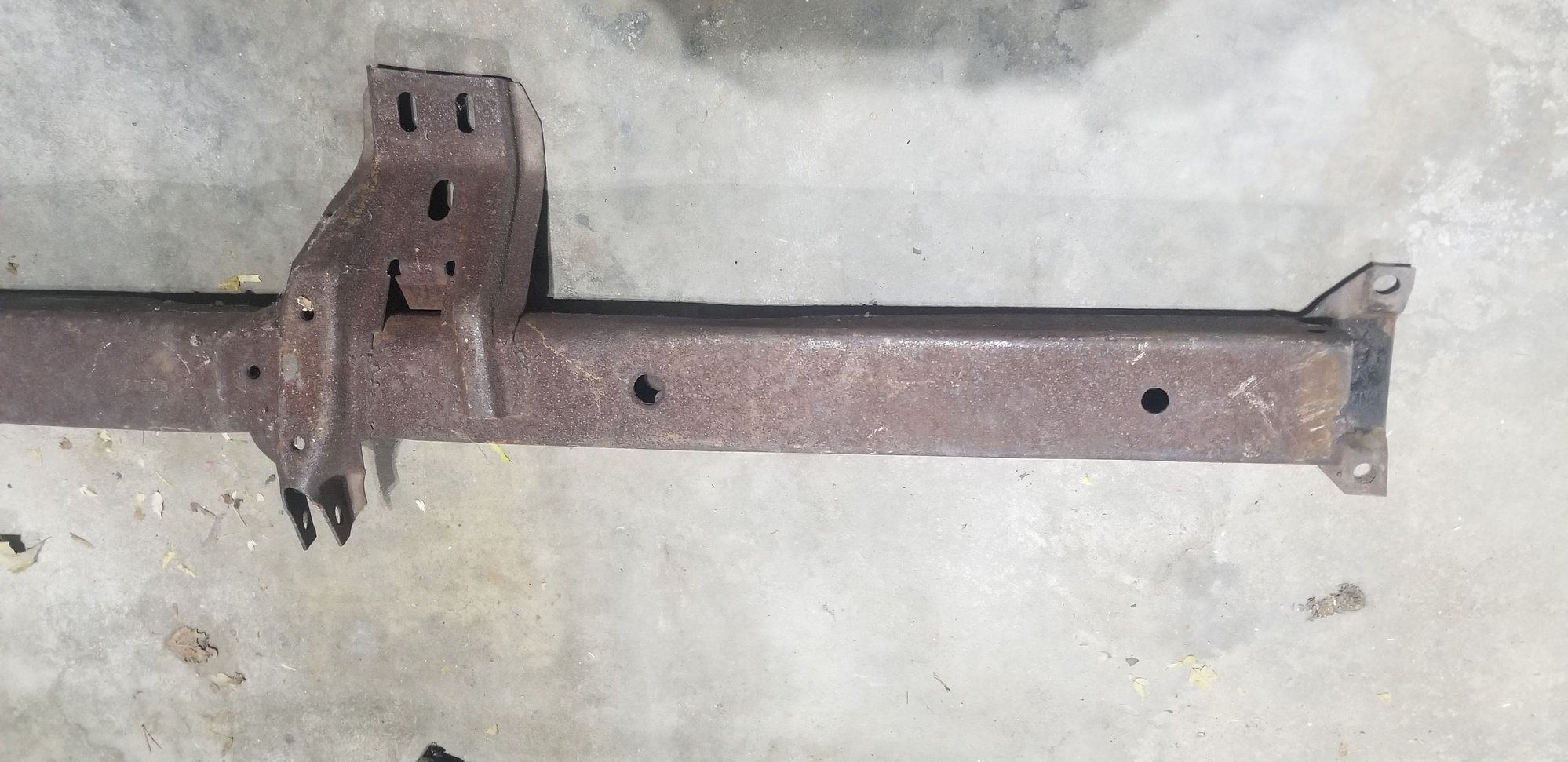

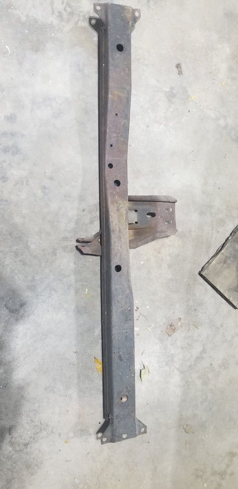

I got one for anyone who wants it $75 plus shipping
