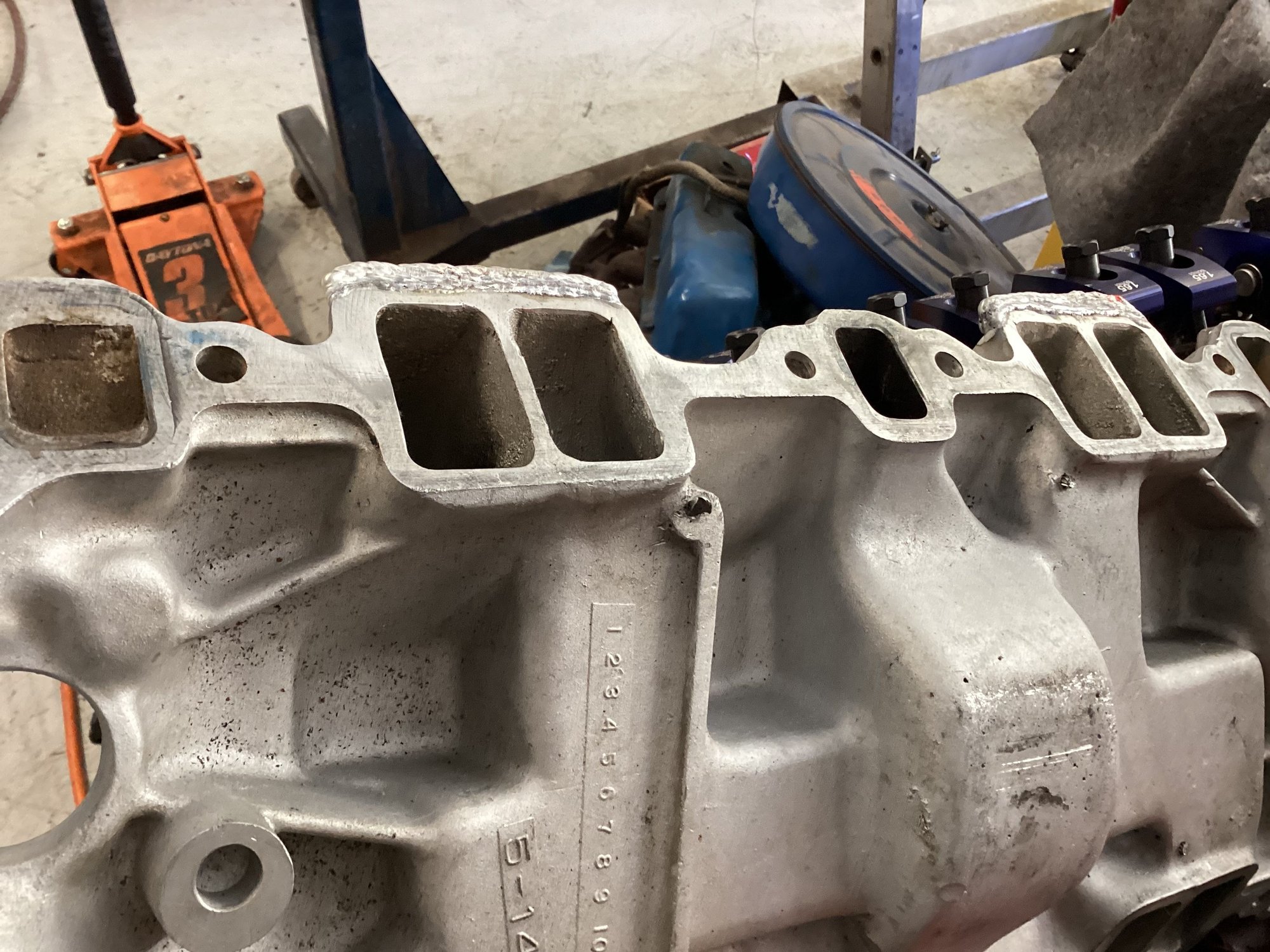

Thanks everyone for the suggestions. I decided to weld up the 1965 original 461 intake for port matching the intake to Brodix heads the best we can. This will give me the factory 365 h.p. engine look I want without any hood clearance problems. I hope to have this engine running in the car in the next two weeks. Of course I have project creep, you know “as long as it’s out” trans synchros, new clutch, pressure plate, trans insulation, etc.

Here are a few pictures. As you can see there are parts scattered all over. The intake has been welded but needs to be dressed.

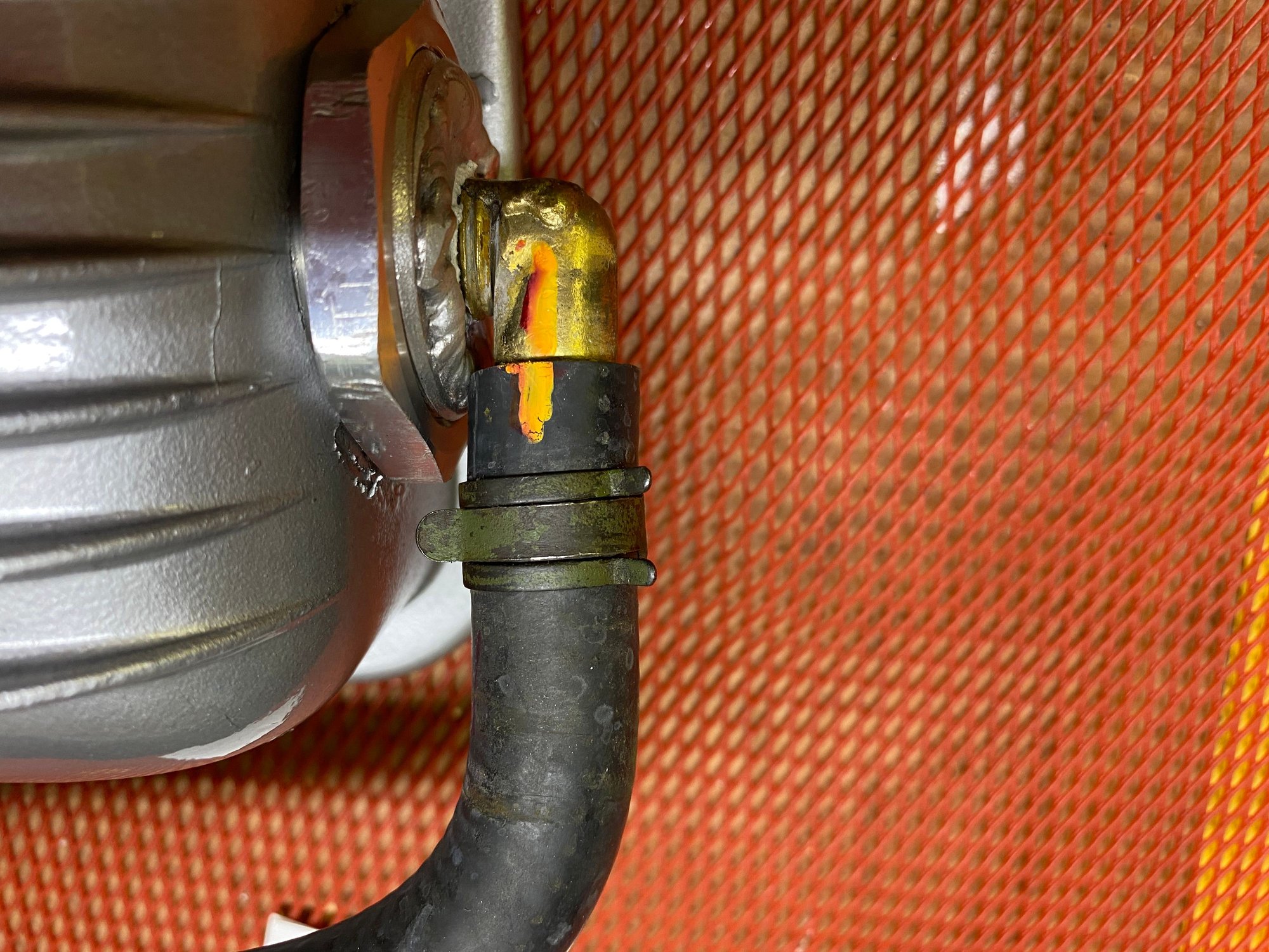

May wanna consider this approach. Took me a while to figger it out but it seems to be ok.
Had to modify some of the pieces shown and still I have only 1/8-3/16” clearance between the hose and firewall, but this a 57 Chev 2dr sedan. You would have more real estate, hopefully. Good luk
Yes this is what I will be doing on my engine on the suction side. Since it is the suction side I don’t expect I will need a baffle inside the valve cover. Does everyone agree with that?

I felt if I were pulling a vacuum inside the valve cover then it would pull oil mist into the hose and deposit it in the PCV. The fitting inside my valve cover is an oil baffle and I added a “disc” of a Scotchbrite pad inside the baffle to further break in any oil that could possible be “ inhaled” by the vacuum.
W/O a baffle it will suck in oil when running, I feel.
