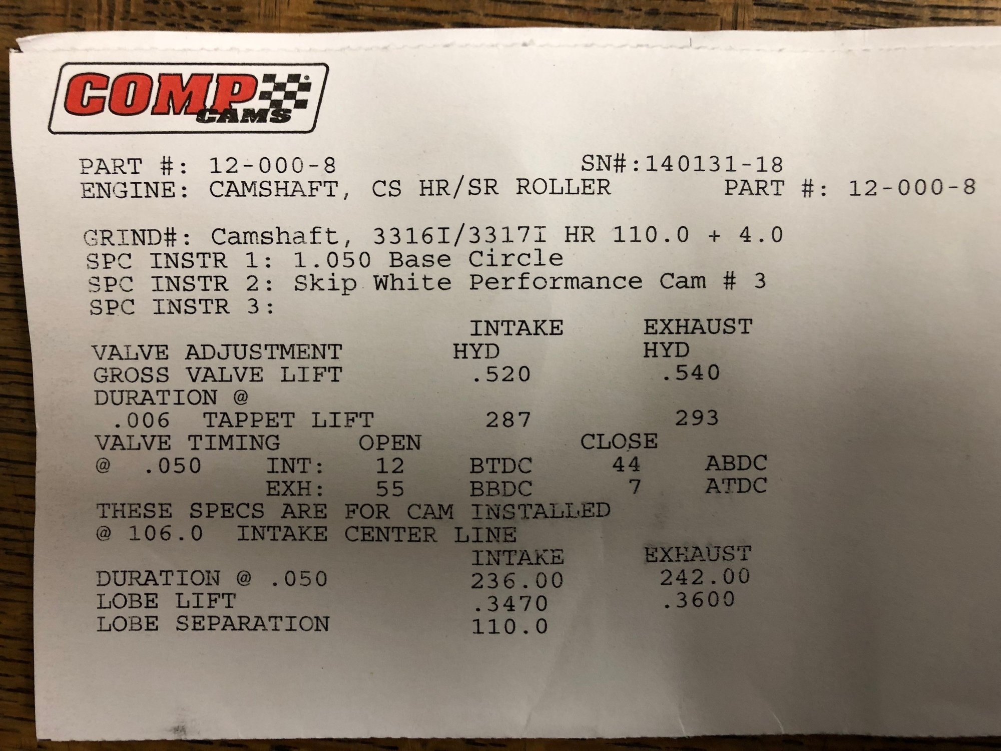

I just got the cam specs and it looks like I will be doing the 1970 LT1 cam as this one looks to be too much.
.555 lift x 1.65 rockers= .610
260 duration exhaust and intake @ 050 lift
110 lobe separation
The guy I bought this from had it in a 1976 Corvette with a dual quad tunnel ram. He only ran it a couple of 1/4 mile runs and turned and 11.40s but figured with tweaking it would go high 10s. Since it had been run even just a few times I had my mechanic take it apart to make sure nothing was hurt before I committed to it and it checked out perfect.

Yeah, that's too much cam. You'll be much happier with the LT1 cam. Nice find on that motor. Dressing it up like a stocker is perfect!
110 lobe separation
Your 'rithmetic is wrong. .555 x 1.65 = .916 valve lift
I highly doubt you've got that much lift.
I guess I SHOULD have written .555 lift WITH 1.65 rockers.
That makes more sense.
If .555 is too much for you, replace those 1.65s with 1.5s. That will reduce lift at the valve to .505.
Did you look at the rest of the cam specs? I don’t think it is a very good cam for the street.

Darryl, great score on the engine!
That cam will be way too much for your intended purpose. In fact, you might want to also check the valve springs to ensure they are not too much for the new cam. When I built my GT40, I bought a similar race engine - 600hp out of a bored and stroked Ford 5.0L. I changed the cam and the valve spring seat pressure was over 100lbs greater than required by the new cam. When I replaced the springs, I had to weld an extension bar (piece of old steering shaft) onto my valve spring compressor tool to have enough leverage to actually compress the springs and remove the keepers.
