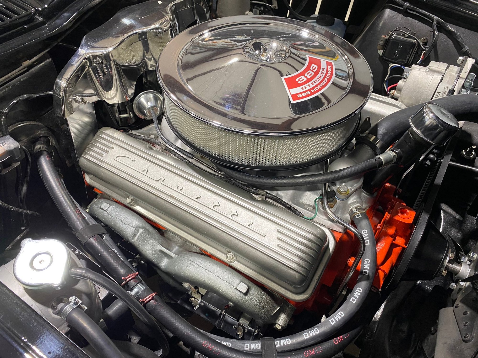

Originally Posted by My71
Here’s my 383 stroker. Intake is an eldebrock C3BX. No clearance issues and no holes in valve covers. I’ll admit to not being an expert so I don’t understand why some do that. As you can see the PVC vents to the oil intake tube so maybe that’s why? Good luck on your build
From the looks of your engine and the fact that you don’t have a draft tube hole in the back of the block it looks like both your suction side and discharge side are the same assuming the hose coming off of the oil fill tube is going either to the carb or into the intake manifold. I really doubt that your pcv system is operation properly but I would like to hear from other more qualified members on this subject.
