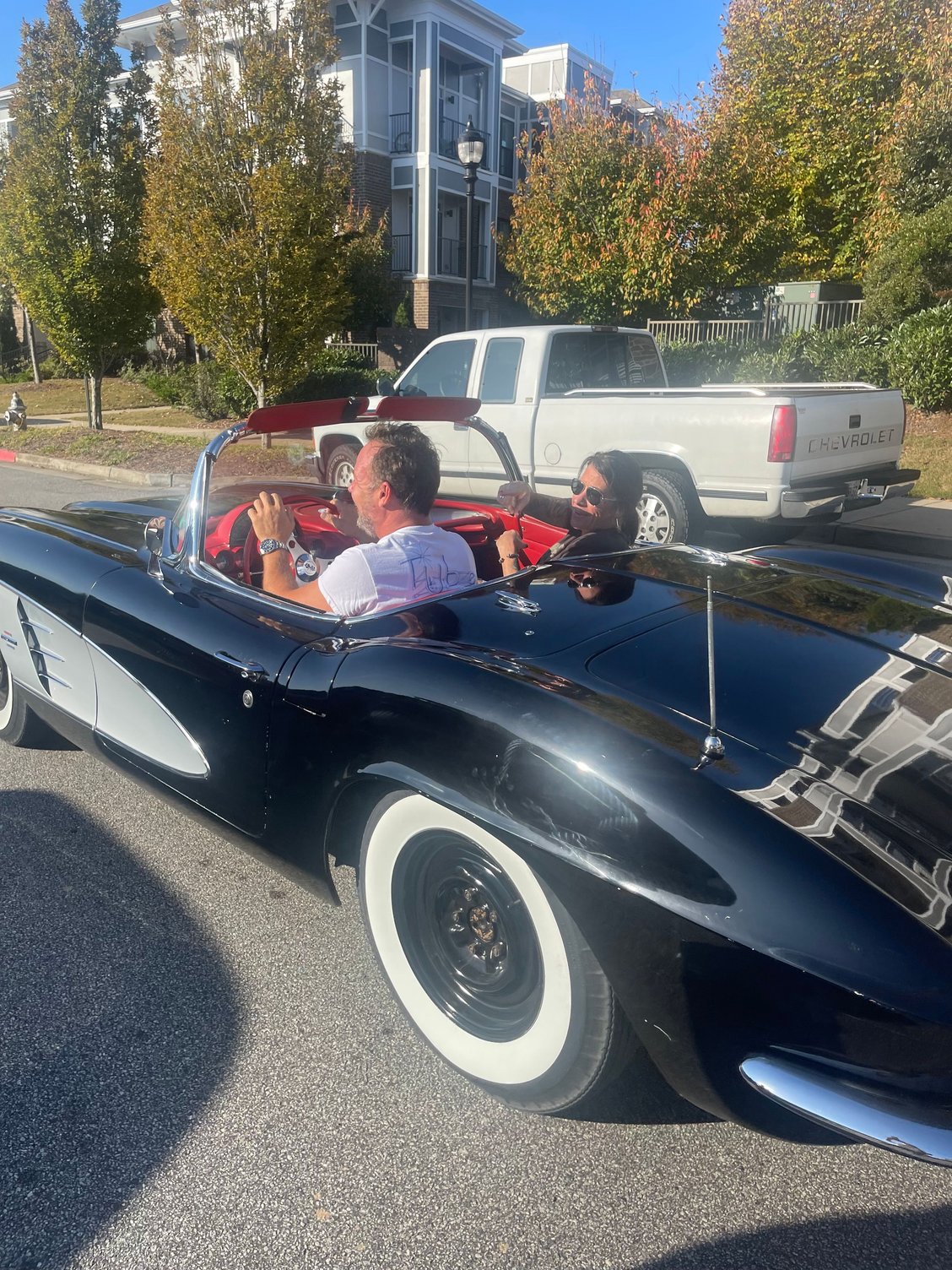

I would absolutely NOT hesitate to tackle this job again—but now—on to the next project—— I have to install a new Gps in my boat which means some pulling of new wire and rewiring things——not looking forward to this. ——I’ll take a C1 windshield any time!
Again—thanks to all of you for your encouragement and advice.
Now, my gal and I goin for a RIIIIIDE!!!!!
Stay safe! Stay well!
Eddie
