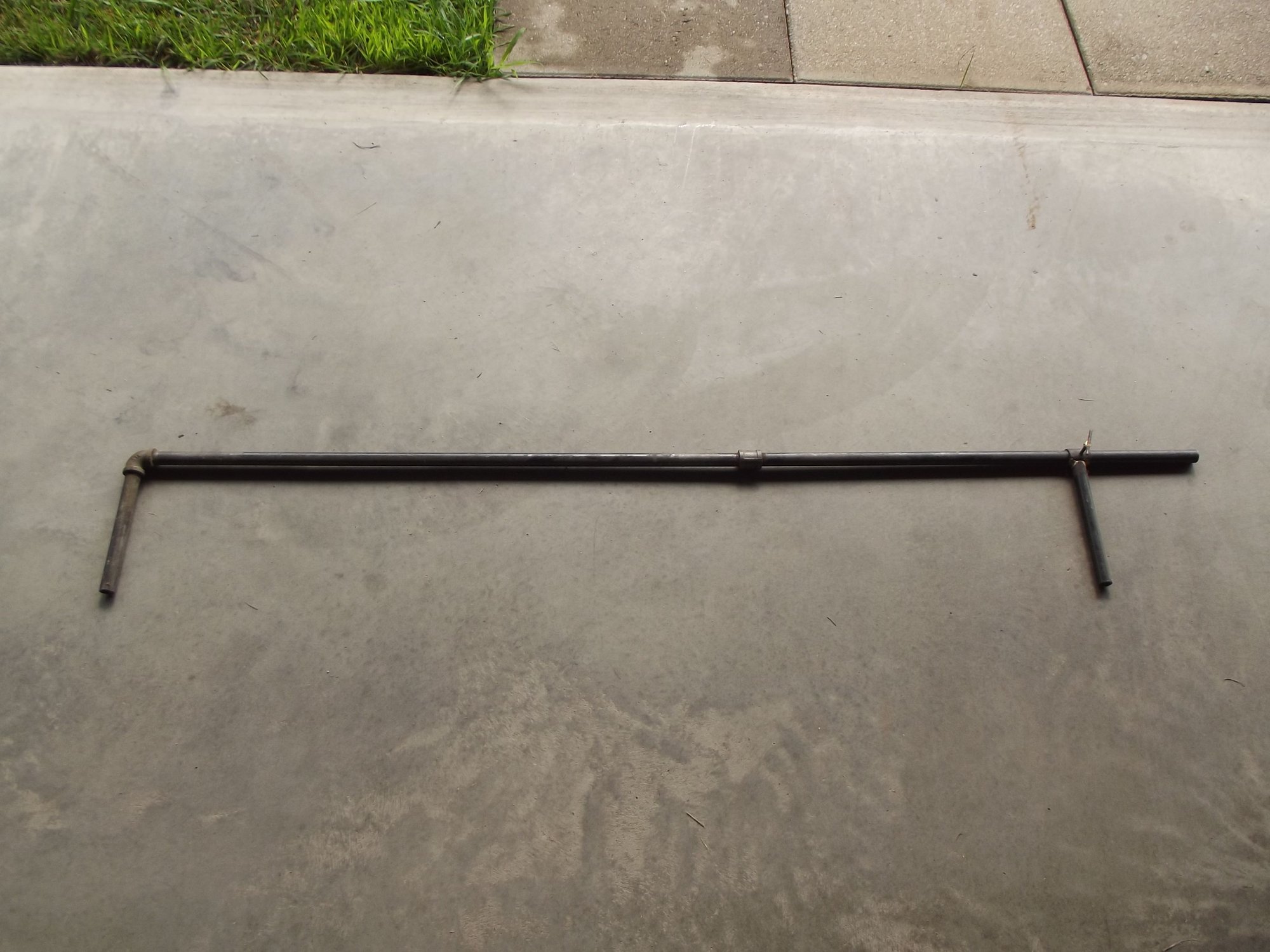

Old Aug 5, 2024 | 10:17 AM
JF in MI's Avatar
JF in MI
Pro Mechanic
Joined: Jun 2017
Posts: 2,267
Likes: 1,769
From: Central Michigan
2023 C1 of the Year Finalist - Modified
>What I meant to say was you could probably do the rear at home but get a shop to set the front<
It is actually cheap and easy to make your own alignment equipment for the rear at home. A bubble level will work fine for the rear camber and the pictures are of a simple toe gauge I slapped together for a few bucks worth of Home Depot black pipe. The key (and most important part) of both is a "slip plate" for the tire to sit on while the weight of the car settles everything. This is also not too hard. You can get a sheet (say 2 x 2 feet) of 1/8" Lexan or polycarbonate, at the building supply, cut it in half, put plenty of grease between the two halves and rest the tire on top of it during alignment. Once sitting on this "sandwich" one good bounce should settle the suspension nicely to take measurements.
Toe gauge. Just rest the long section on the level floor and tilt the ends up to the same height when measuring the front of the tire to compare to the rear.

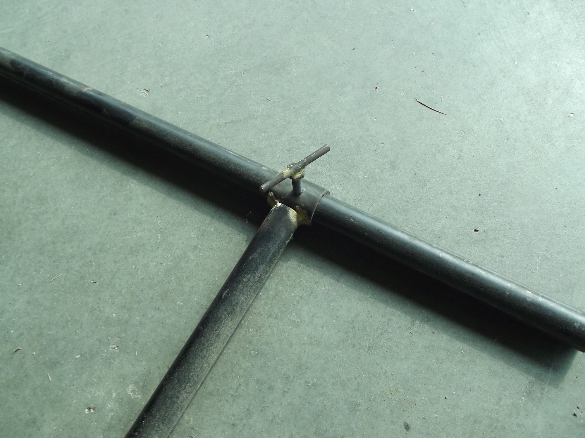

Close up of the adjustable end.
