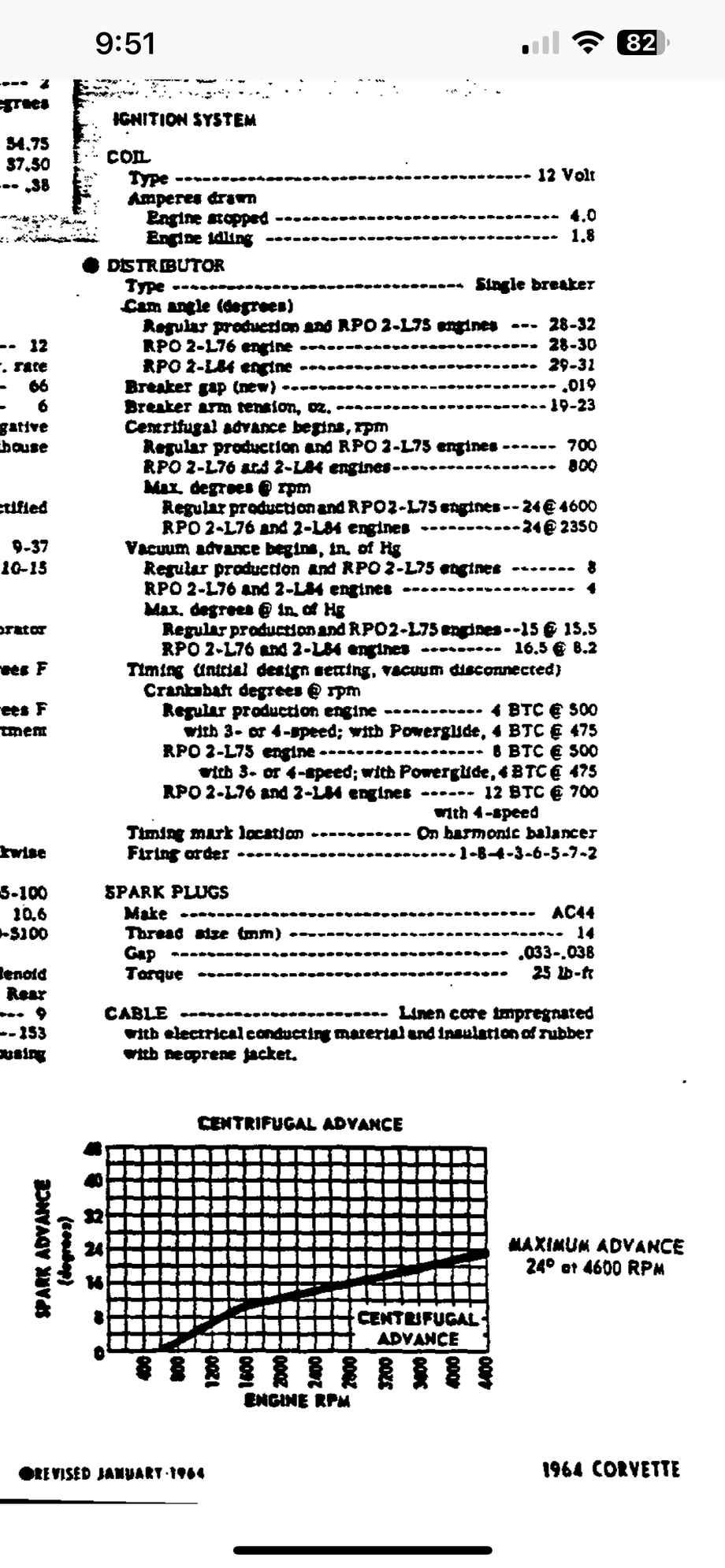

This from GM Heritage will have the basics. But not stampings on specific parts…
