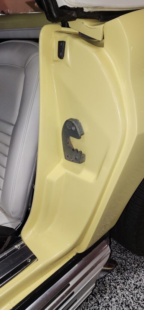

The tag is bogus though.
how can you tell from a photo? Cleanliness?

plenty of clues beside it looks like it was made yesterday. do you have any pictures of the door jams
I didn’t take any door jam pictures. I do remember the jams being nice and couldn’t see any overspray on the mechanical latches. The floor plates were scratched but that’s pretty normal. I let the owner know that if he couldn’t get me in touch with the previous owner, I’m going to pass on the car. I am looking for details on what was done during the restoration and he couldn’t really provide it.

The reason for the door jam picture was to see if it has the St. Louis body clue or if it was an A O smith body to start with.

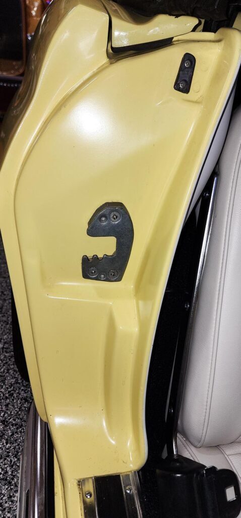

There were in the ad. Not dure if it helps answer your question or not.

No I need the other end of the door jam in the area between the door hinges

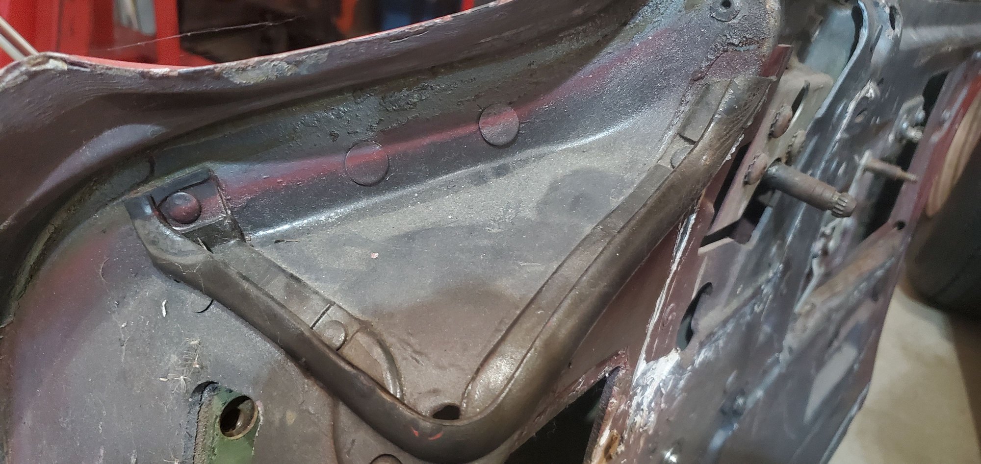

The AOS car would have bigger rivets holding the guts of the door together.
I couldn’t find any pictures and from this picture, I’m not sure what I would ask for a picture of. Assuming it’s the hinge area of the door?
So what are you looking for there?
From a related thread:
"The St. Louis bodies also have a dimple between the door hinges where the conduit for power windows would go. Also I think that different rivets were used inside the doors, inside the upper weather stripping. St. Louis used regular rivets and AO Smith used a flat rivet."
Does this picture help?
does this picture help?
