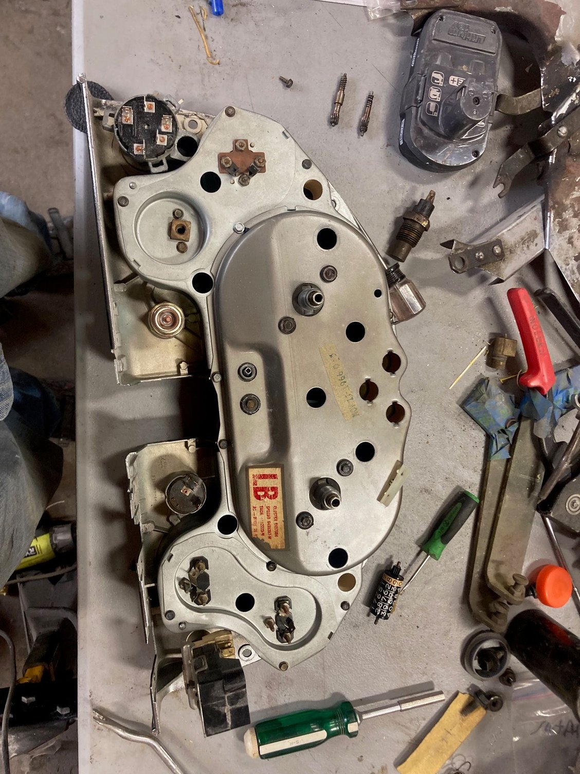

"LB" sticker on back of cluster

A "LB" Original sticker on the rear of the cluster with a date corresponding to the car's build date is very difficult to duplicate. BUT will take a camara and body positioning to capture. BUT anything can be duplicated!

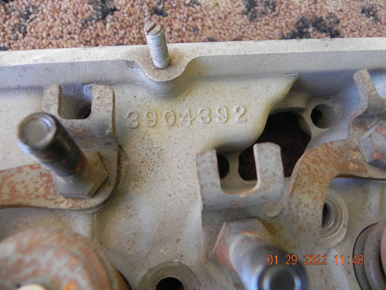

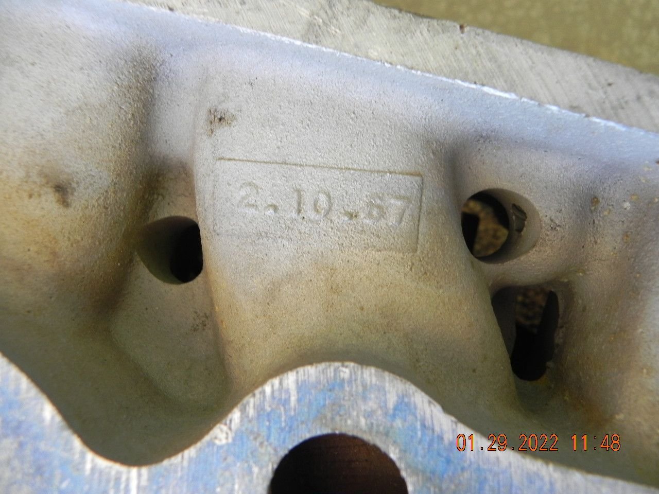

Ken - has the seller provided any pics you can share? Maybe some of the block and head castings and date codes? Are you only questioning whether this is a factory L89
or asking whether this 67 actually started out as a factory high horse L71? Since this, I believe, is a running/driving car, a quick way to determine it's an L71 4-bolt block is
to put your camera down alongside the engine at the drivers side rear, just above the oil filter pad. Four bolt blocks had a large oil passage that could have been
used for an oil cooler and it's noticeably different from a 2-bolt block. Next time you see this 67, reach down to take that pic and post it.
My 66 L72 lost it's original 4-bolt 427 a long time ago and is currently running a 396. About a year ago, I bought some parts from a local friend here in Prescott and
in that stash of bigblock parts were a set of 1967 L88/L89 Aluminum Cylinder Heads. The head casting number is visible with the valve cover removed but the date
code is on the underside and would require more parts removals. Pic attached is of my 67 L88/L89 head casting number and date code.

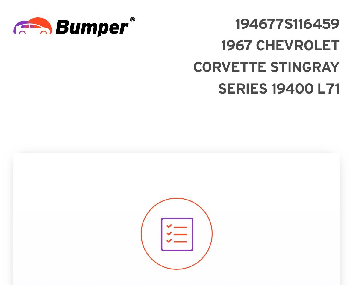

I ran the VIN on Wednesday on Bumper.com. The listing came back “1967 Chevrolet Corvette Singtay Series 19400 L71.”

Just ran my '67 L79 through Bumper.com...here's the results...look familiar?? Bogus information.
1967 Chevrolet Corvette Stingray Series 19400 L71
