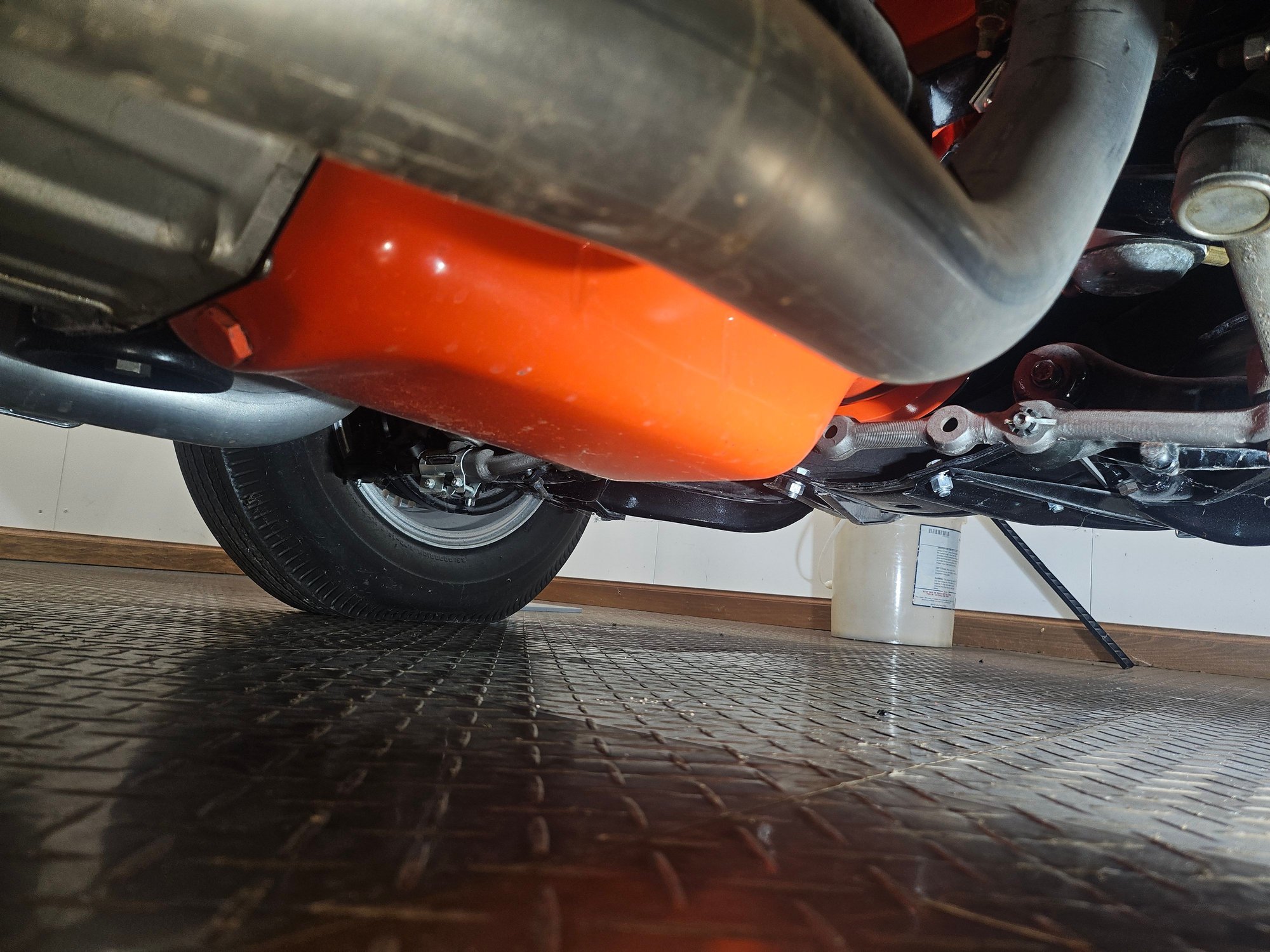

It almost looks like the oil pan is larger on the front part of the sump.

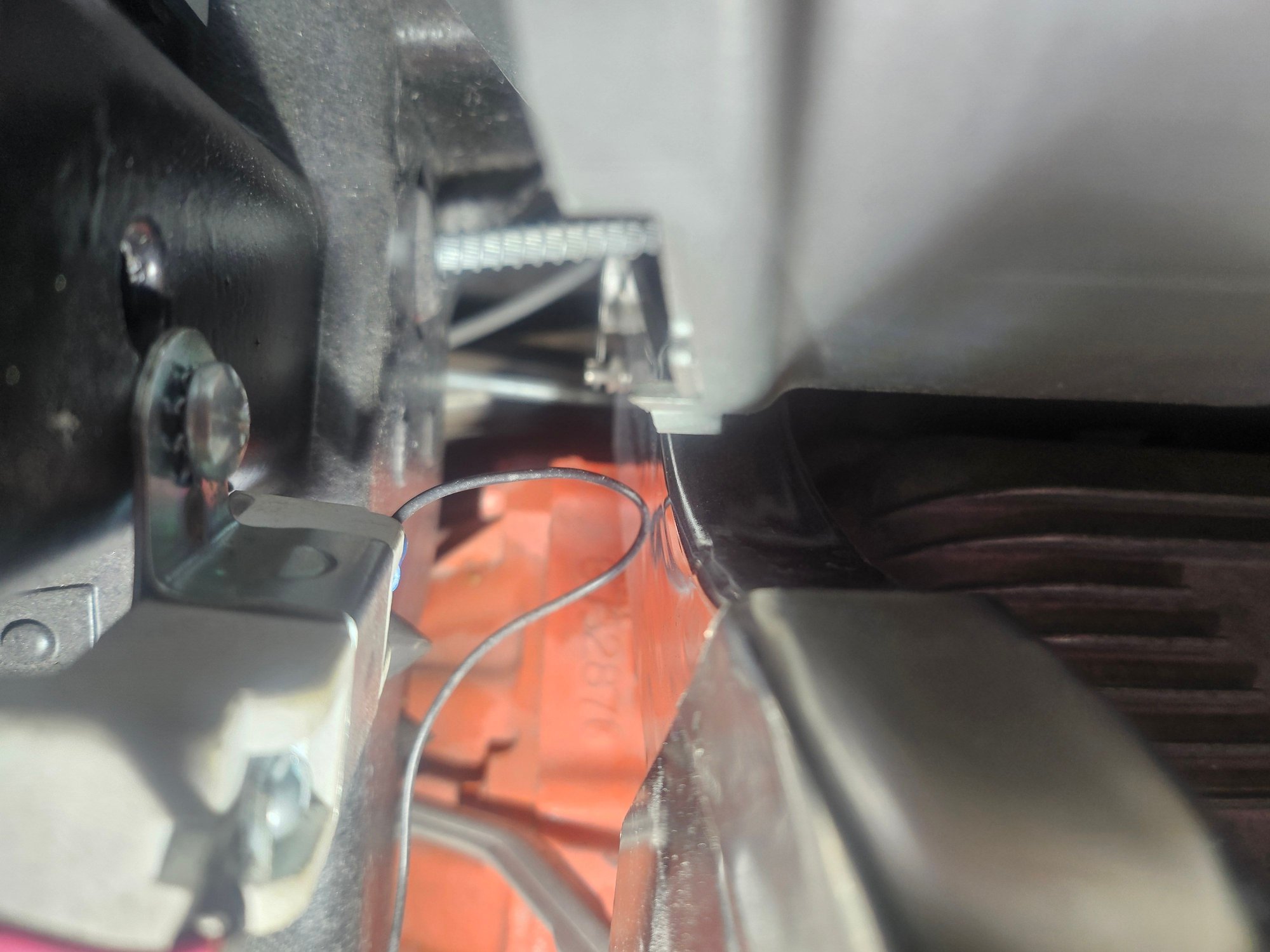

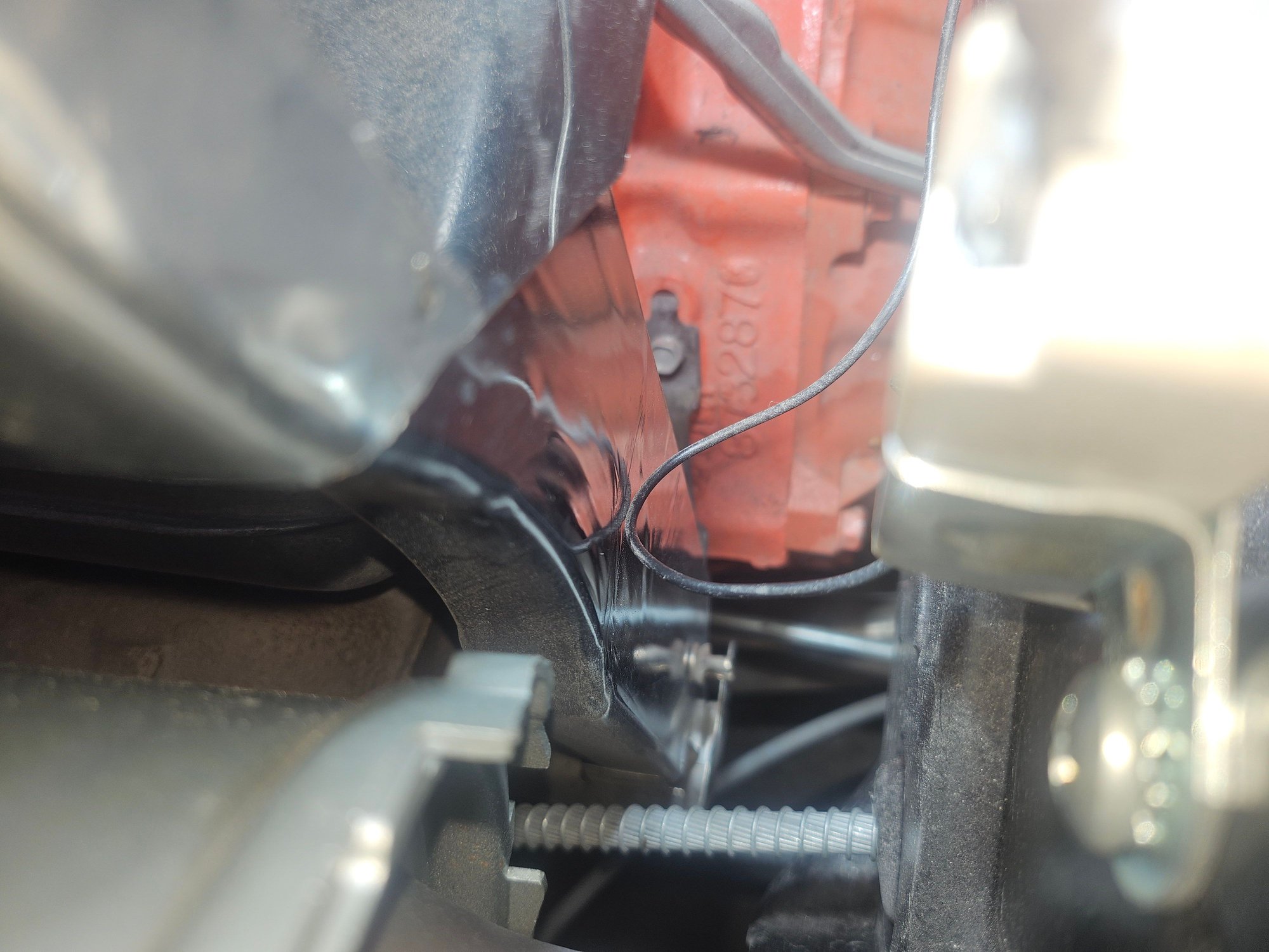

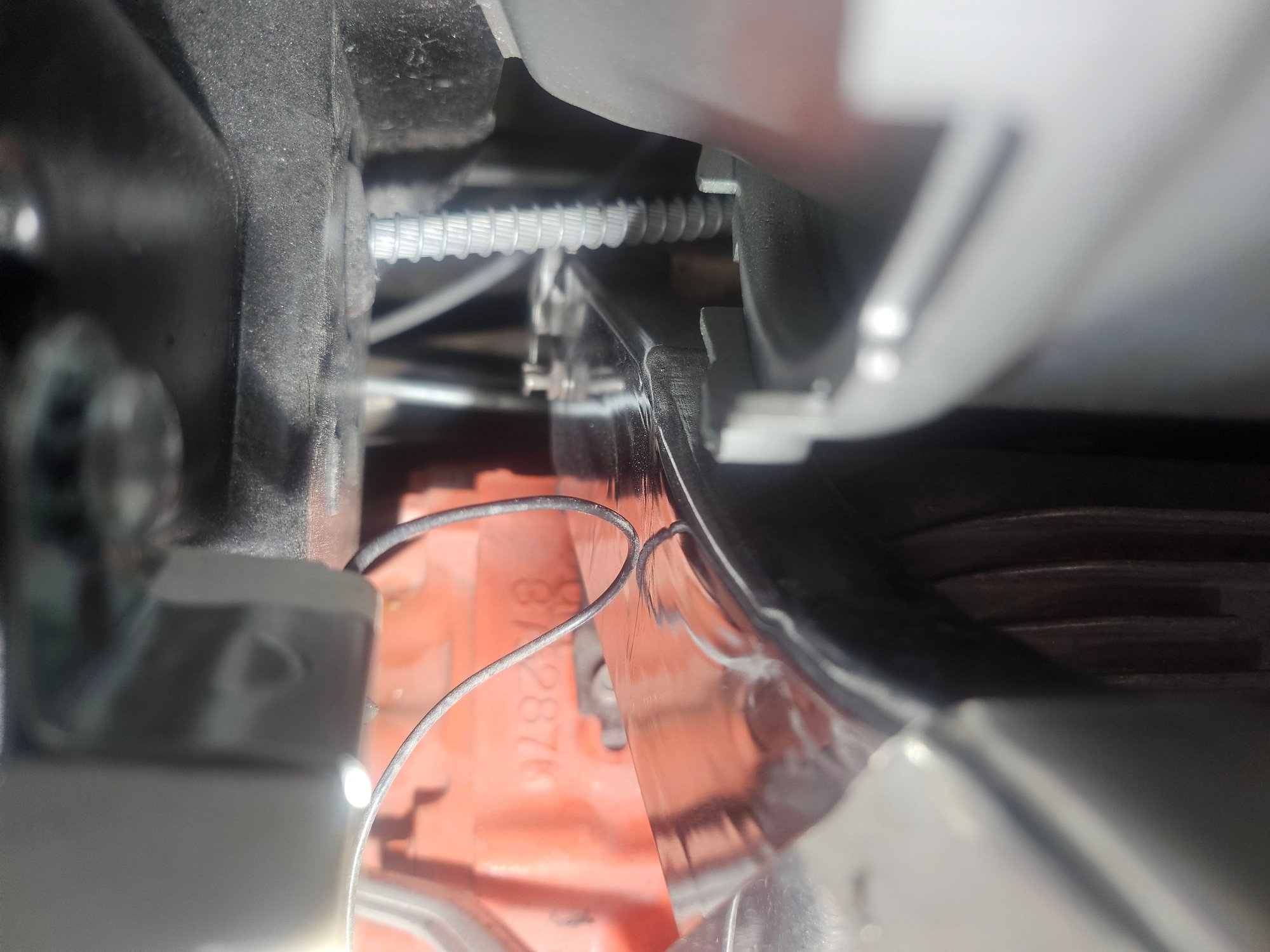

Lol! Looked at wrong side. Found this number 373287 I think
To 63 wrong engine
Old Feb 9, 2025 | 05:15 PM
  #38
63driver's Avatar
63driver
Joined: Apr 2006
Posts: 1,301
Likes: 342
From: New Hampshire
A 63 block is 3782870
