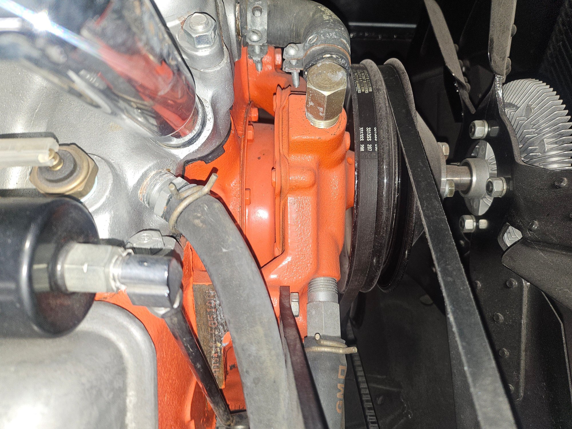

We need a picture of the engine stamp pad.

Can you get a close up picture of those numbers.

I messed up and parked it under another car. Can't get the hood high enough to latch and take good pictures
and weather is to bad to put in a different bay.
