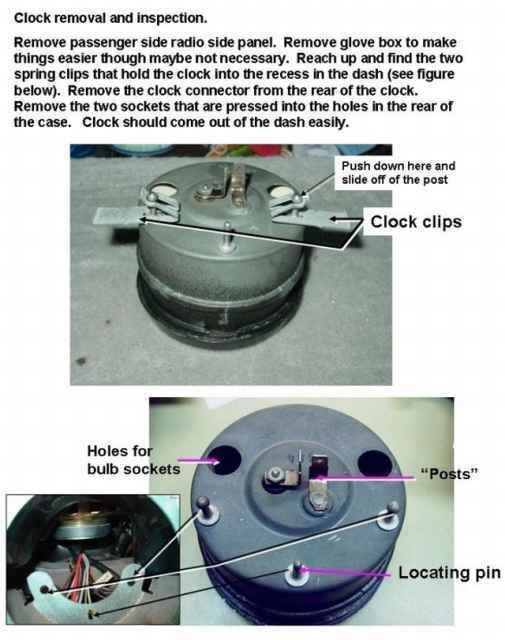

Here ya go:

piece of cake, clock is out. now to send it out for repair. thanks again
