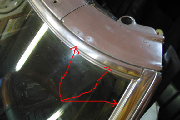

Default the part red arrows point to
How do these strips come off
Old Dec 4, 2005 | 12:15 PM
sly vette's Avatar
sly vette
Joined: Oct 2005
Posts: 3,570
From: Algonac Michigan
As the old Maidenform bra ad used to say "Lift and seperate" but carefully.
Old Dec 4, 2005 | 02:07 PM
ratflinger's Avatar
ratflinger
NCM Grand Opening Veteran
Joined: Sep 2005
Posts: 20,979
Likes: 384
From: South of giving a damn
St. Jude Donor '11, '17
Side pieces are screwed on, screws may be under weatherstripping. After removing the them, just pry the top on straight up. It has 2 clips on each end. It has been stated elsewhere that the top one should come off w/o removing the side strips. Remember where the side strips were located as this affects seal of the side window.

Default Trim
The top trim of my 73 is held on by clips along the top that are screwed into the header. The side trim pieces are 2 part (one over the other). Take them off first. You can peel the weatherstripping out of the track to get to the screws.... They should be well sealed and just pry slowly after all screws are out.
The heavy top chrome corners are held on in front as stated prior and I chipped the edge of my glass which eventually led to a large crack. If you can get the windshield out I think it is best. Is your windshield dated original? If not you may want to have a pro install a new one. Also are you taking the chrome out to get to some repairs of the "header" like I was (maybe leaking?)
Old Dec 5, 2005 | 11:52 AM
LemansBlue68's Avatar
LemansBlue68
Joined: May 2001
Posts: 2,131
From: May help you? You can sure as hell try!
Take the side trim pieces off first. These screw into the A pillars. The screws are concealed by the weather strip which can be pulled out from the channels that hold it in. It's also glued so be careful not to tear it.
The upper trim piece must be removed with a special tool. Go to one of your better auto parts stores and tell them you need a tool to hook the clips used to remove windshield molding. The tool is a thin piece of spring steel with a hook on the end. You drag the tool between the glass and the trim until you catch one of the clips. Then you pull out on the clip while prying up on the trim piece. The number of clips that you have to release varies by model year. My '68 had 5.
If you are removing any of the screws for the trim clips or the corner pieces be careful not to chip the edge of the windshield. I put a small chip in the edge of my windshield glass and didn't think anything of it. I came back out to the garage the next day and found a crack all the way down the windshield that started from where I put the knick in it.
