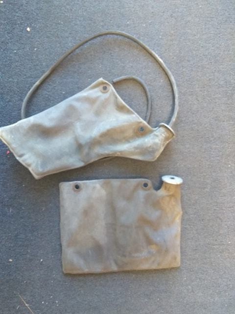

Well then, the A/C cars have a plastic bag with a cap that the fluid line runs into.
The bag hangs on a "hook" under the driver's side fender near the driver's hood latch.
The bag is roughly the size and shape of a hot water bottle.
Several vendors carry these.
Here's a photo of a used one.
Awesome thanks bud.
No wonder I can't see it, it virtually camouflages itself amongst an old black engine bay
