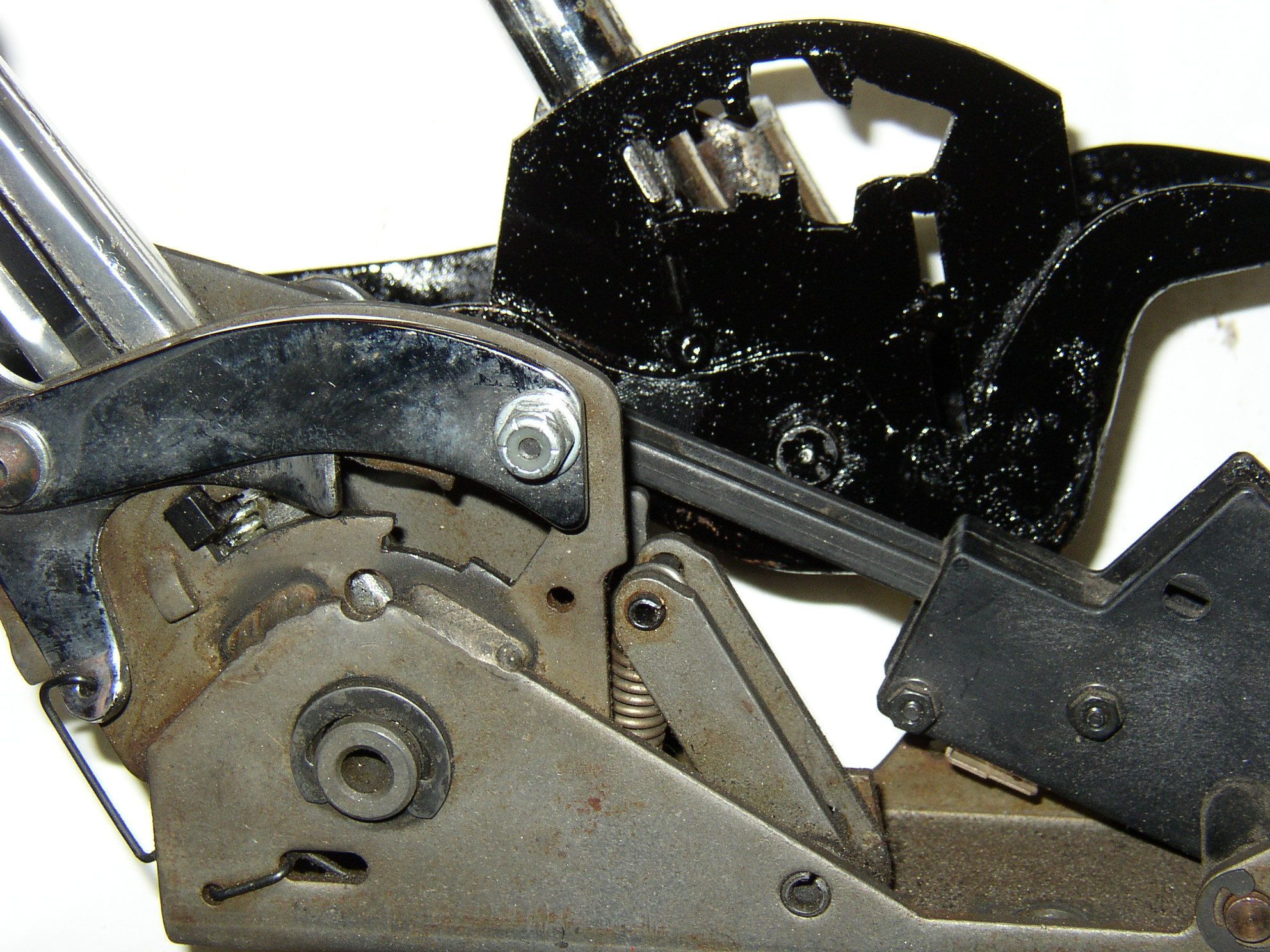

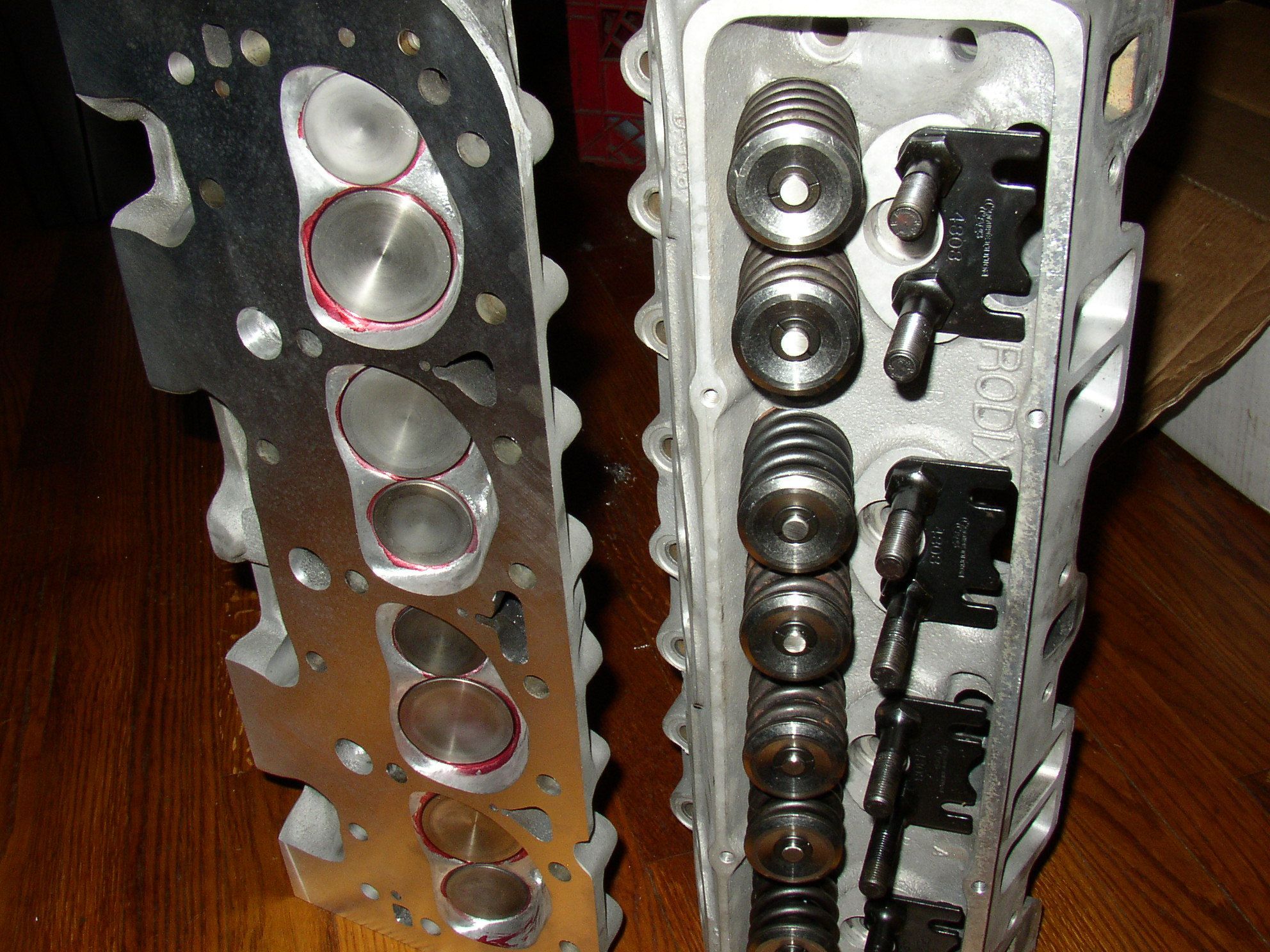

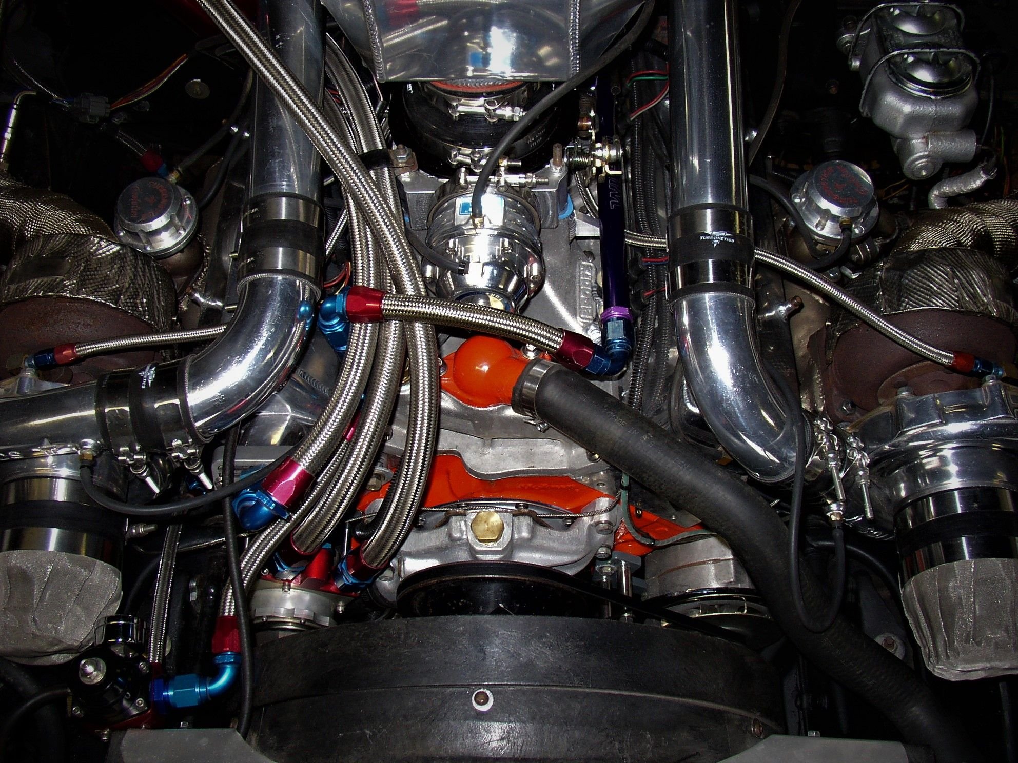

changed the cam and heads and put the TH400 back in
added a lower gate to the stock shifter to make it work like a quarter stick
also finished most of the hotside for the turbo

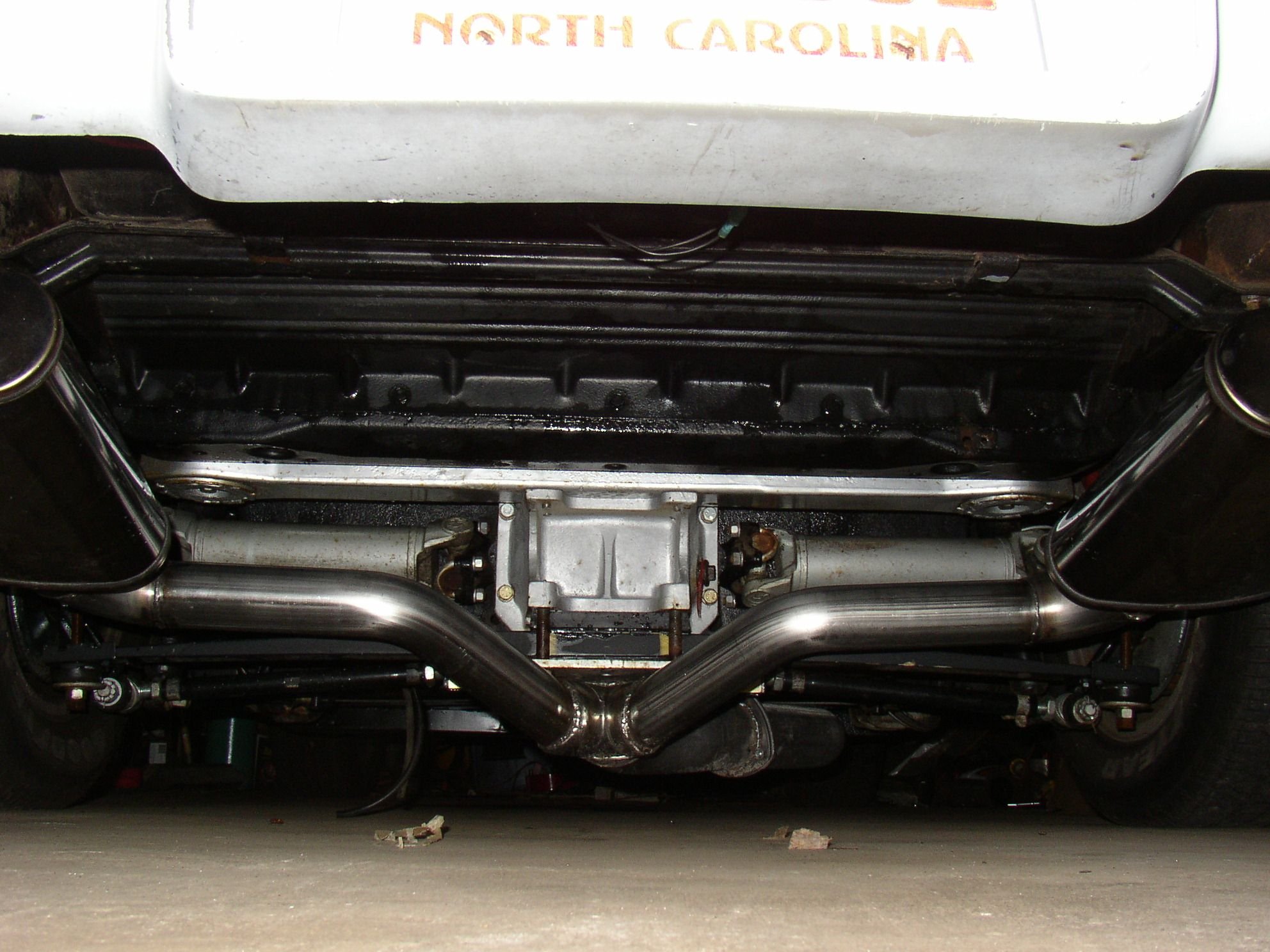

welded in some stainless pipes with magnaflow mufflers
also changed the fuel lines to make taking the bowls off easier, and a bigger air filter.
next installment will be the intercooler

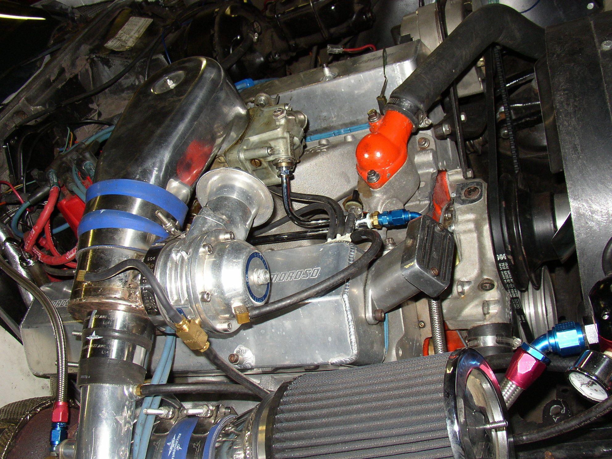

no intercooler for now. I'm happy with 11psi

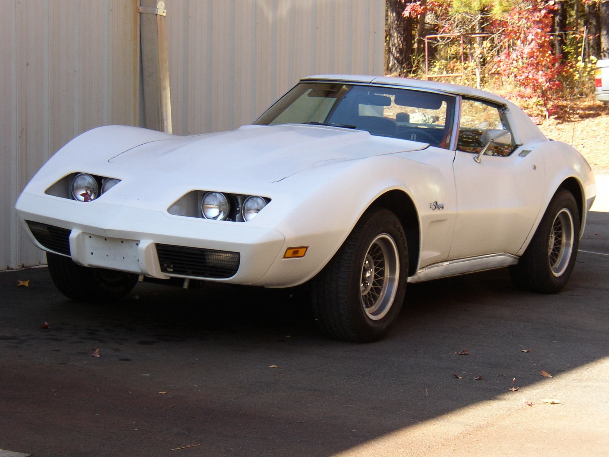

10 years and this car is still fun

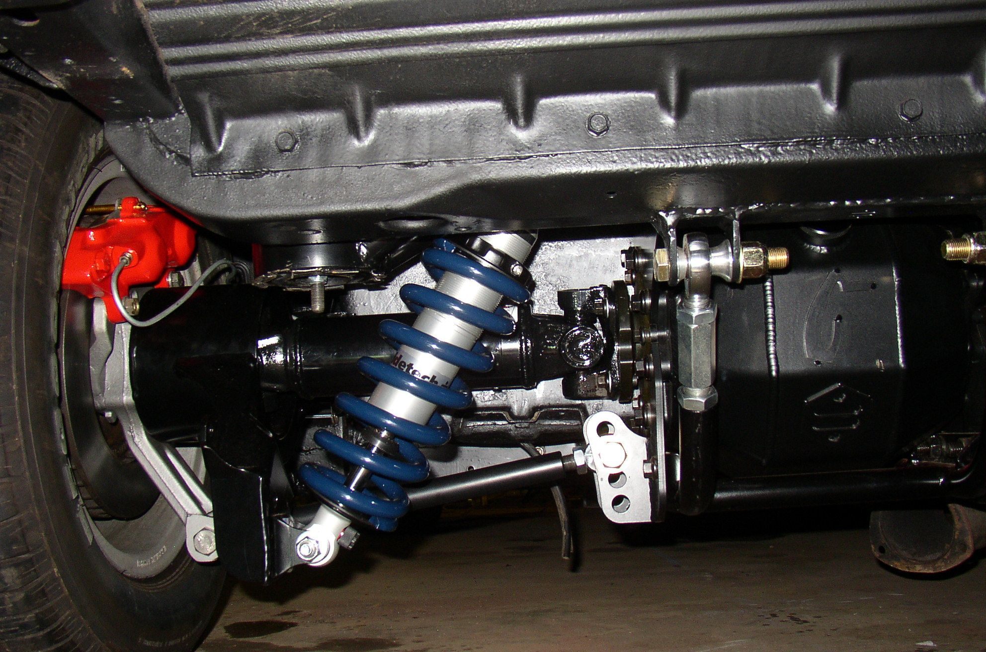

I deciced to pull the trigger on the Ridetech rear suspension. It's less invasive on the car than a backhalf and retains some of the cars personality.
I used 2:75 gears out of a Galaxie, A Yukon housing and Yukon posi. Ridetech was very helpful sorting out the snags, and I am happy with it so far.
Tom's 31 spline outers and Billet yokes

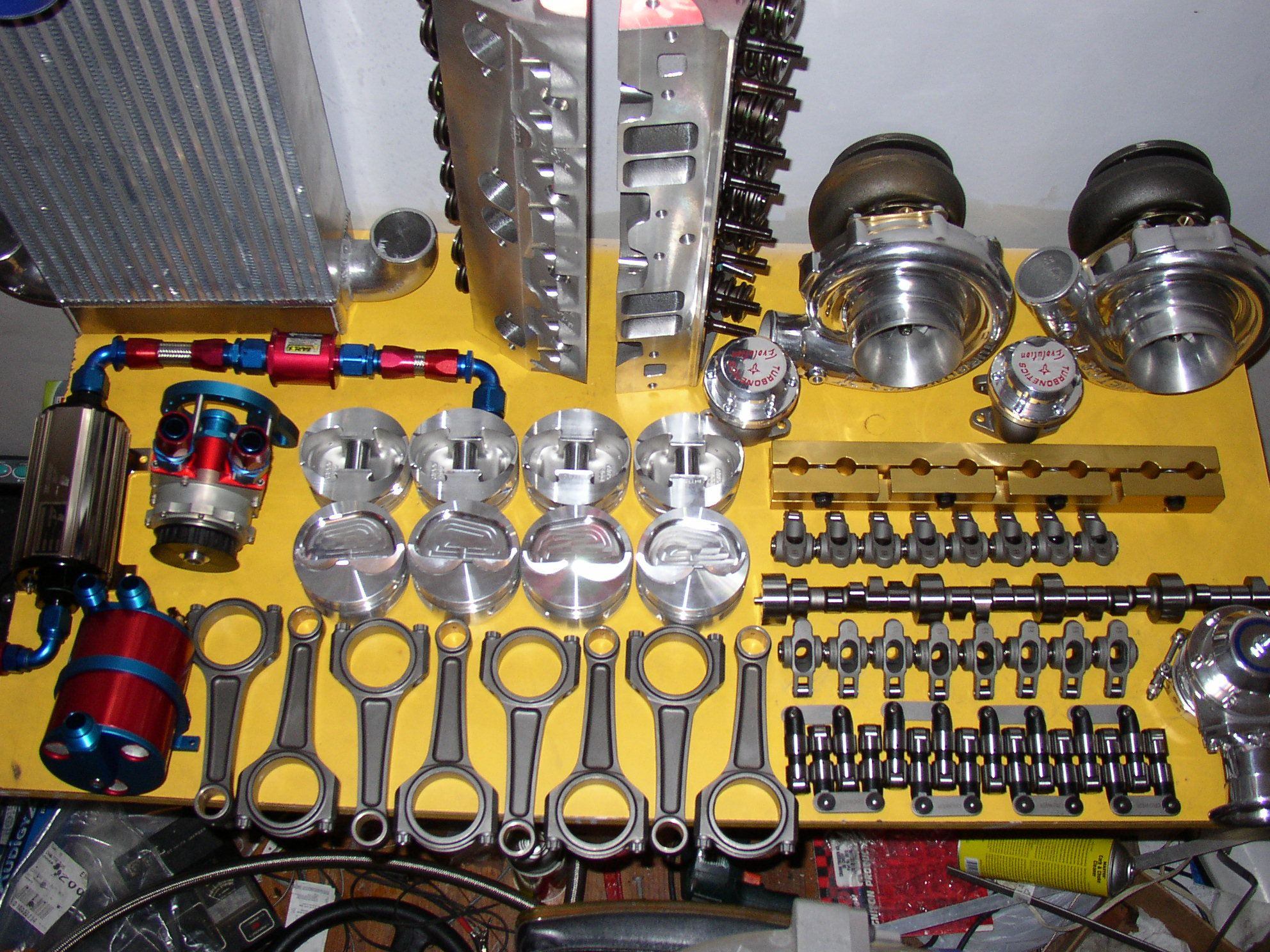

and now for something completely different, a SBC!!
I never thought a 350 would be a second choice for a hotrod, but the LS has pretty much taken over.
O well, I'll stick to what I know and have a horde of parts for.

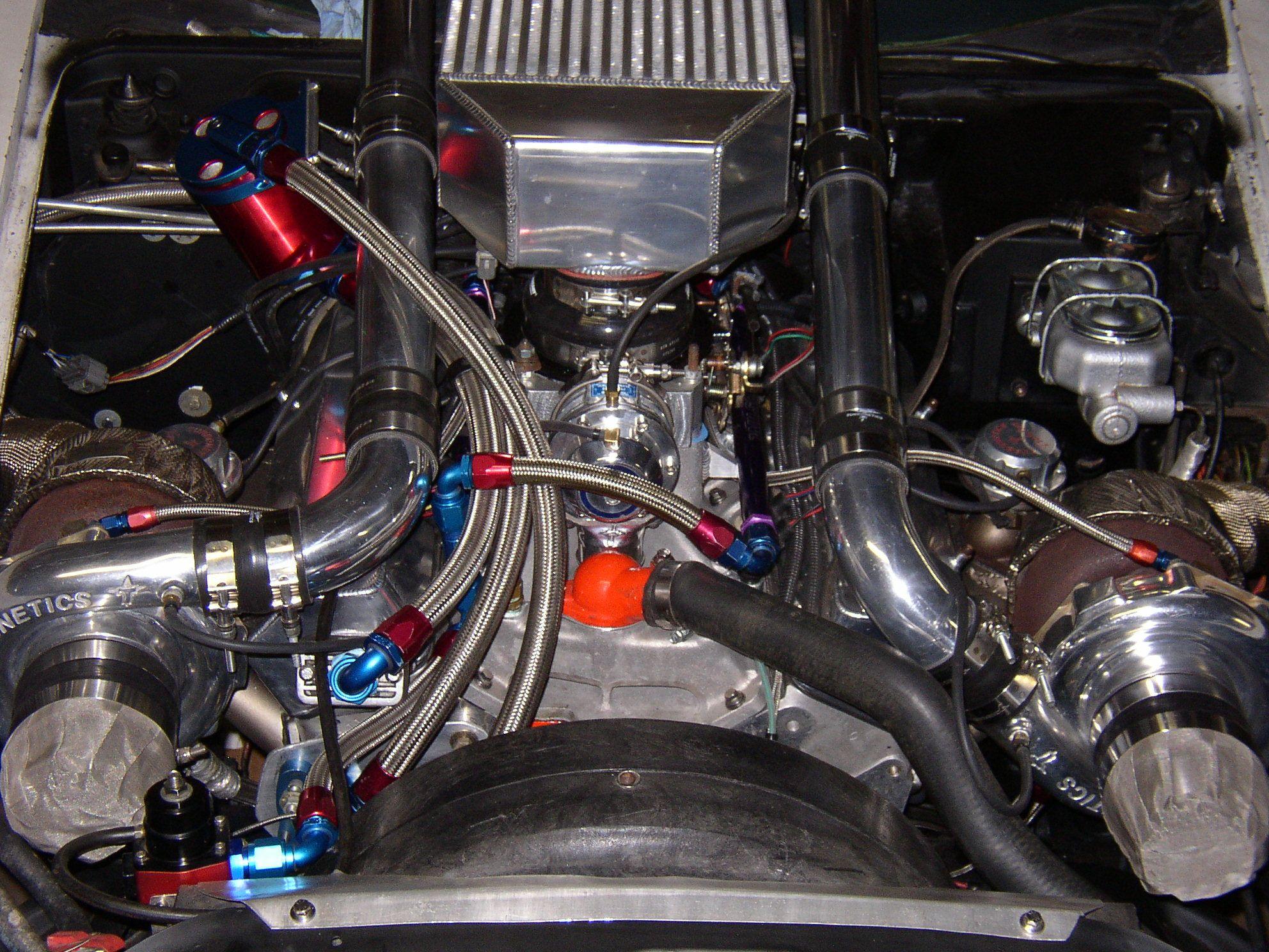

Yes that is the stock fan shroud and a (power robbing) flex fan.

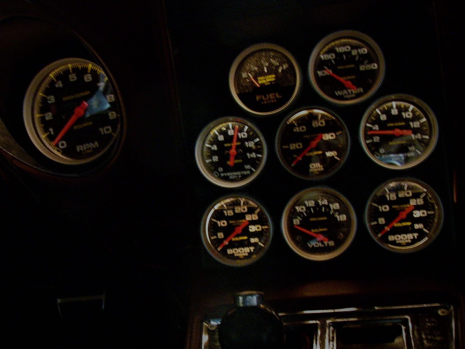

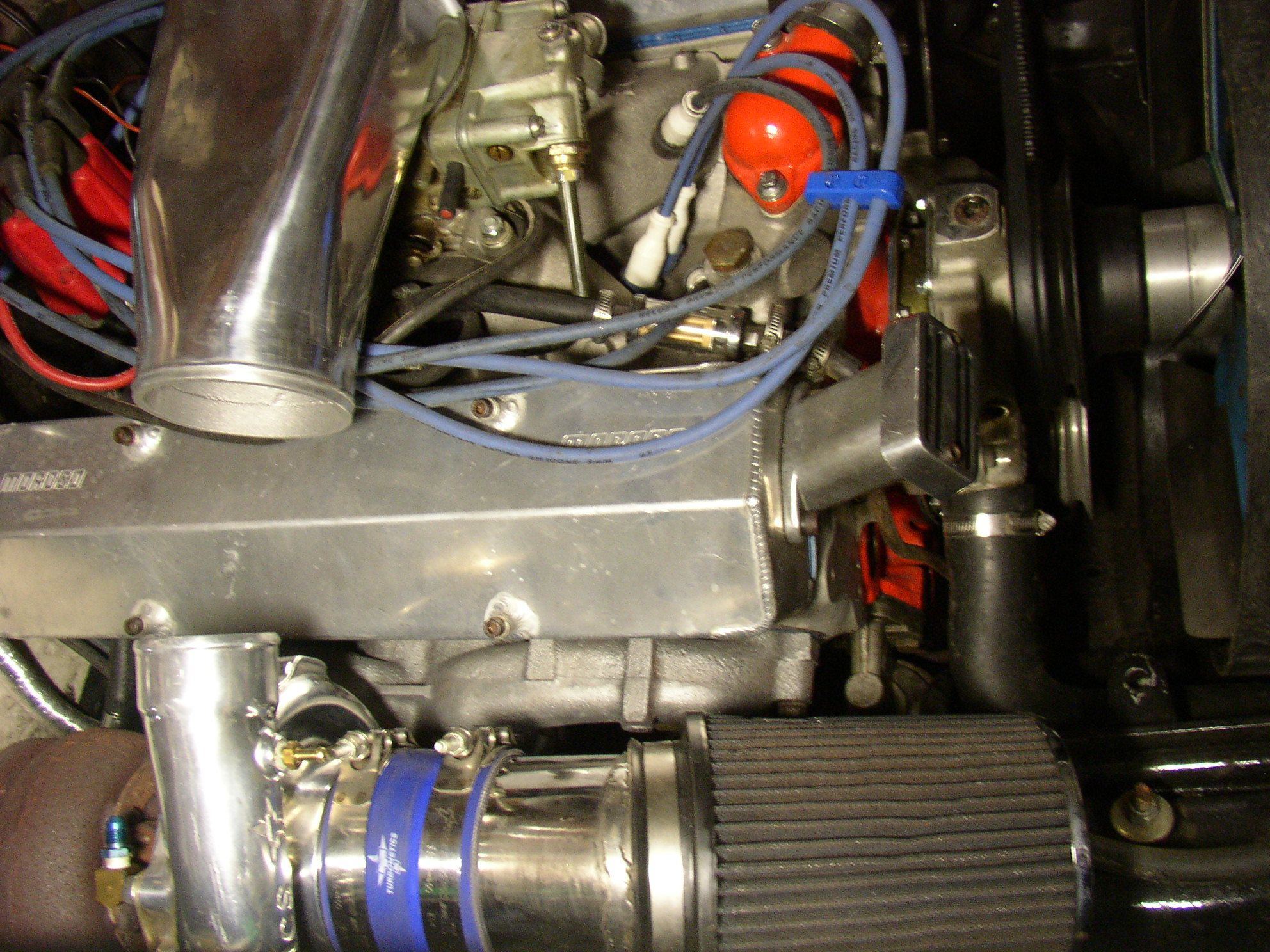

I use the wideband for A/F ratio and the EGT gauges help setting the timing tables for the XFI.
I added recall to the boost gauges and use them to check drive pressure and IC pressure drop. Besides, I like gauges.

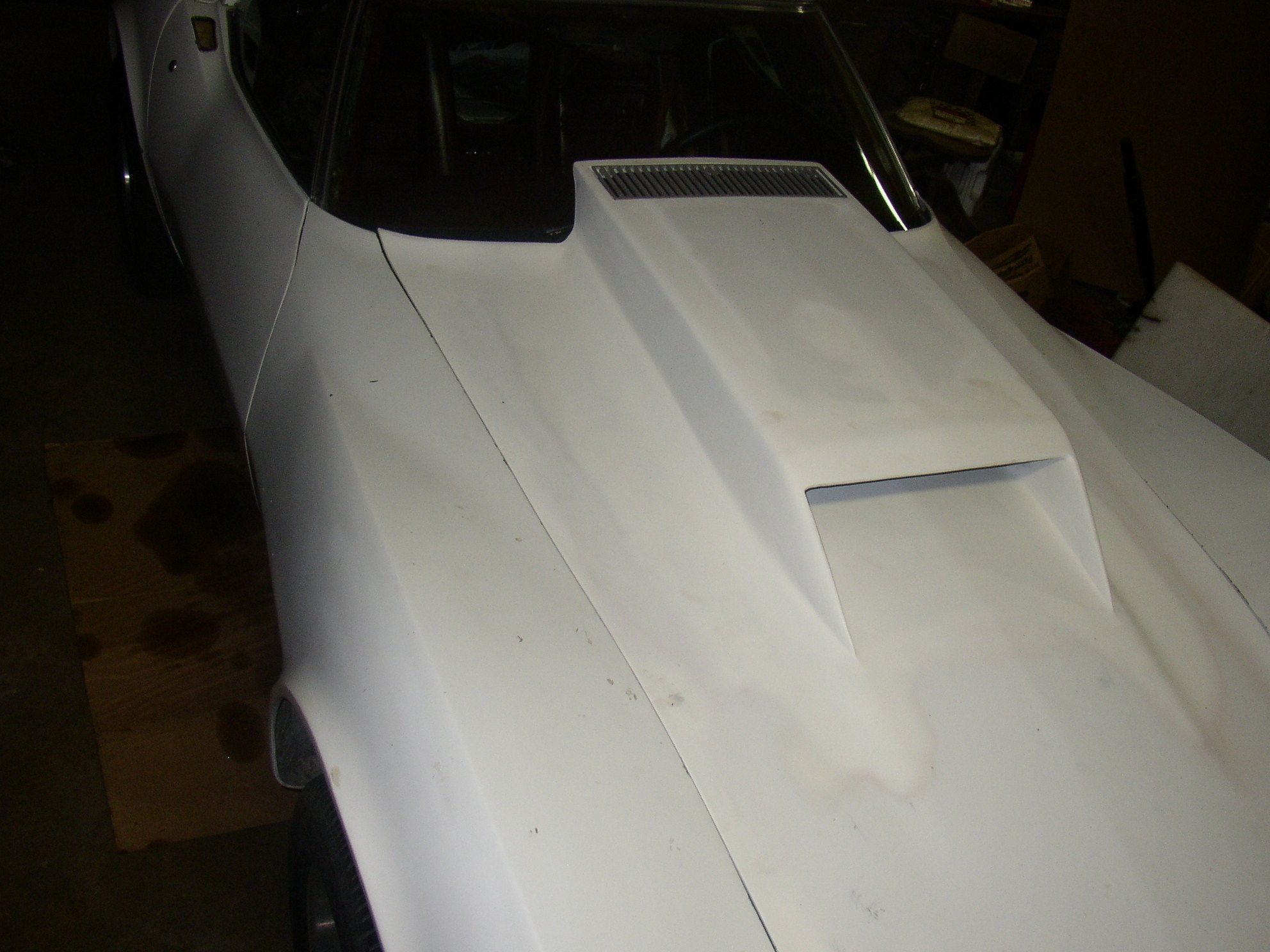

And built a stinger inspired scoop to cover it all up.
The car is mostly sorted out and I'll try to post any updates as I go.

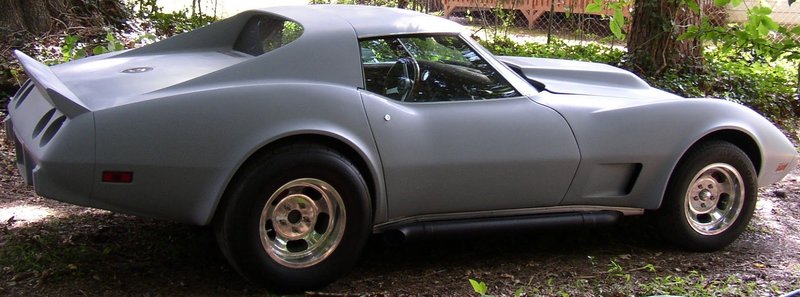

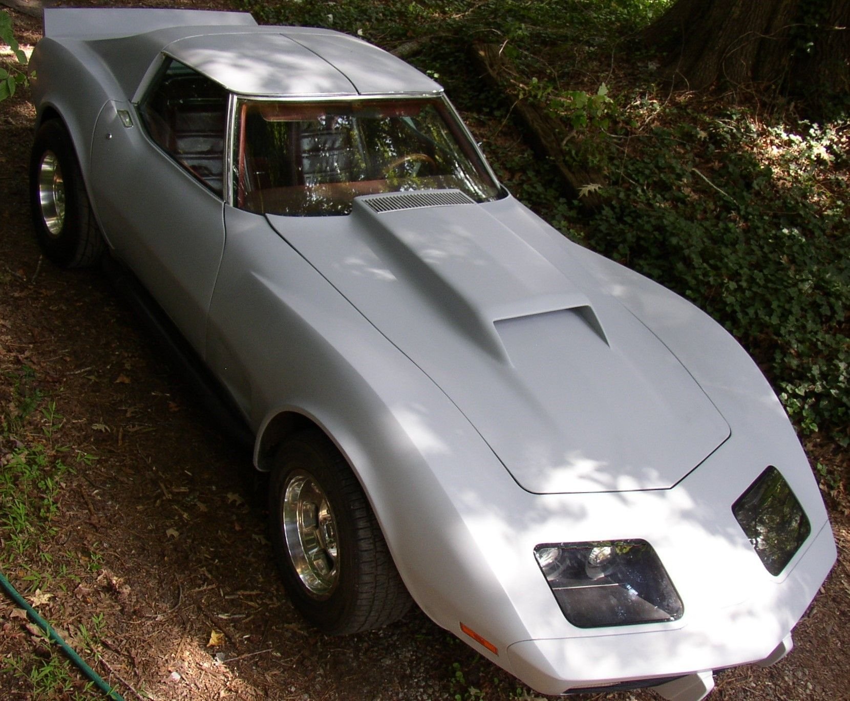

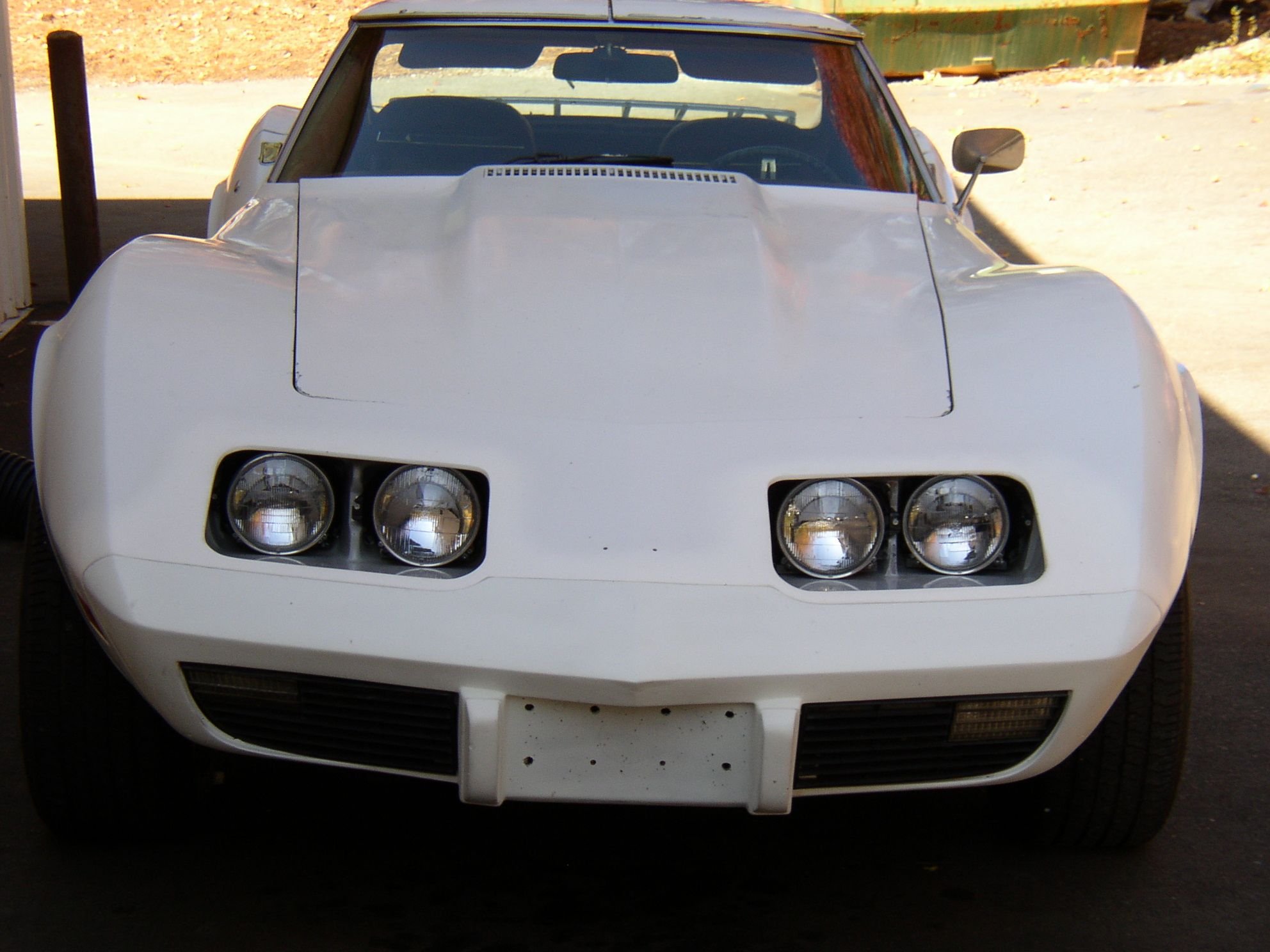

Stripping the car with a razor went pretty well
Thats where the fun ends and the brutal block sanding begins
I used G2 featherfill and after blocking that, used Akzo Nobel Lesonal primer
I planned on painting the car white, but rethinking possibly silver or grey

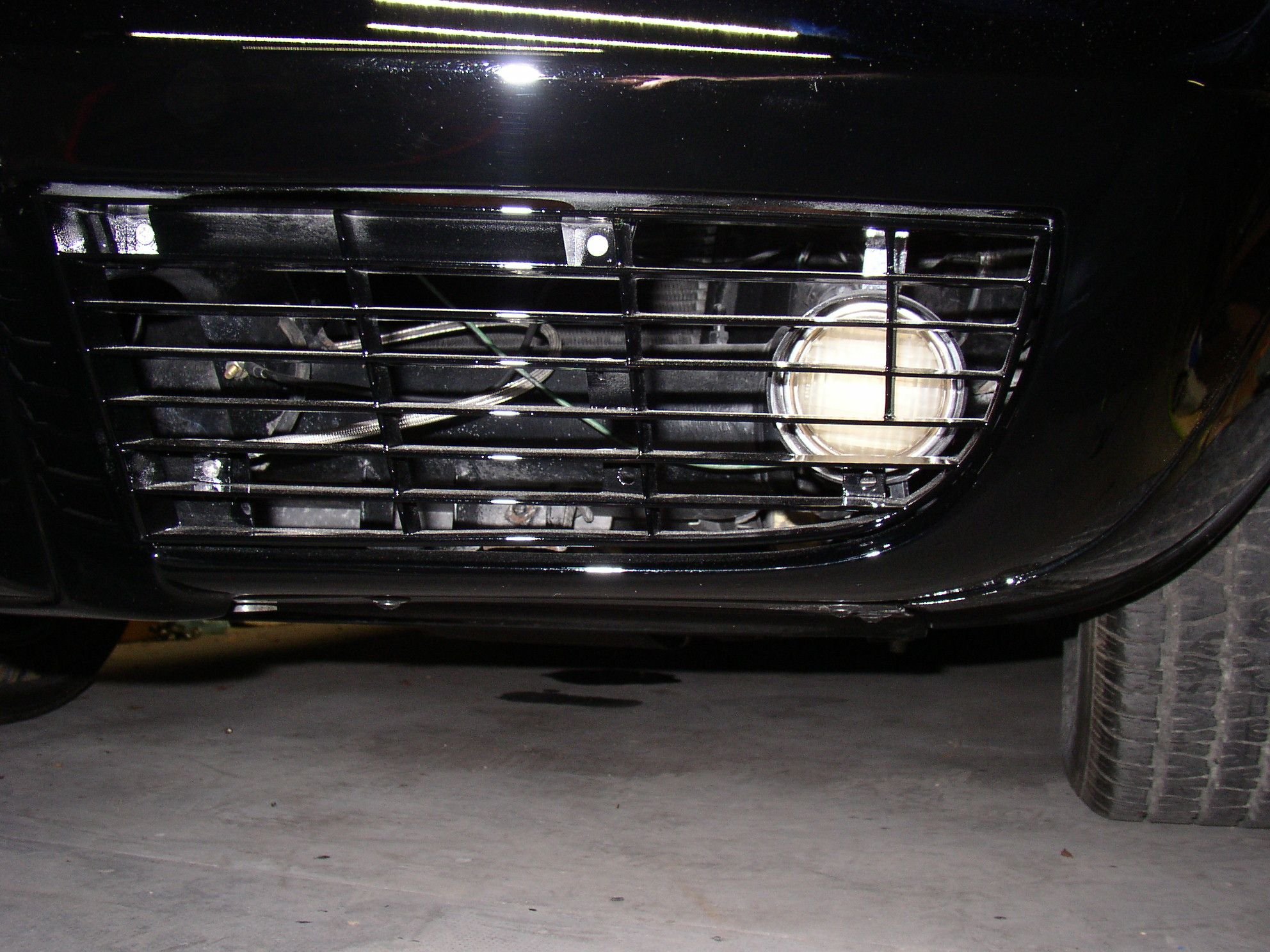

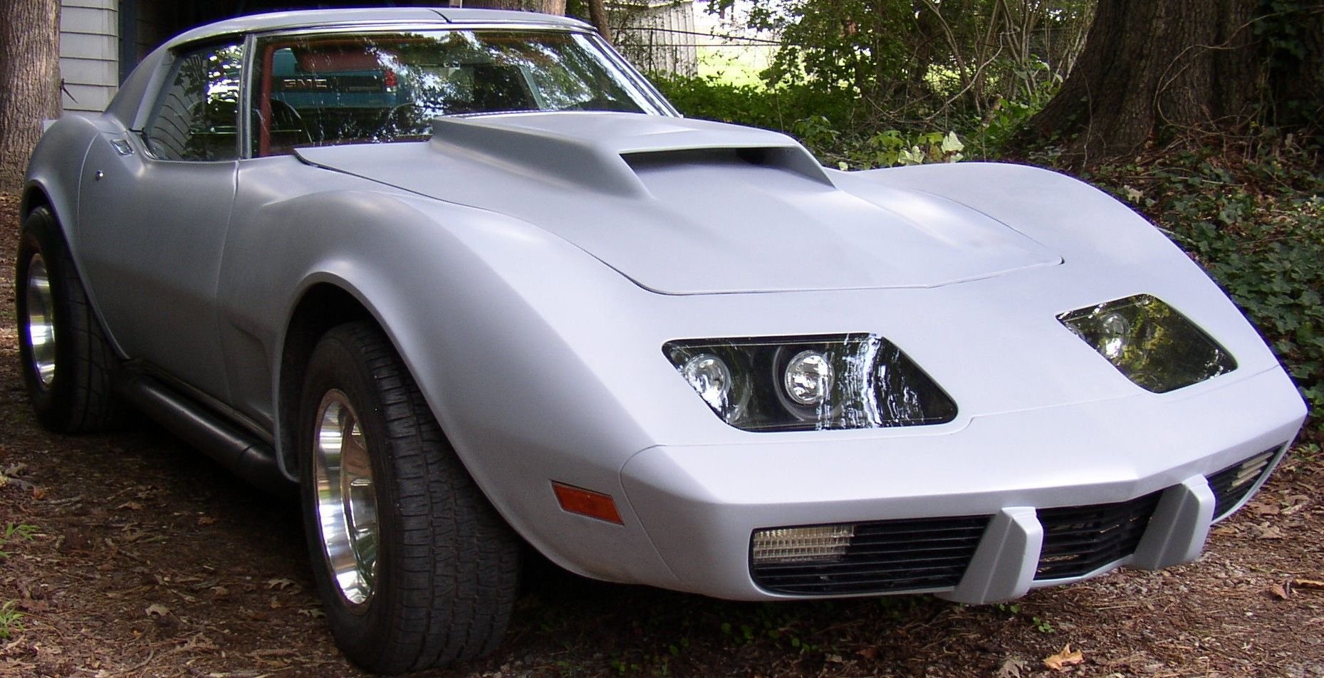

1974 center grill and 90mm Hella update
I modified the factory bezel to fit

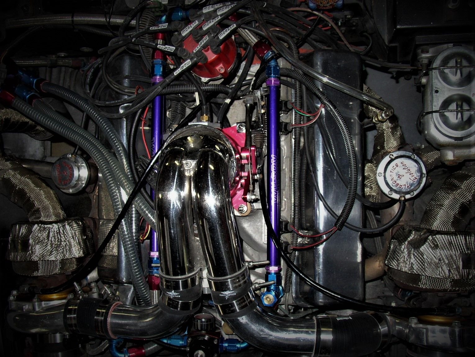

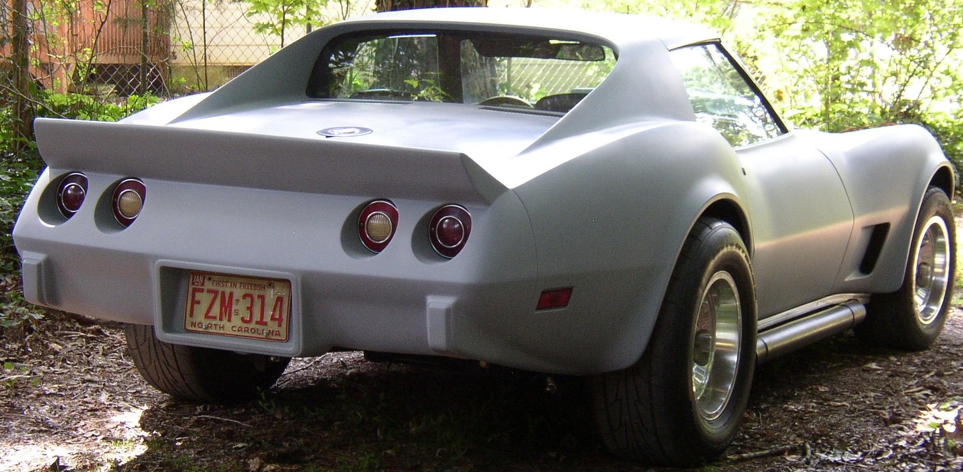

Changed the wheels, added a rear spoiler, and shortened the hood scoop a tad so I can see
and made some sidepipes
The top mount intercooler worked well but visibility was horrible so I decided to use water/methanol spray instead and I think the car looks better with the shorter scoop.

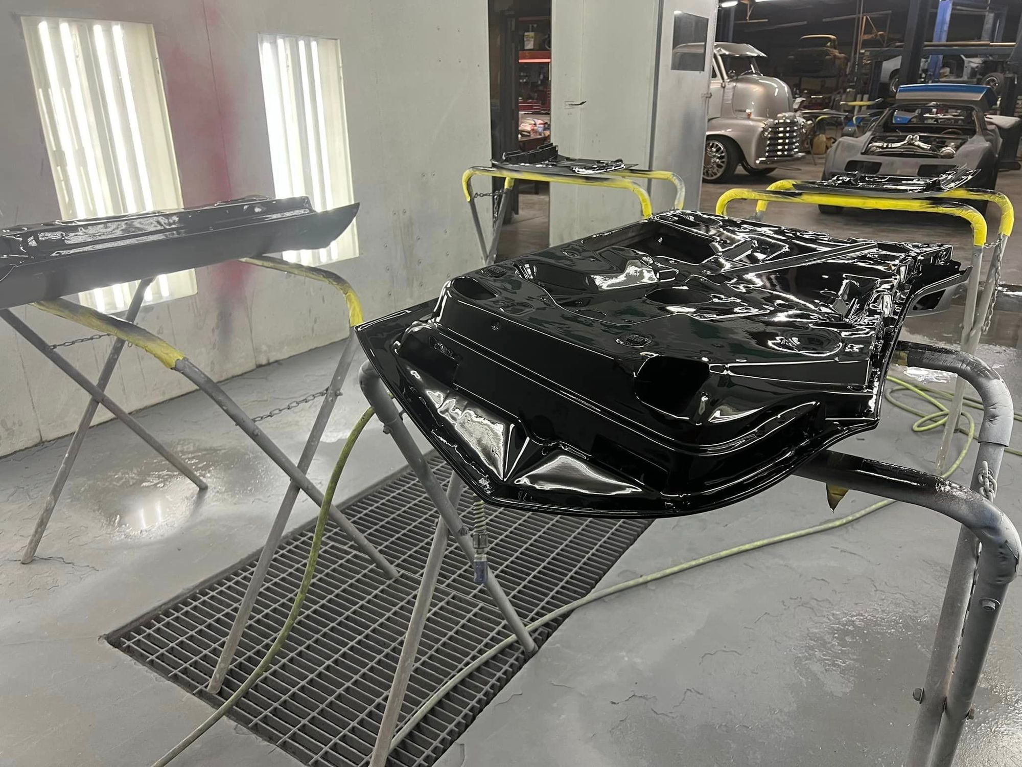

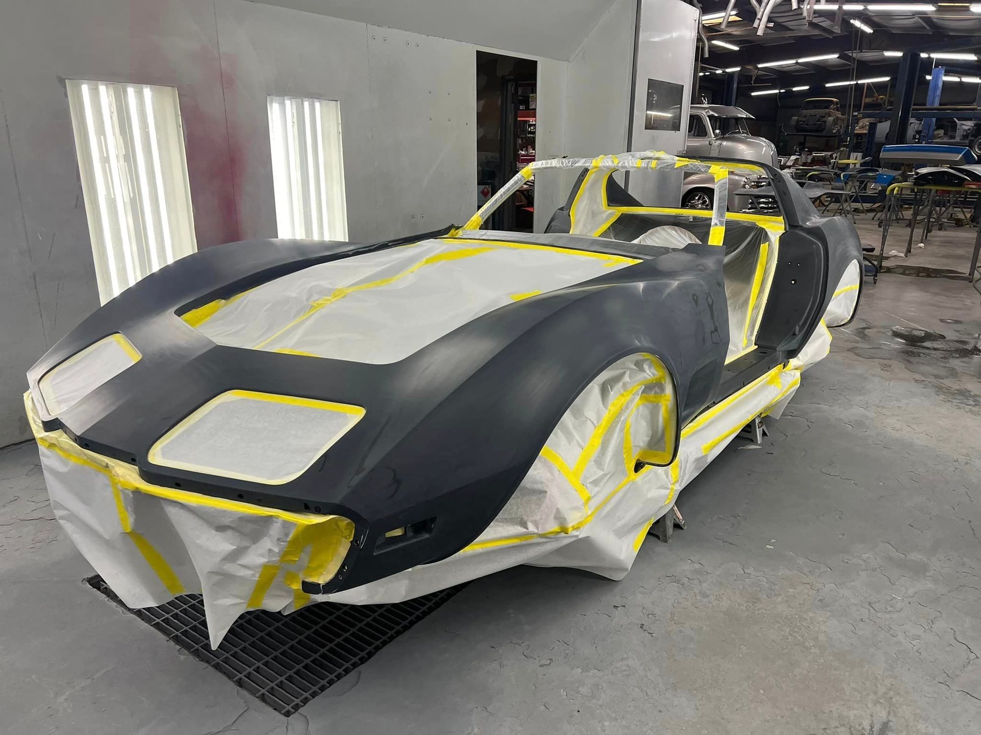

something darker maybe
Big thanks to my buddy Rob for spraying this. It wasn't as ready as I thought but he got me all sorted out.
it looks like an art exhibit
taping is its own skill, I definitely had help
then all of a sudden it starts to look like a car
happy trees
after all of this, putting it back together will be fun

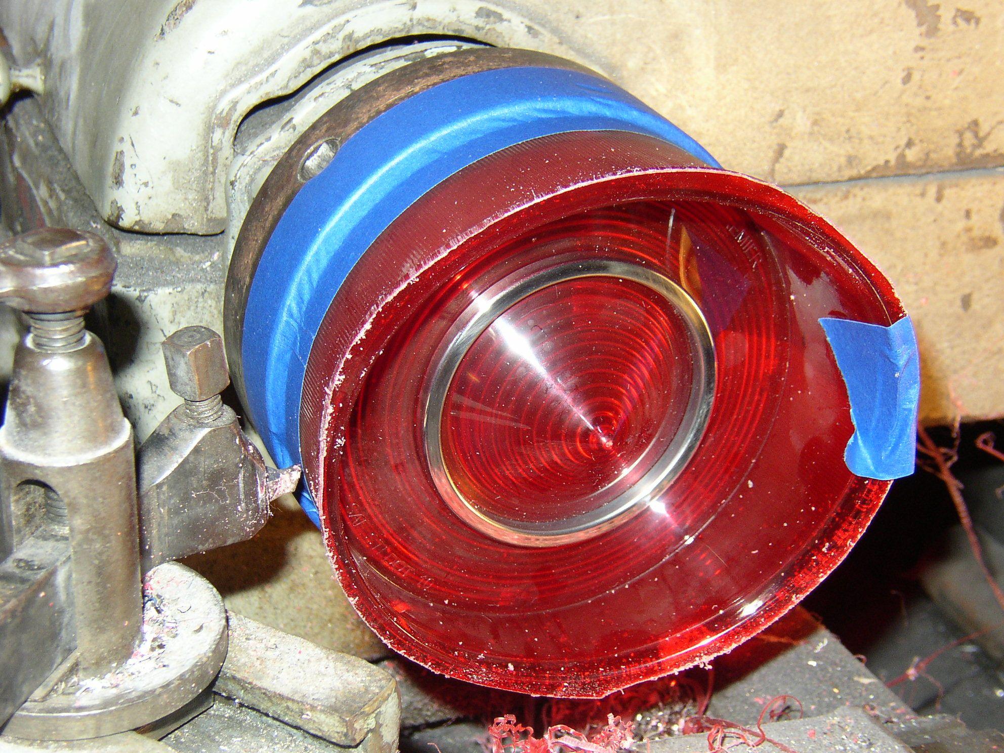

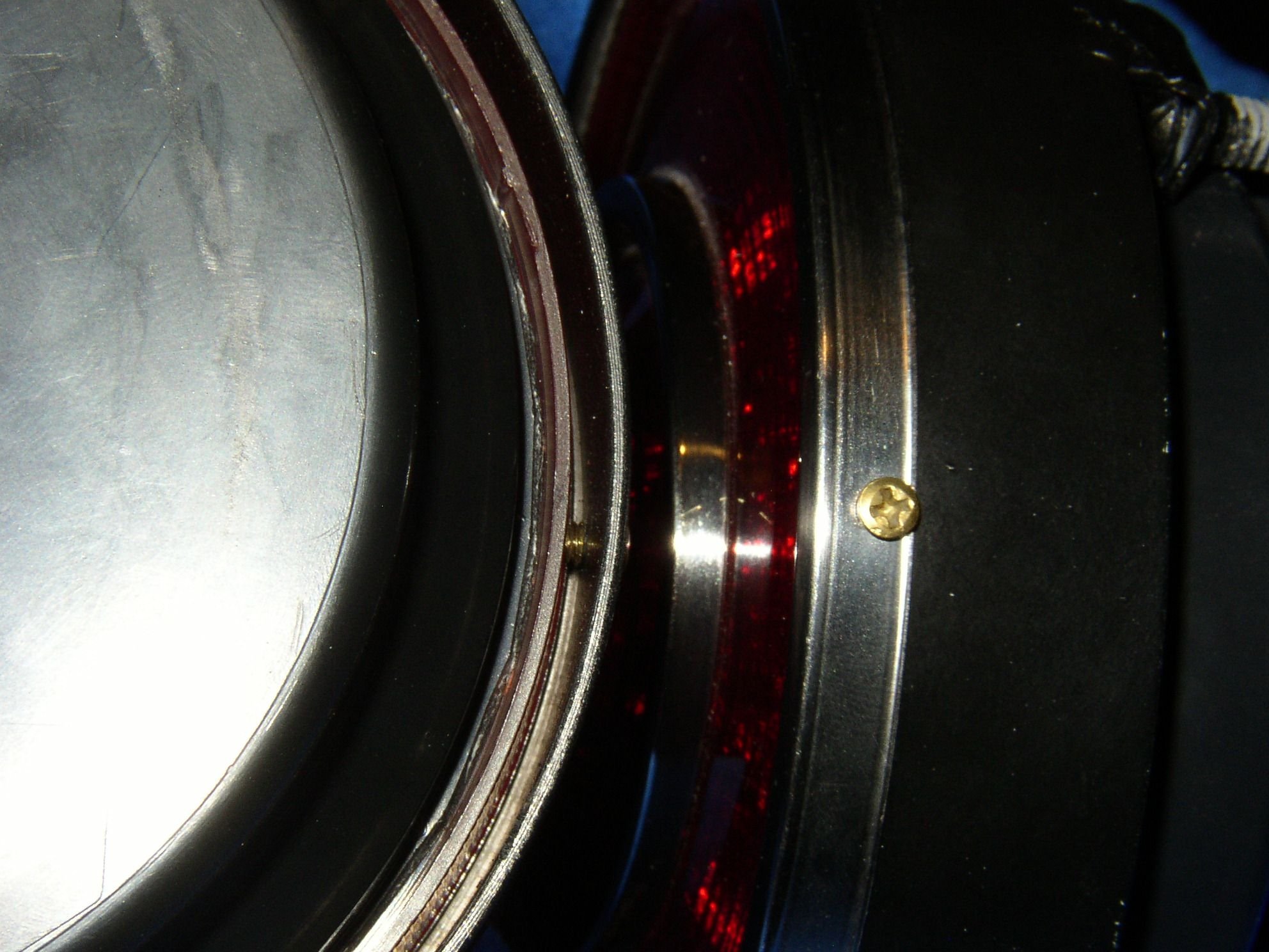

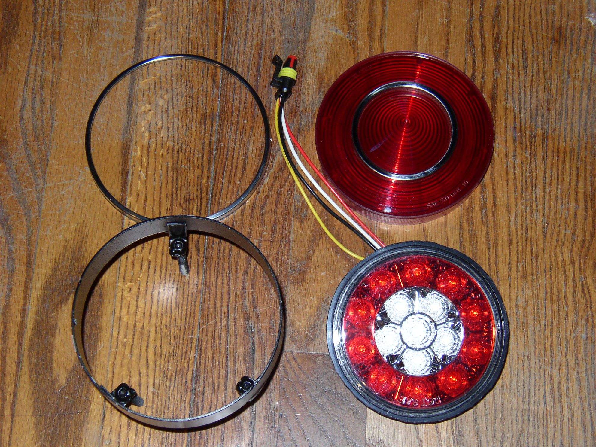

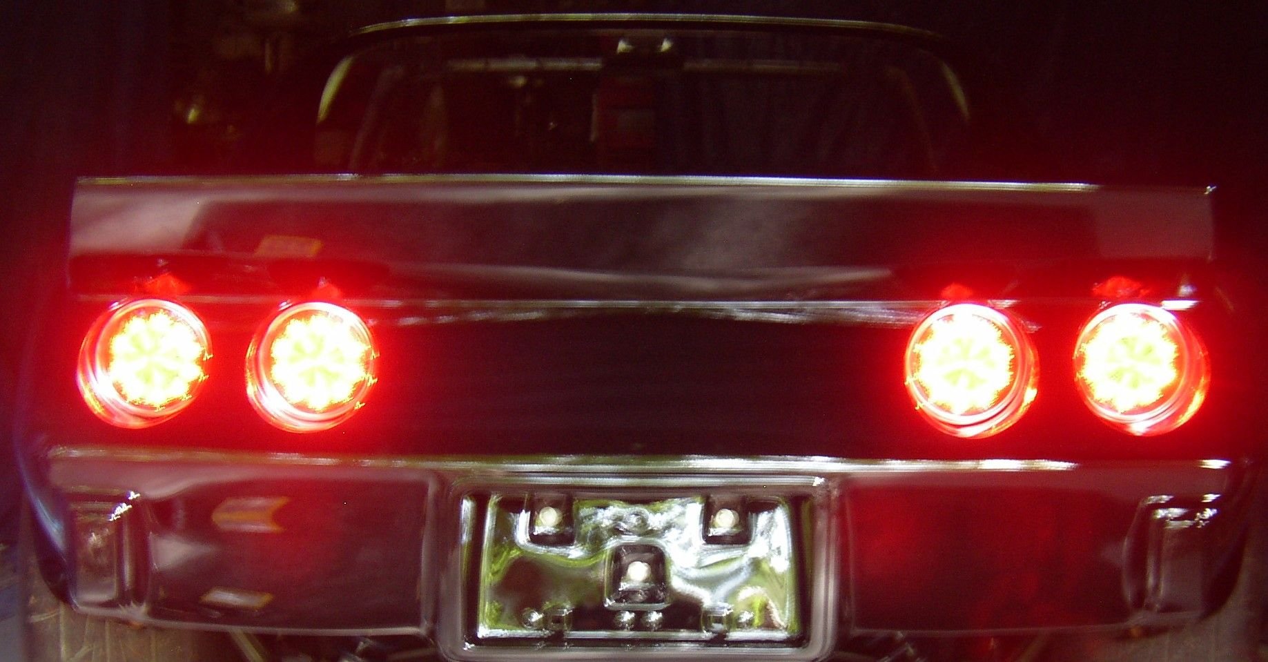

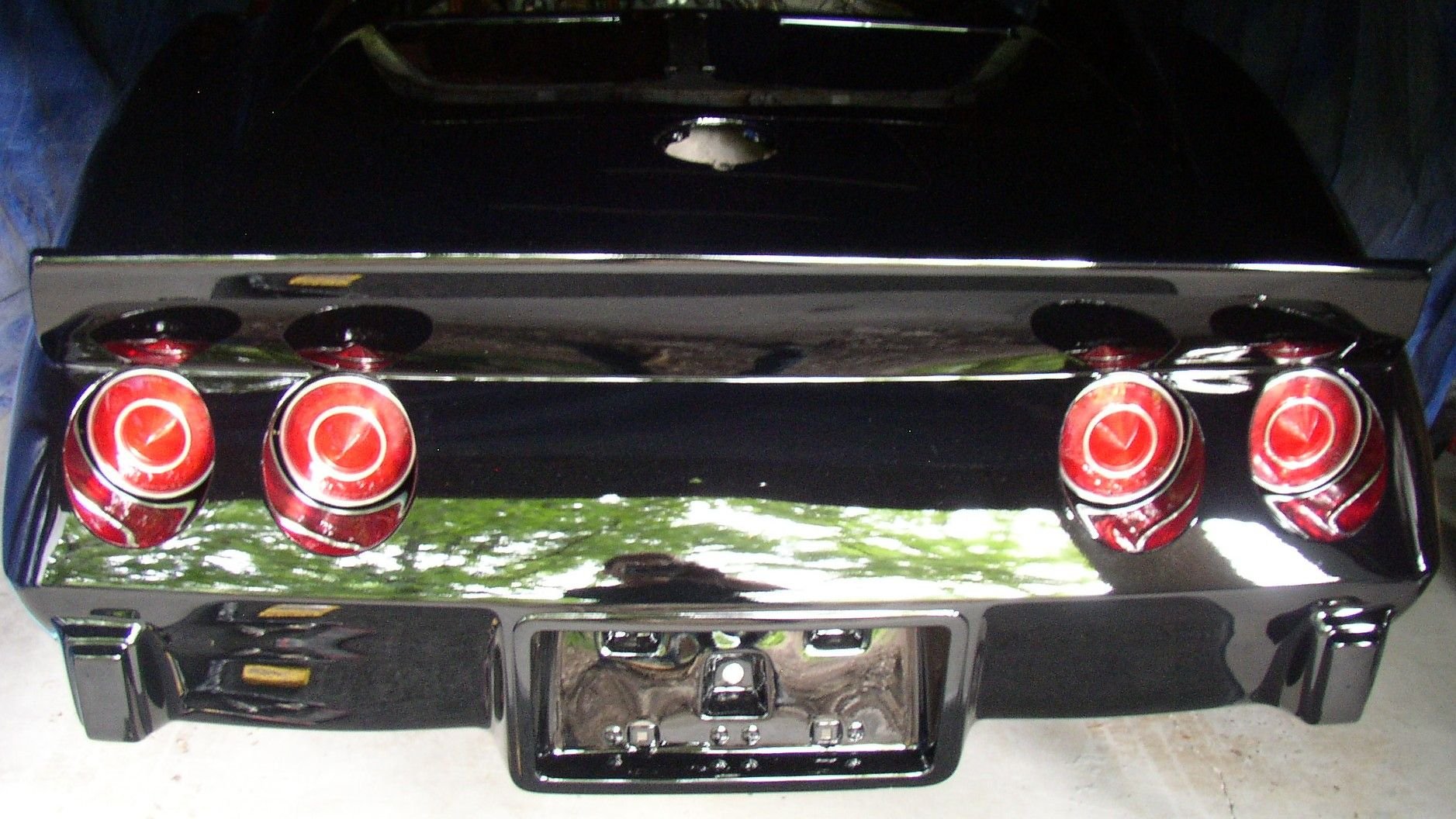

GM had it right with the chrome bumper C3 tail lights. The Camaro lenses are similar and sort of a popular swap.
The outer trim ring is recycled from the original light. I machined the lens to snap into it, and use set screws to hold it all together. The LEDs are truck lights with the flange trimmed off, they fit inside the Camaro lenses The rings are made from 5" exhaust tubing with tabs welded on that fit the factory holes.
Factory looking custom lights
definitely brighter than the old 1157 bulbs

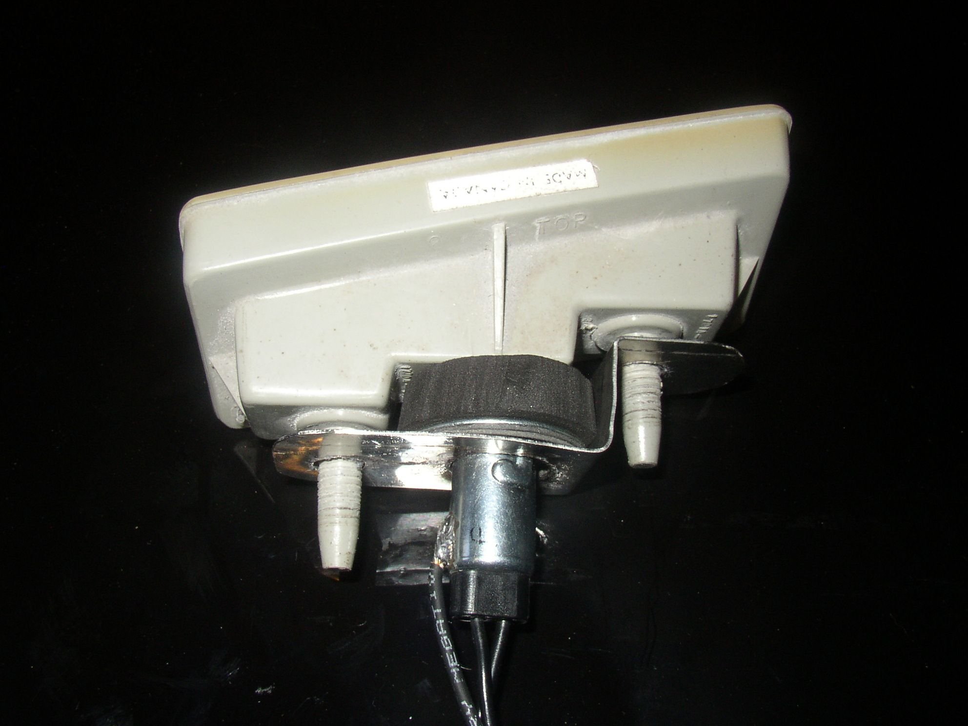

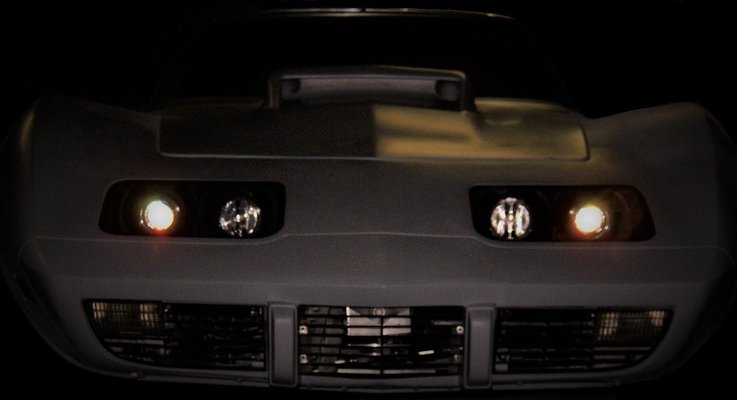

my answer to the LED marker issue is to add a dual circuit socket with a dedicated ground
I made 68-69 style parking lights and used Harley white/amber LED turn signals
they are bright af WARNING sun glasses zone

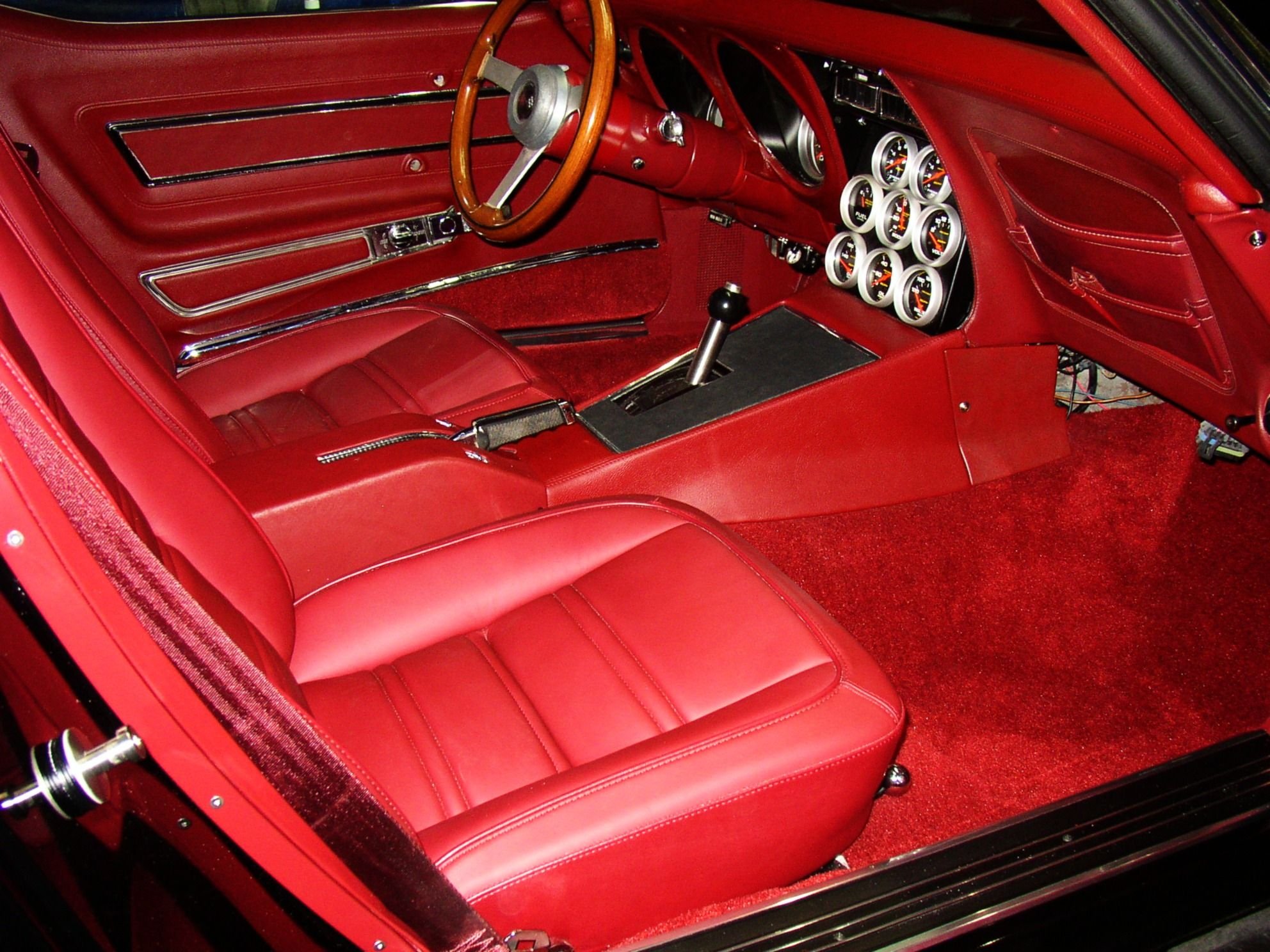

hats off to Vero for making some mighty fine seat covers. They match the originals' construction very well and are a nightmare to install. (my first time)
Getting in the short rows when it starts looking like this. I tried something different on the inserts instead of wood or just black.
I wrapped the E-brake console with the same material.
I made some projector shrouds and deleted the bezels. Making covers that match the curve of the body has been a challenge, these are ok for now.

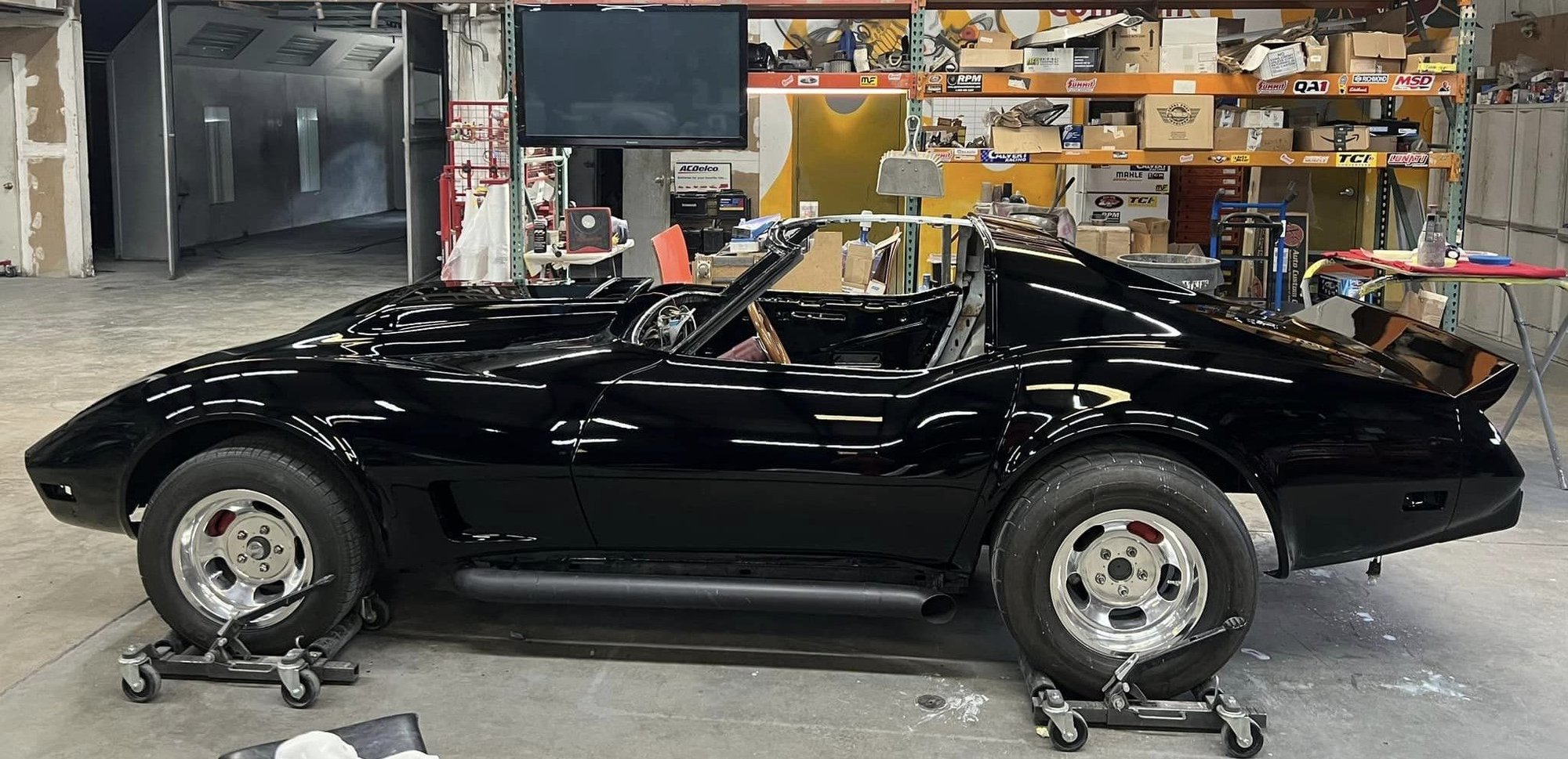

After years in paint and body prison, its back in one piece again.
The interior and paint get most of the comliments.
Dad usually steals the show in his 1944 Diamond-T
