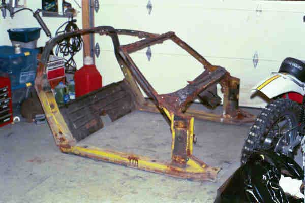

I asked about hidden rust and one thing that was mentioned by member sixfooter was removing the kick panels and using a mirror to look up.
I dont want to say I am a moron or anything, but where and how is this done? From inside the car? or in the wheel wells?
Just wondering- PHOTOS always help.
from inside ...
1. remove the sill plates
2. remove the kick panels (driver left foot & passenger right foot)
3. remove the speakers if present
4. look/see (passenger side shown)

Originally Posted by FrankVincent
from inside ...
This is very descriptive, THANKS.
Do the kick plates give you a good idea of the frame status/bird cage?
Is this a major rust potential area?
