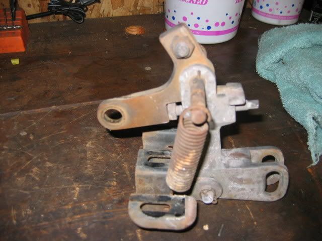

if u could post a picture it would help me also. Thanks

Here's a few pics of my assemblies out of the car. I think this is the adjustment bolt you are looking for. Hope this helps......
