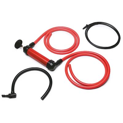

I used that tool :
summit # WMR-W1145 , cost about $10.

You suck it out
Seriously--use the pump/suck tool Nutsy shows and suck it out thru
the fill hole.

The drain/fill plug is on the passenger side of the differential when you look at it from the rear of the car. Remove the plug and use a suction gun to suck out all of the old gear oil. Add one bottle of GM positraction additive and then fill with 75w90 oil from Valvoline or Lucas, your choice until it seeps out of the fill hole, You'll need 2 bottles of gear oil. Replace the fill plug and go out and do figure 8's with the car at a low speed to circulate the oil. Not a hard job at all, should take you about 30-45 minutes to do.

There is no "drain plug"....the diffy only has a "fill plug". [How often do you change gear lube....once every 20 years?] An old turkey baster with a piece of rubber hose works just fine to get most of the lube out. It's easier if you have just driven it so the lube is warm and less viscous. Put half the {new} lube in, add the GM posi-additive, finish filling with lube till it starts to run out the fill hole. Button it up and go.

I bought a $5 siphon pump at Harbor Freight - sucked everything right out.
