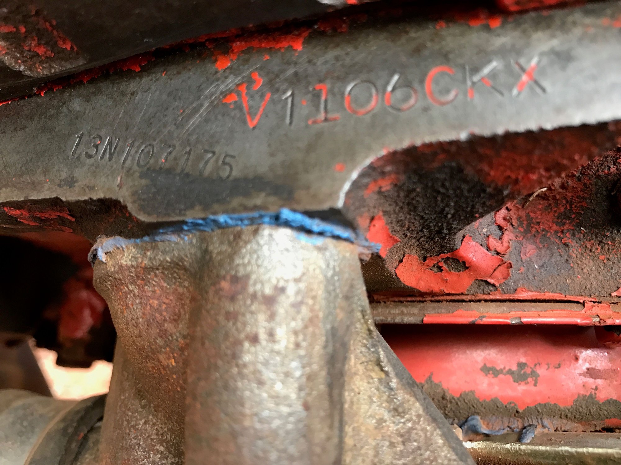

Default 13n107175
Sorry to dig up an old thread, but I have a small block with the same code and was wondering if anyone could tell which model and year it came from (Corvette or Camaro) based off the other code stamped next to it. (Part of the original car's VIN number I think).

Hi W,
Welcome!
The 'N' in the partial VIN sequence stamp indicates the Norwood assembly plant. So the engine was originally installed in a Camaro.
All Corvettes were assembled at 'S'… St.Louis.

Hi 540,
The engine wasn't originally installed in a Corvette.
It MIGHT be worth something to the person that now has the Camaro it went in.

Default L48
Thanks for the info
Is it an L48 ?

No. 2bbl carb California emissions 350.

Hi Weiry,
The 73 Camaro 145 hp CLX engine was designated L65.
Regards,
Alan

Its a CKX engine
