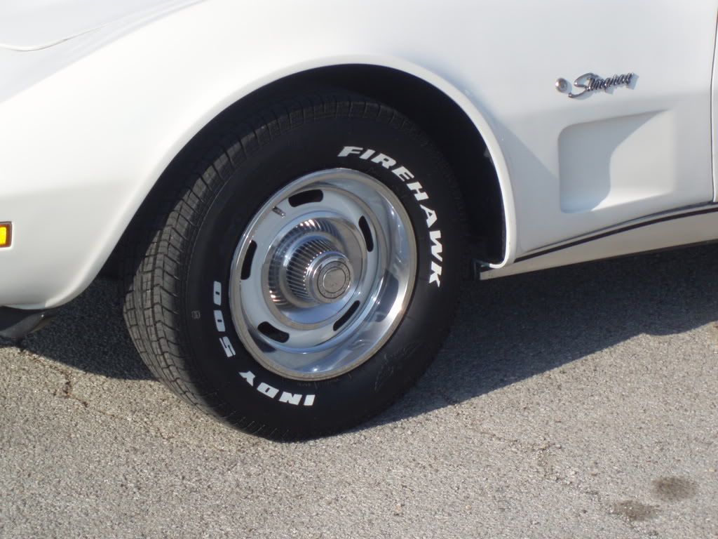

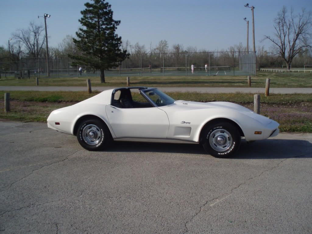

Hello,
Both BF Goodrich Radial T/As and Firestone Firehawk Indy 500s are
excellent choices for the classic look. For your car, I can only assume
the size was the same as mine - 225-70-15.
Last summer, I put on the Firestone Firehawk Indy 500 225/70/15s
on my 70'. They ride great and look sharp.
I also made sure the tires were new as well.
When you buy new tires, look at the last set of embossed numbers.
My date code was 1708. The first set of numbers, the weeks into the
calendar year and the last 2 numbers, the year the tires were built.
My date code, the 17th week of 2008.
The BF Goodrich Radial T/As and the Firestone Firehawk Indy 500s 225/70/15 are priced
about the same, around $400.00 for a set of four. I had my choice of both for $400.00 with
road hazard protection, disposal and tax included.
