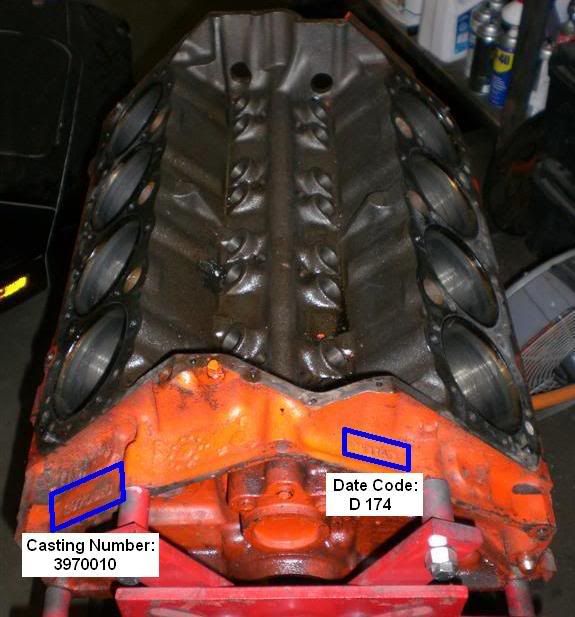

Here is a good pic showing you where to look for the casting number and casting date. I don't think it's a Corvette engine however. The numbers may be in slightly different locations and probably hidden under a few years of grime.
Good example BD, thank you for sharing that. I am going to "capture" your image for future use and discussion if that is okay with you? Not publically, just here on the forum as needed. Credit will be given to you for the picture.
Thanks a bunch.
David

Yeah man feel free to use it any way you like, I don't mind at all if it's helping you or someone else.
