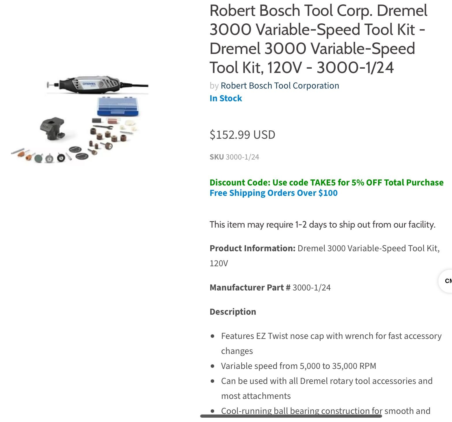

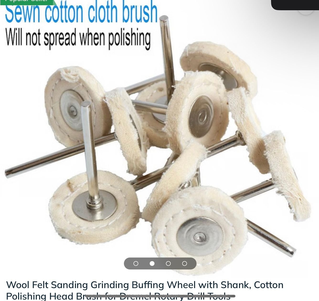

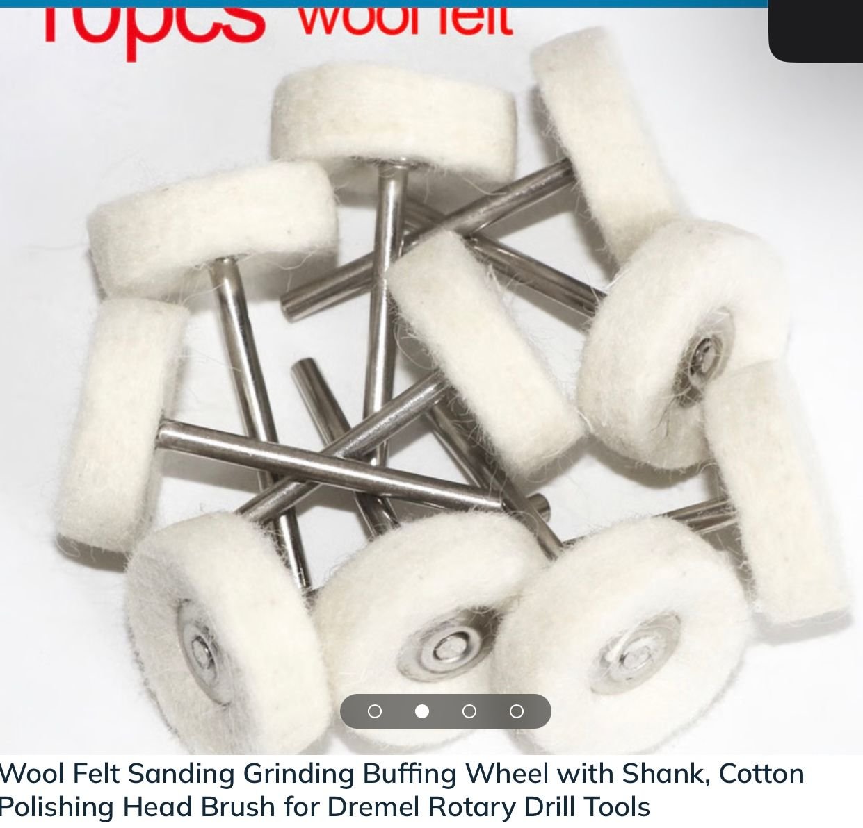

If I had the choice, I would probably remove the stainless and polish it. As you know there are risks associated with removing the stainless, bending or breaking clips, bending, denting or scratching the stainless.if you wish to polish the stainless while it’s on the car I would recommend a Dremel tool. The Dremel tool speeds can typically range from 5000 to 35,000 RPM. They have hundreds of buffing attachments available. The Dremel tool comes corded or battery operated. Just my 2 cents worth.
I'm guessing that sometime in the past sixteen years they figured out how to polish their trim
