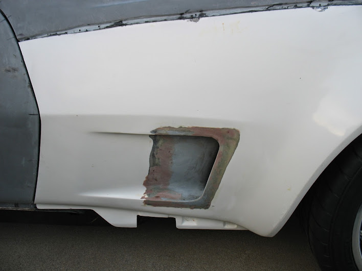

Fabbed the piece for the gap from the '73 - '74 bumper, but the bumper isn't glassed in yet.
Glassed in the gills and hung the fenders.
Wheels and tires have landed and the fenders mounted.
Next I'll be cutting the exhaust outlets and glassing in the rear, nose and bonding strip seams.

Thanks Adam. I created a mold and glassed around the mold. It's basically consists of top and sides and helps maintain the center design line. I'll add pictures in a bit. The gills are my stock '77 grafted onto the aftermarket fenders. I thought about grafting the '69 style, but decided to maintain the '77's.

Adam here are some pics. I cut up the old rubber bumper and used it with release tape for the mold.

I cut the exhaust holes out of the rear panel and glassed in surrounds to mount the trim from a '69.
I created a shelf to hang and mount the rear panel.
Also created strips to bond the sides.
Dished the fender bonding area.
Glass...
Epoxy filler
I had to fabricate mounts to accept the '74 grills and license plate bracket since the '77 inner bumper supports don't have the same provisions as the '73-'74.
Next I'll be glassing in the front bumper.
