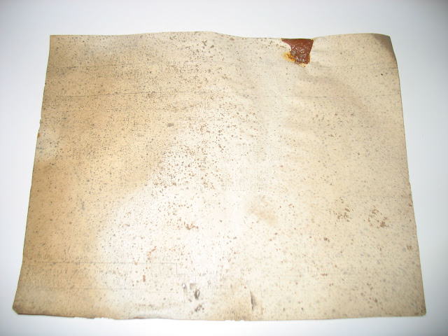

Were you able to save the tank sticker? If so could you post a photo of it?
I was able to save the sheet, but the ink is very faint.

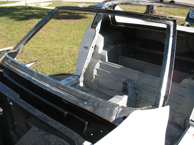

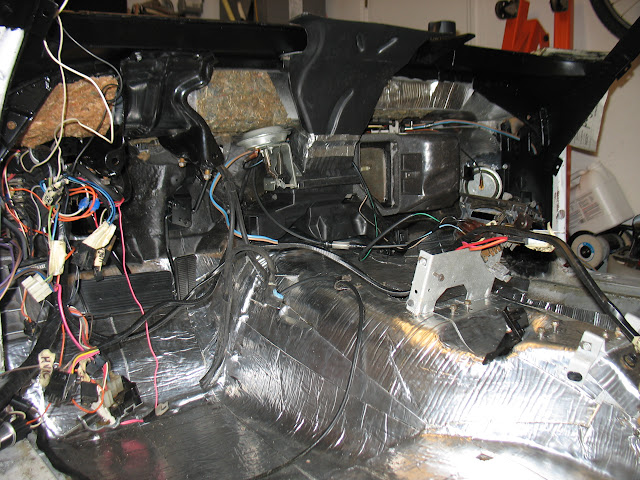

I had painted the windshield frame with Rust Bullet a while back and did not like the way it turned out. I have been procrastinating on getting it finished and the time had come where I could no longer ignore it in order to progress. I removed it all and then used POR-15 which turned out so much better.
Stripped -
POR-15
Chassis Coat
Refurbed the headlight relays
Laid "Peel and Seal" on the firewall
I cleaned and rewrapped all of the wiring and put it in along with the firewall insulation
Attached the rebuilt heater box and put in the refurbed brake and gas pedals and finished the floor and rear compartment
Finally I pressed the new u-joints into the halfshafts and driveshaft
