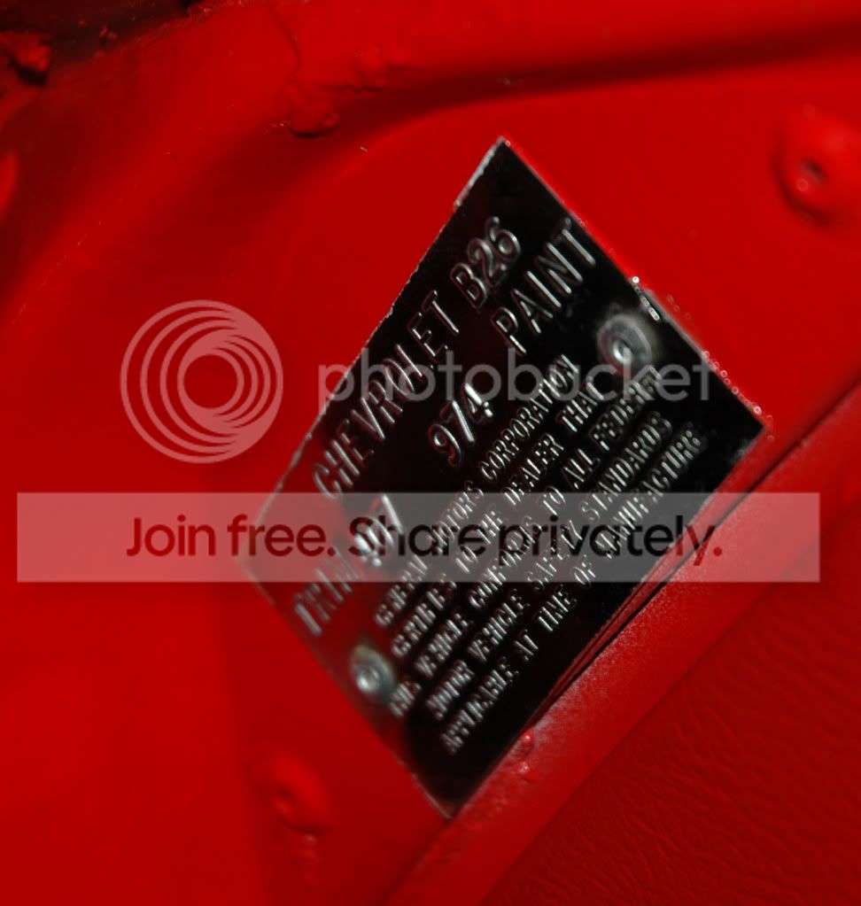

Hey guys,
I just want to ask if you guys could double check this to make sure I've got it right..Im not good with this decoding yet
I looked at this car again today, this time taking pics of the appropriate numbers.
It is a 1970 convertible, 350/350hp, red paint, red interior, 4speed,
Thanks guys...

I'm definintely not an expert at this either, but I see some things I like.
1. The VIN and the VIN derivative stamping match the way they are supposed to.
2. B26 would be a build date of February 26th, 1970. This seems about right given the serial number of 4959. Check the 1970 Corvette Registry to confirm that 2/26/70 is reasonable for that serial number.
3. The engine assembly stamping has suffix CTH, this is 350/350 with manual trans (the only way 350/350s came in '70)
4. The engine assembly date appears to be 2/11, this makes sense with a trim tag date of 2/26.
5. 974 was Monza Red in 1970.
6. 1970 350/350 had a tach with a yellow line of 5700, and a red line of 6000. It is hard to see in the picture, but it looks like what is present there.
I don't love the look of the stamp pad though, mostly because of the paint. It may be perfect underneath, but we can't see at the moment. The fonts appear to be the right size to me (again, not an expert). The "11" in the assembly date uses two obviously different characters for the ones. I do not know if this is typical of factory stampings, but I have seen weirder stamp pads that the experts sign off on as likely original, so I wouldn't say there is anything wrong necessarily there, I just think I would get someone more knowledgable than me to have a peek before I paid my money.

Old Feb 10, 2010 | 05:57 PM
GREGG-73's Avatar
GREGG-73
Joined: Jan 2003
Posts: 2,813
From: JOPPA MD
Suffix code: CTH = 350 c.i. L46, with 350 HP, Rochester Q-jet carb, performance cam, 4-speed.
Trim & Paint code = 974 Monza Red exterior.....407 Vinyl Red interior.
Hope this helps....
