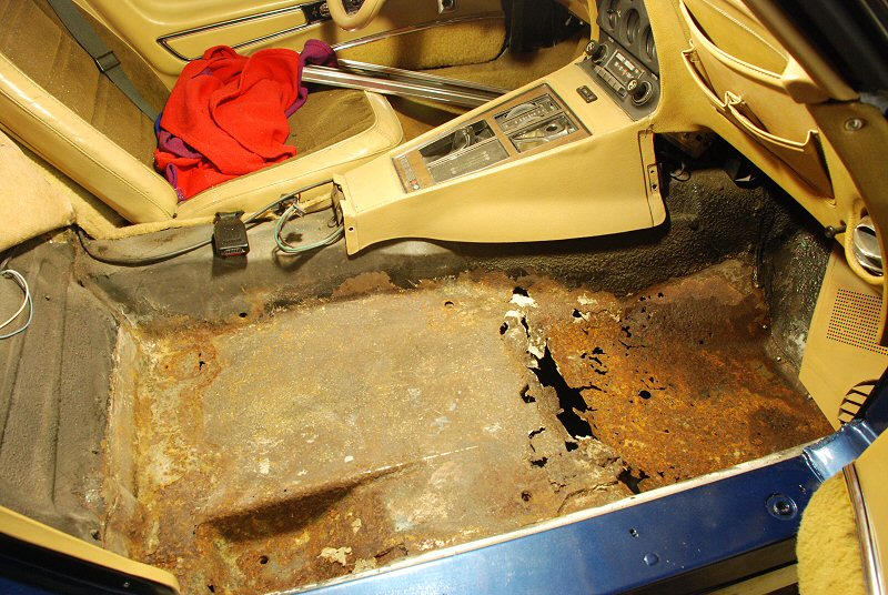

Default Even WORSE
So I took a screwdriver to the driver's side pillar, and after vacuuming out what seemed like tons of sheet metal... here's what's left:
Brutal
Still not as big as the hole in the floorpan below it...
Old Mar 23, 2010 | 07:56 PM

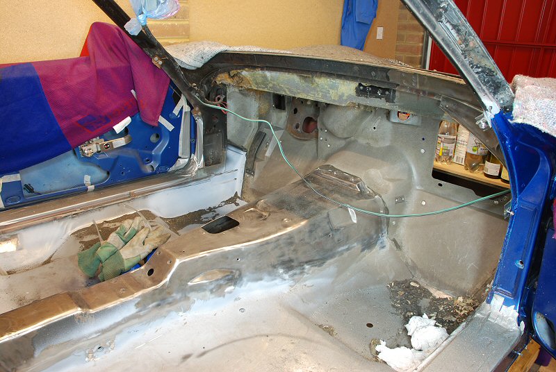

Birdcage = bad.
Floor = fixable:
Birdcage could be repaired if you fancy a project, but unless you love the car more than life itself or can do it yourself, costs will be unjustifiable.

Is that the frame I can see in these two pics?
Brutal
To Rate my bircage rust!
Old Mar 24, 2010 | 08:46 PM
BillysRed1980's Avatar
BillysRed1980
Joined: Apr 2009
Posts: 54
From: Indianapolis Indiana
Why, yes sir it is!
