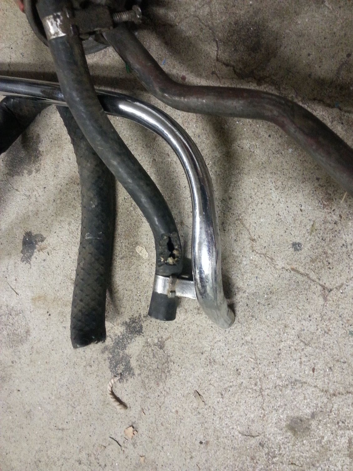

This was the fuel line that was coming out of the modified 427 truck fuel pump... (you know you can save a few bucks on parts if ya don't say they are for your Vette)

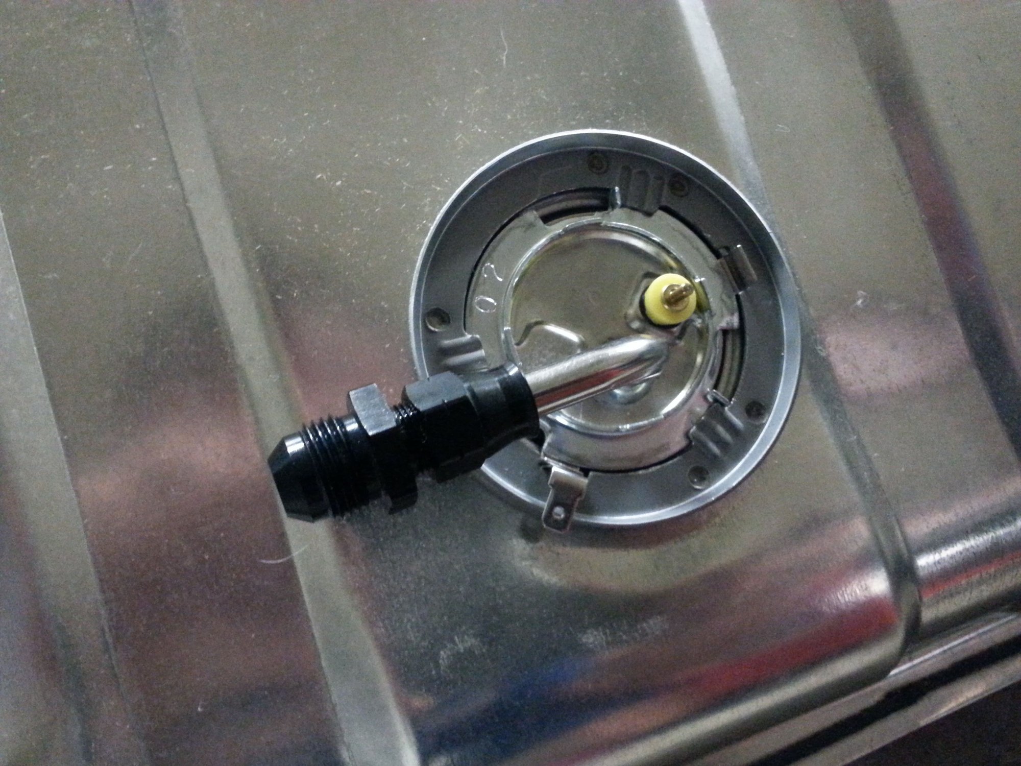

I picked up a complete tank kit from Corvette Central to make the replacement smooth as possible and it did the trick for me.. I plugged off the return system as my modified system is return less
cleaned up the brace

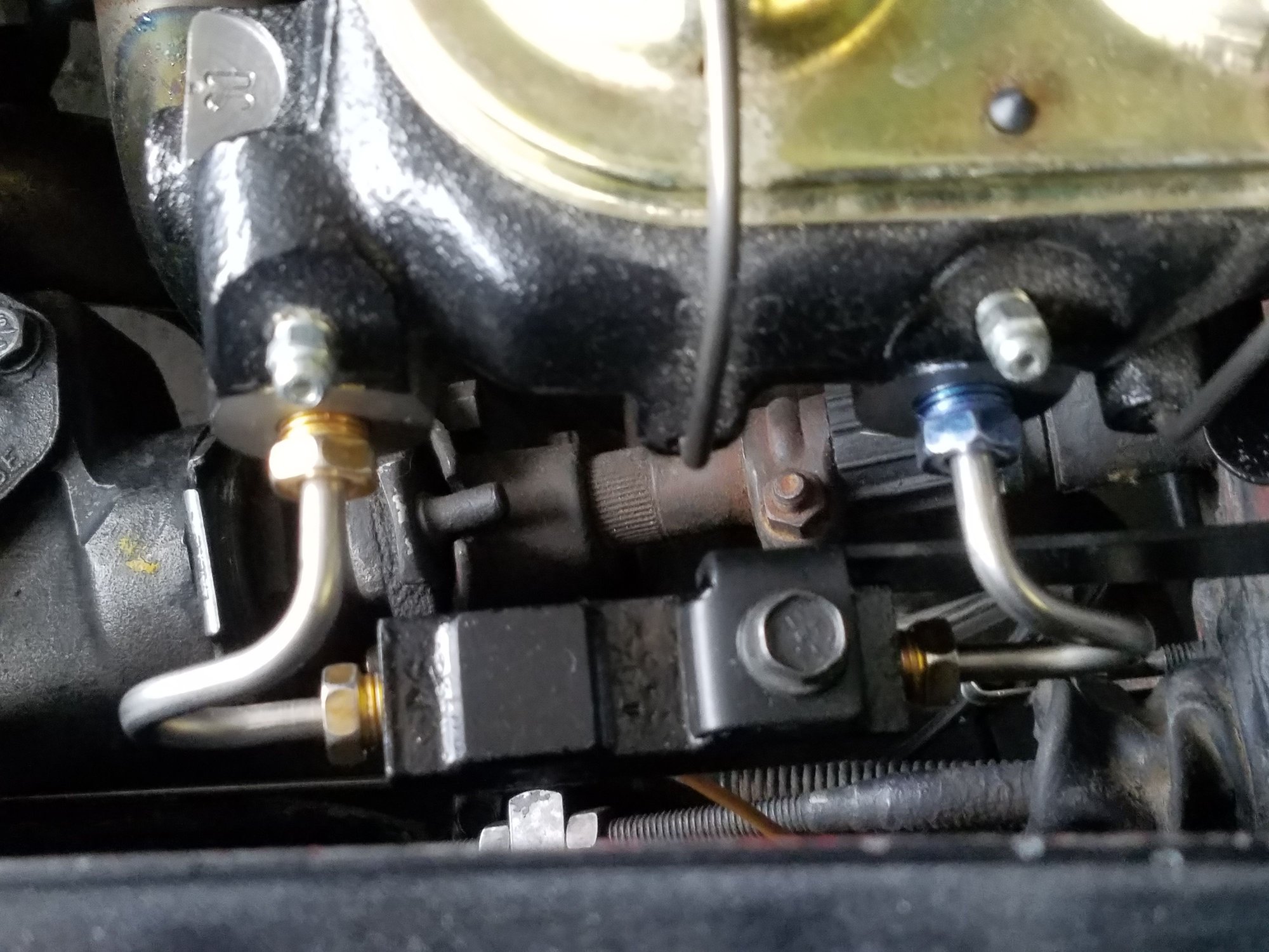

I modified the hard lines with some Earls -8 fittings so I could run some of their -8 Pro-lite 350 fuel line plumbed in a Summit Big Block fuel pump installed with ARP bolt then on up to a summit inline filter.

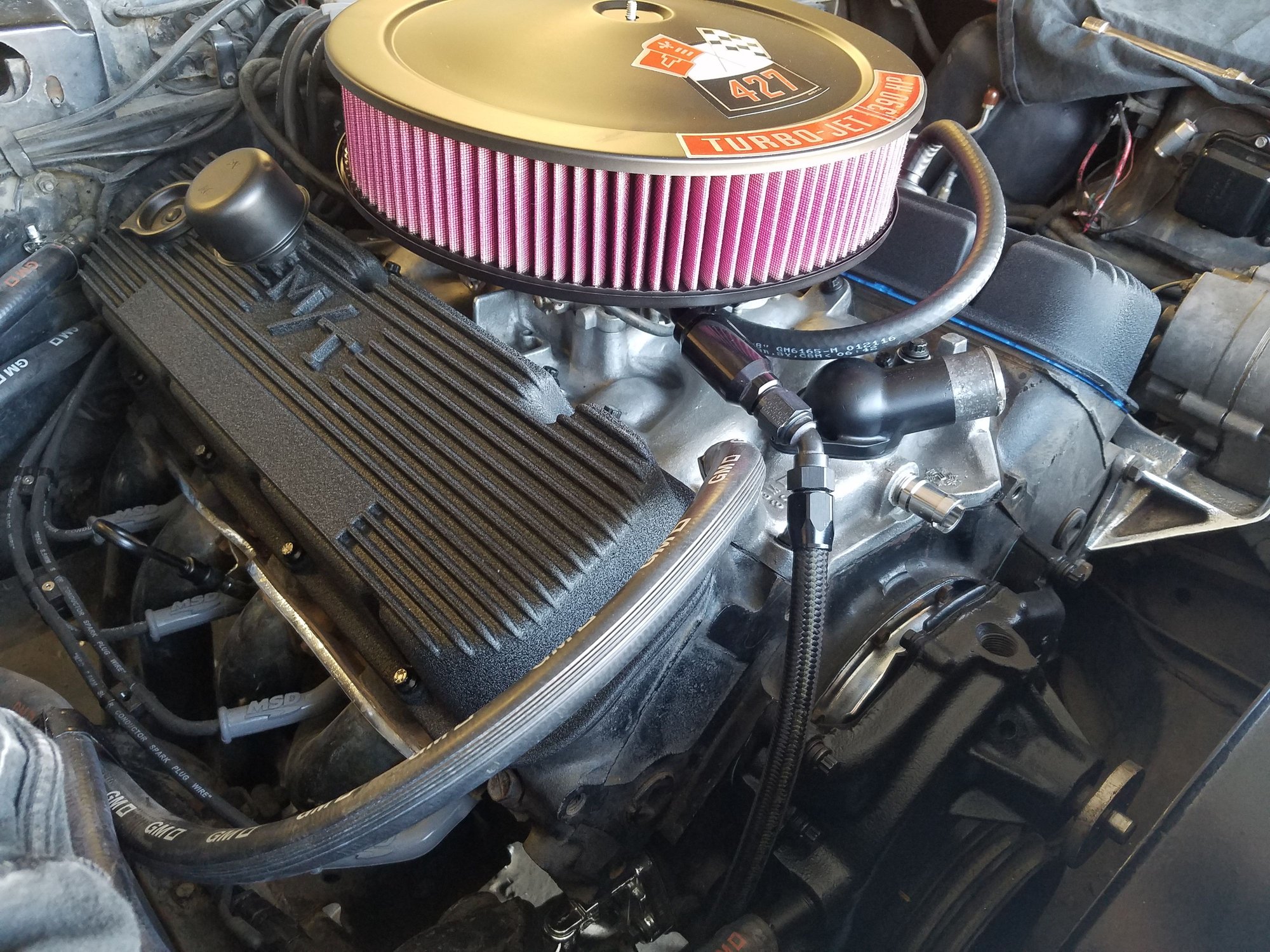

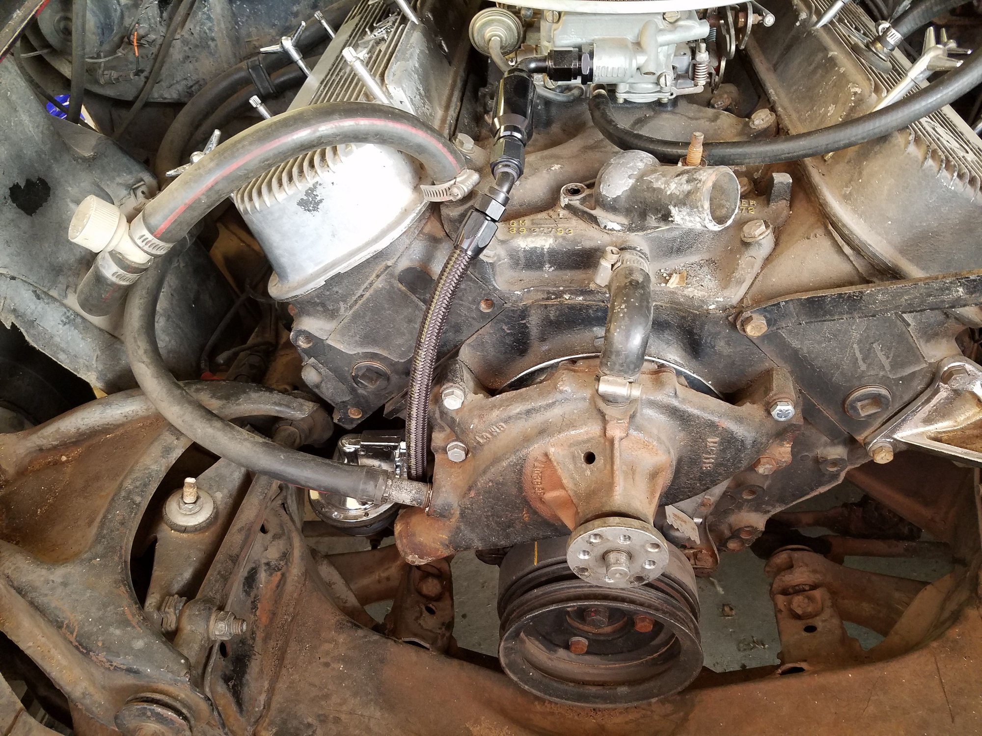

Here's the fuel line coming up from the pump to the carb with the inline filter.. Please don't mind the mess plenty of project going right now.
It looks way more rusty in the picture

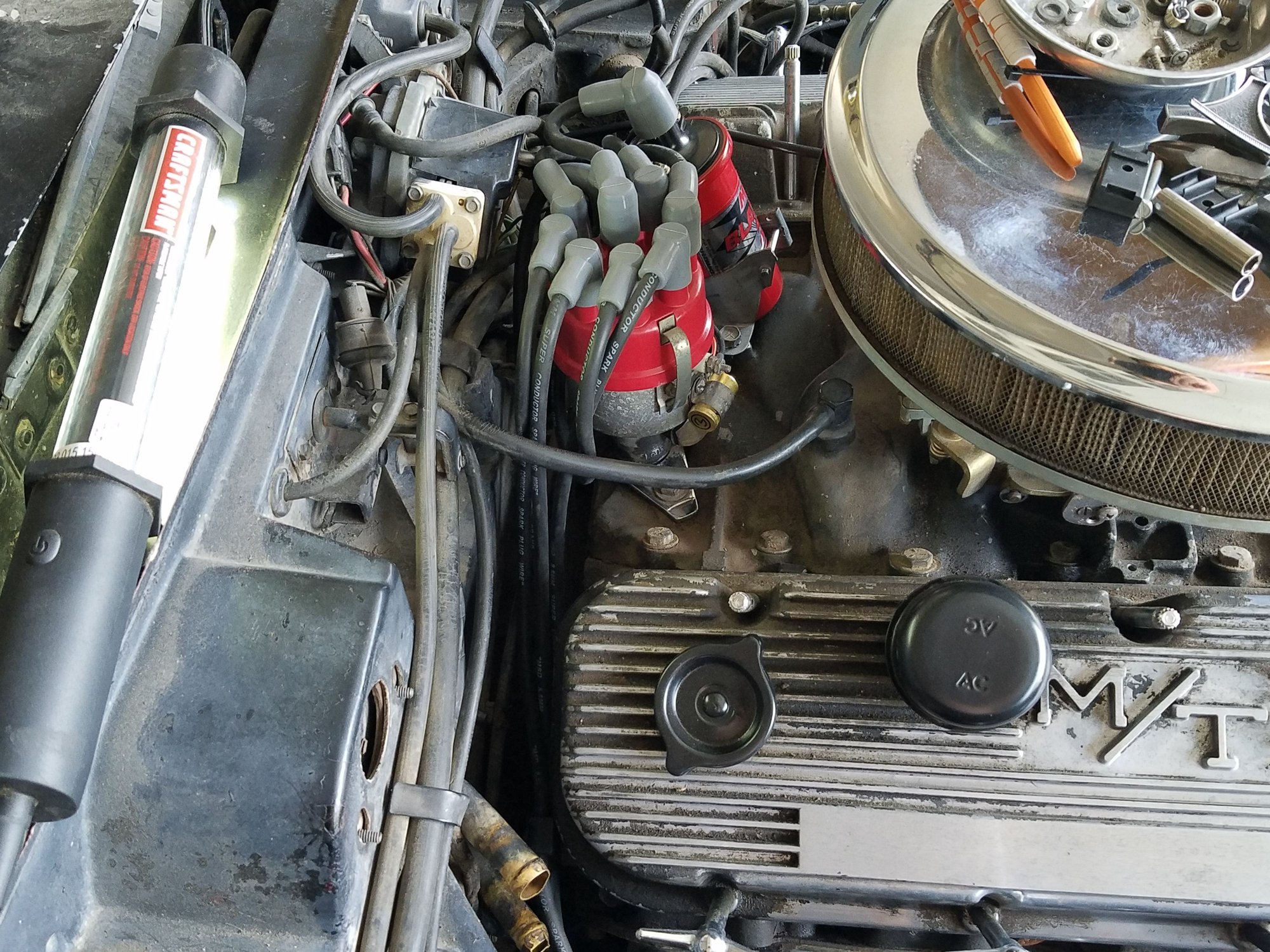

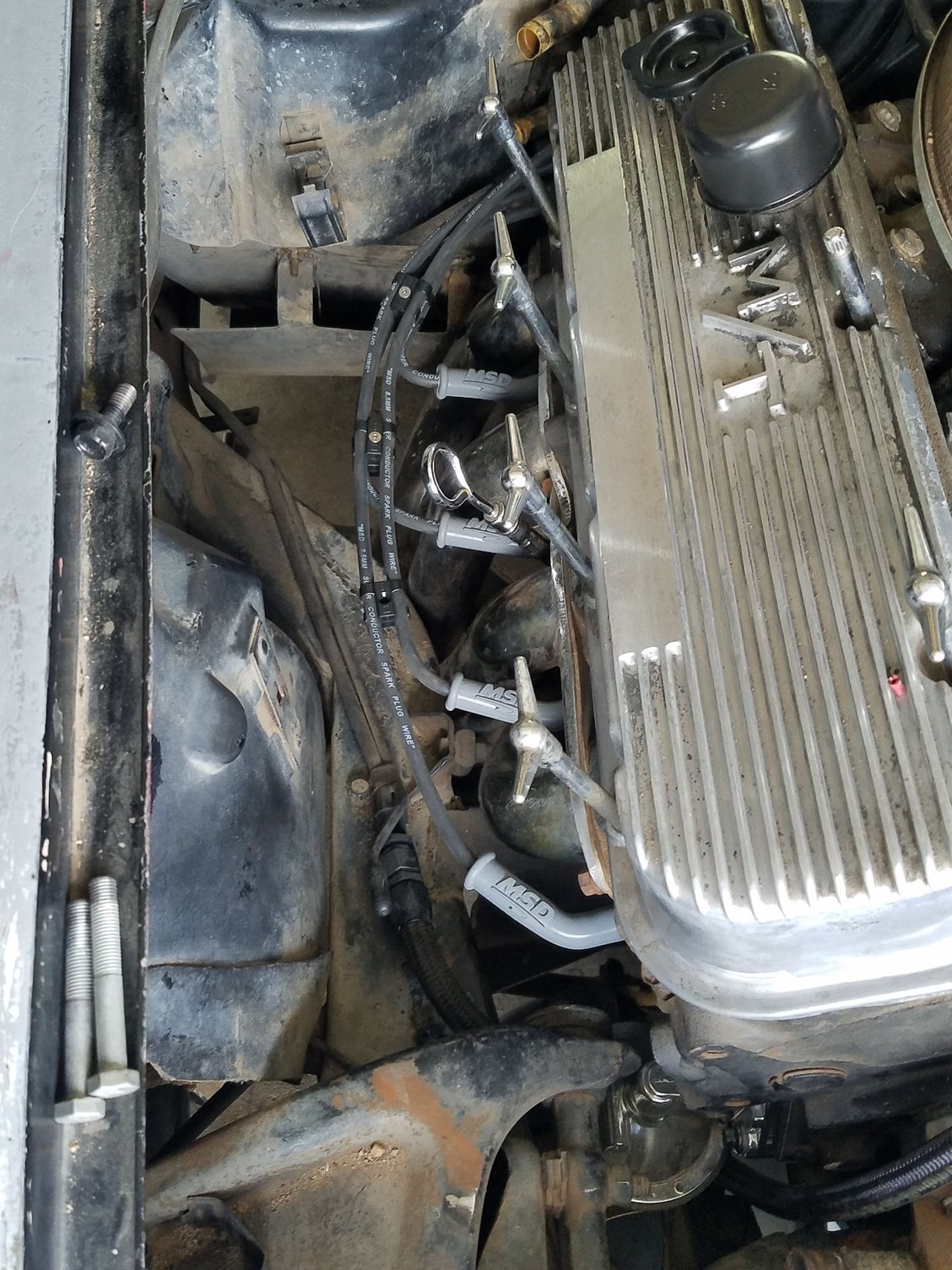

From there I got busy trying to make the engine look as good as I can with out pulling the motor and spraying it... Stripped the paint off the intake, thermostat neck, and valve covers. I re sprayed the valve covers with some VHT wrinkle finish. and hit the neck, oil cap and breather with some low gloss engine black. ordered up some ARP bolts to be flashy also added a summit 14 black air cleaner with filter..
Currently working on the brake system, I got a full SSBC caliper set a complete SS line set, Russell Hoses and a New GM master cylinder. so far I got the new firewall gasket, master cylinder, and all but the rear hard lines in.
Almost for got got the ignition all fresh..with new points, coil, cap, rotor, condinsor and custom wires...

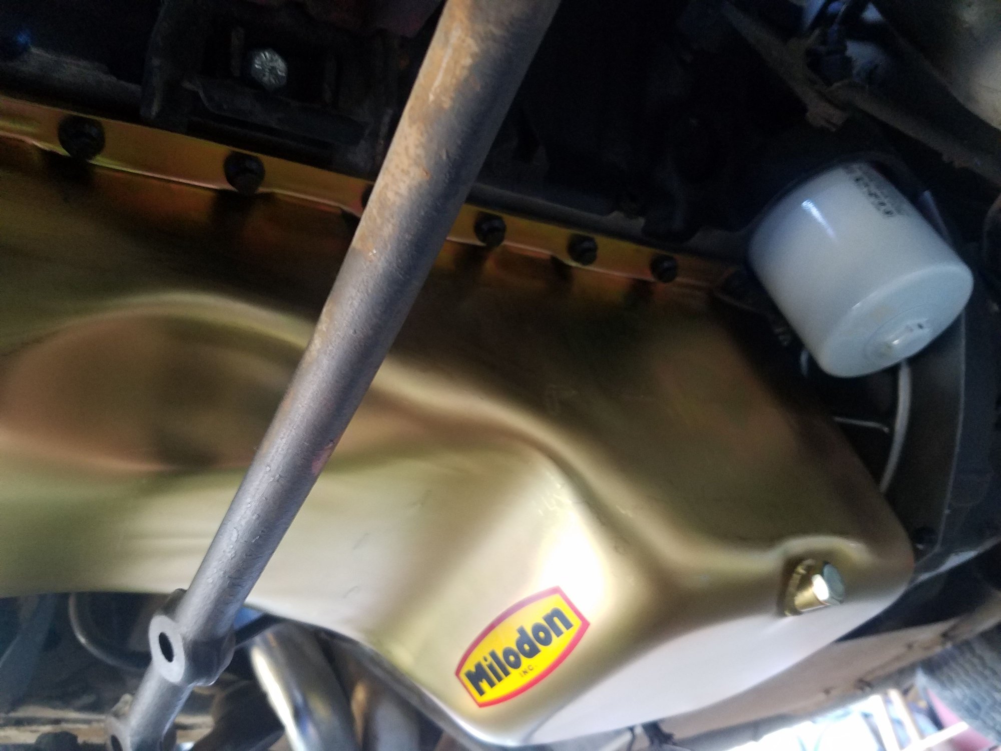

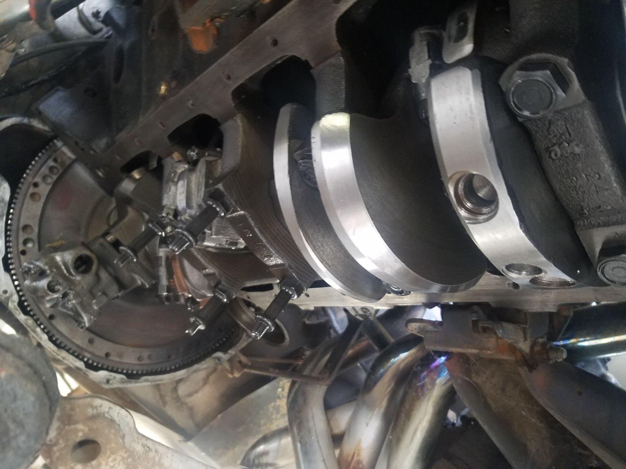

Got some work done. Replaced the oil pan as the old one had a few dents that had me concerned. Used ARP hardware and a felpro one piece pan gasket..

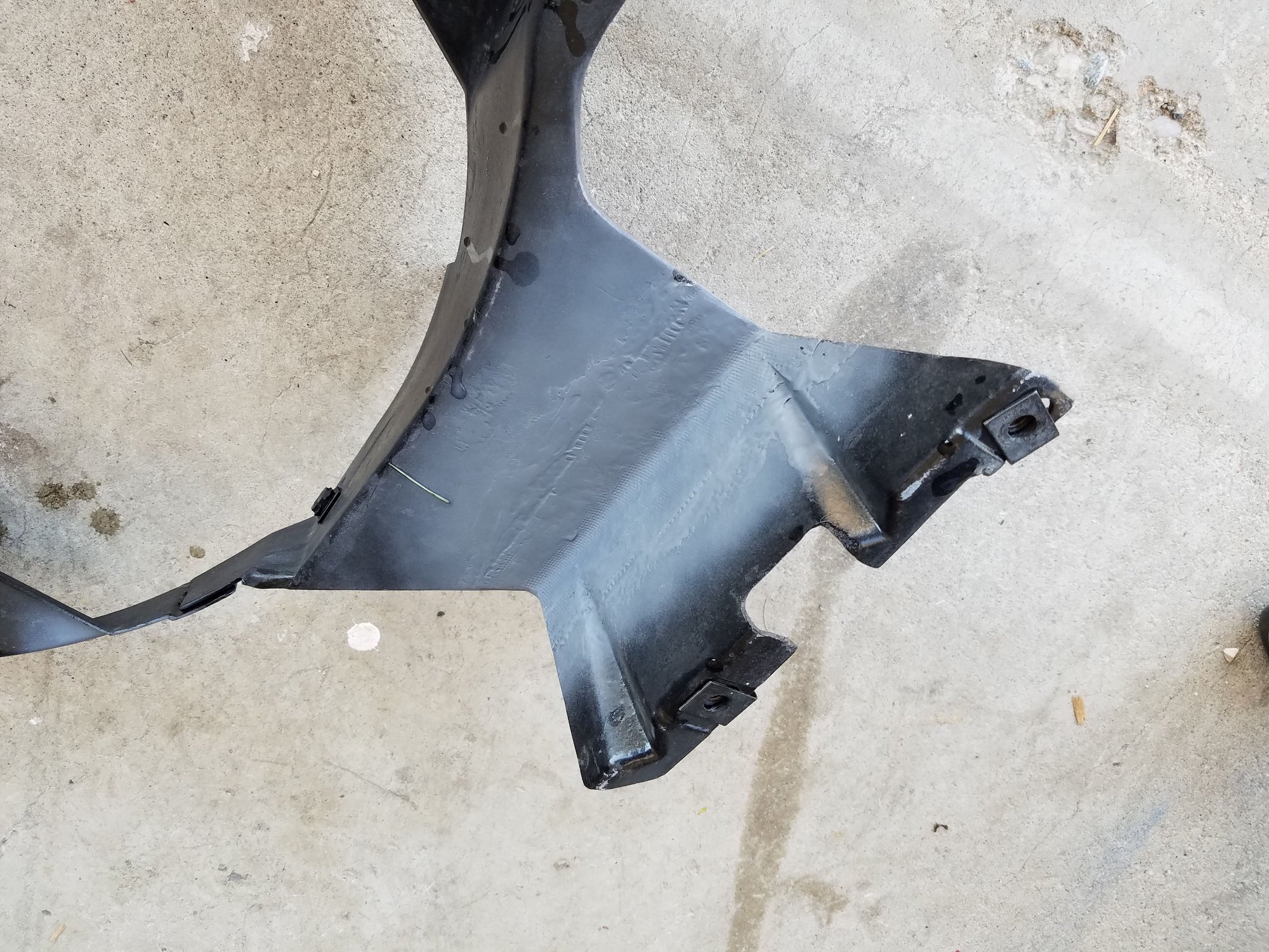

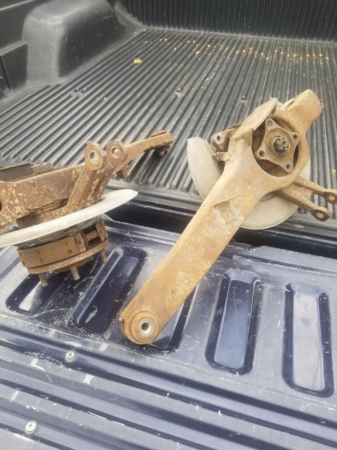

Getting the rear suspension all sorted. Got a stainless brake line kit installed..new diff bushing installed new battery cables. Painted the leafs and installed new liners... sending off trailing arms to vansteel today.
Rear end getting cleaned up
