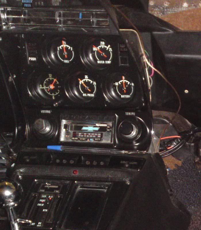

I have 2 of them with my 68, 1 early, that came with my car, or should I say whats left of it, and a later one that a friend gave me. On the early one which I believe is original to the car, to the right of the temp guage, below the door ajar light, the window is blocked off. My later one isnt. Behind that blocked off window is a low fuel light, however no wiring for it in the harness. Perhaps on 69 that red lens and light is visible. Also the peice that slides in above the gauges to mount the windshield wiper switch has 1 hole in the center of it to attach the small heater duct that protudes through there to it. Not 2 holes. No guru here for sure, but thats how my 2 are, both smooth also.
There are 2 center gauge bezels for 1968. The early one is the one with the lower right side lens blocked off, not the later one, and it's a wiper override lamp, not a low fuel warning one.
The early 68 has a lens on the left that says "Seat Belt" on it, and a button under it marked "Push", which shuts off the seat belt lamp. On the right side there is a headlight warning lens in the top half of the space, and the bottom is blocked off.
The late 68 bezel is the same as the early one, but the right side bottom hole is open, and a wiper warning lens is installed in the hole.
The headlight and/or wiper warning lights, were designed to come on if the headlights or wiper door didn't open, so the driver knew to use the override switch. Both 68 bezels have a smooth finish to the face of them. The change in bezels took place somewhere around VIN 5,000.
69-71 bezels are the same as the late 68, but the face of them has a grain finish cast into it. On the 69-71's, the right side upper lamp remained a headlamp warning, but the lower lens became a "Door Ajar" warning lamp (instead of the wiper one).
72-76 bezels have the left side seat belt push button and lens replaced by a larger "Fasten Seat Belt" lens. Starting in 72, the push button wasn't needed, as the seat belt light was controlled by a timer.
