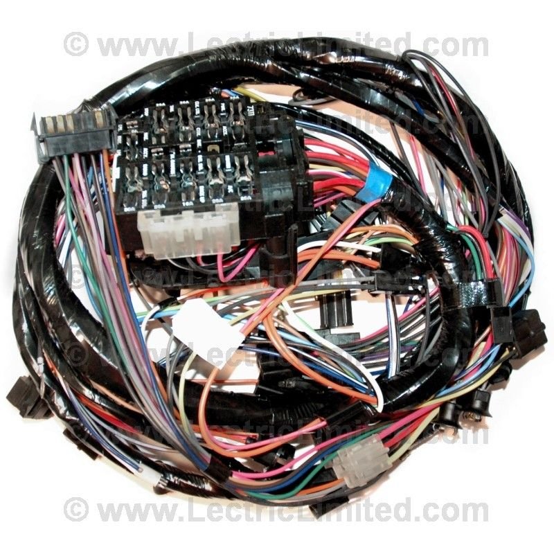

I am gutting the interior out of the car completely this time. Sound and heat insulation, new gauges, new wiring harnesses front to back (starting with dash harness), new dash pad, all new electrical switches and so on... My wife kicked this off with a Christmas gift of the new dash harness from Lectric Limited. Super impressed with the quality and I'm most of the way through removing the dash and all of the AC/Heat systems. I have some photos on my phone and will post them up.

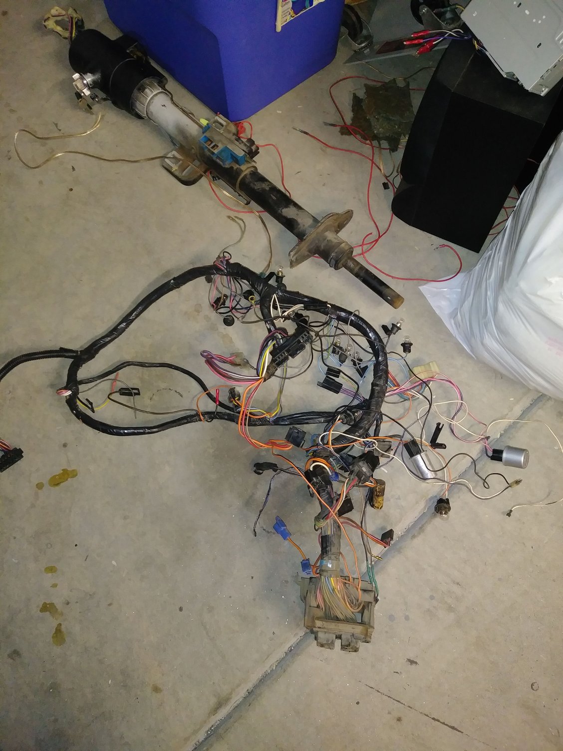

Old harness and column are out. Amazed this thing didn't burn to the ground. Hacks upon hacks, bare wires, melted wires. New year - new harness!
