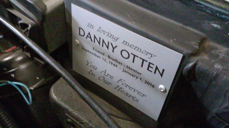

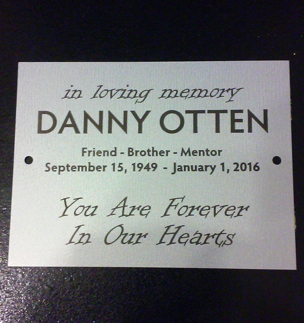

As a remembrance of my cousin who passed away on Jan. 1st we have added a small engraved plaque to the engine compartment of our '77.
Not only was he a Vietnam Vet, but he was more like a brother than a cousin to my family. He also was a huge influence / mentor for me when I was young and starting to learn about cars. This will be an awesome reminder of what a great guy he was, and to know that he's there with me, guiding me when I'm working on it.
Among his projects over the years were a '69 Camaro 302 car, a 70 Buick GS with a Stage2 455, a 73 Vega with a nasty 327 in it, and a variety of other GM products that he owned and modded.
Proud to have his name on our car!
