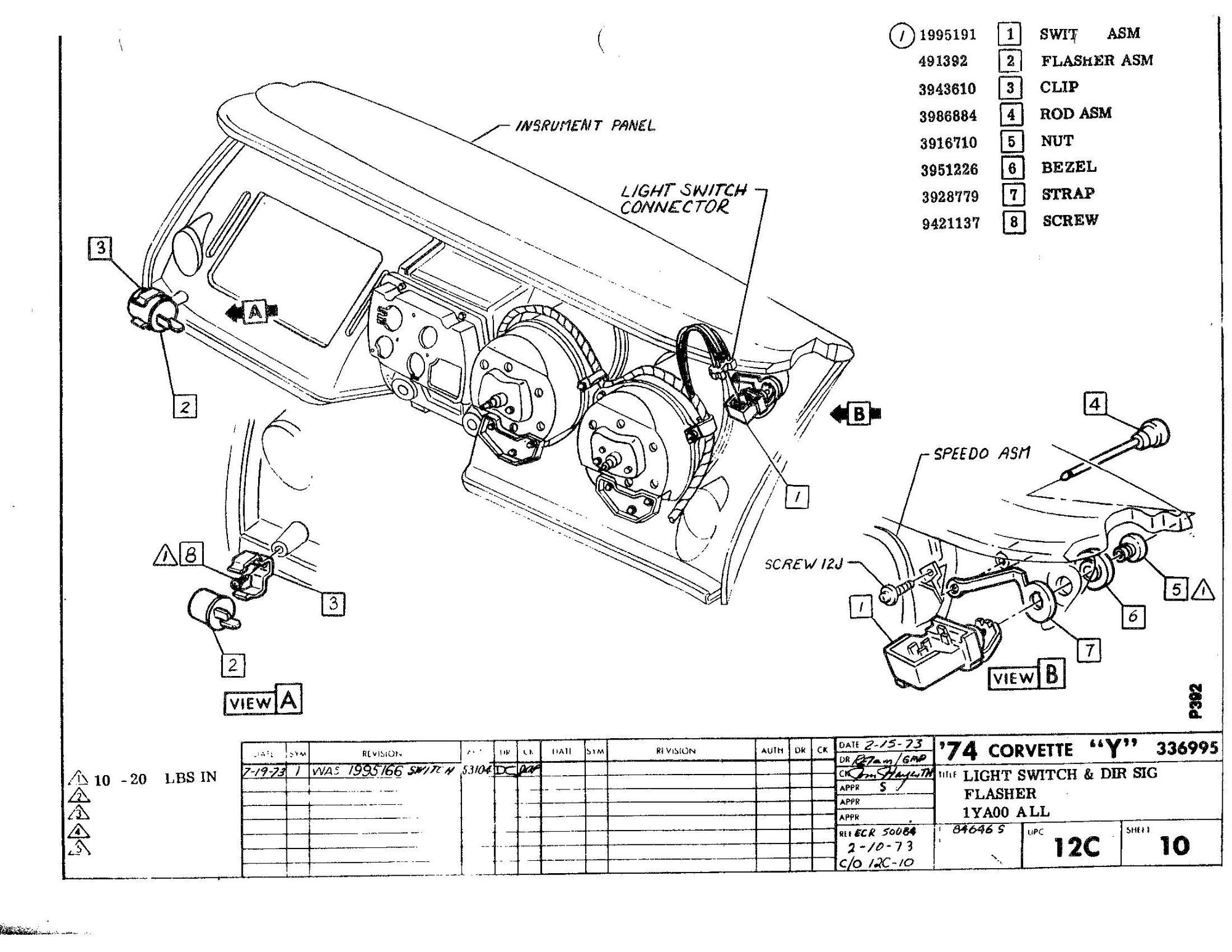

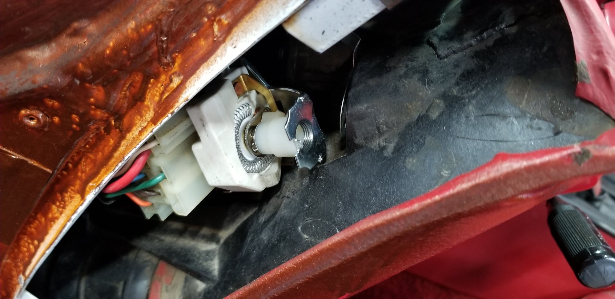

I feel like I'm missing something here on my 77. How do I get this to connect with the dash pad? Am I missing a part or just a step?
Many thanks!
Gregg
Old Nov 2, 2019 | 04:49 PM
Peterbuilt's Avatar
Peterbuilt
Joined: Aug 2006
Posts: 7,431
Likes: 1,561
From: mount holly NC
Default Does this help?

Peterbuilt....thank you so much! That solved the problem. Apparently at some point the nut disappeared. No wonder that step made no sense!
Now to get one ordered!
