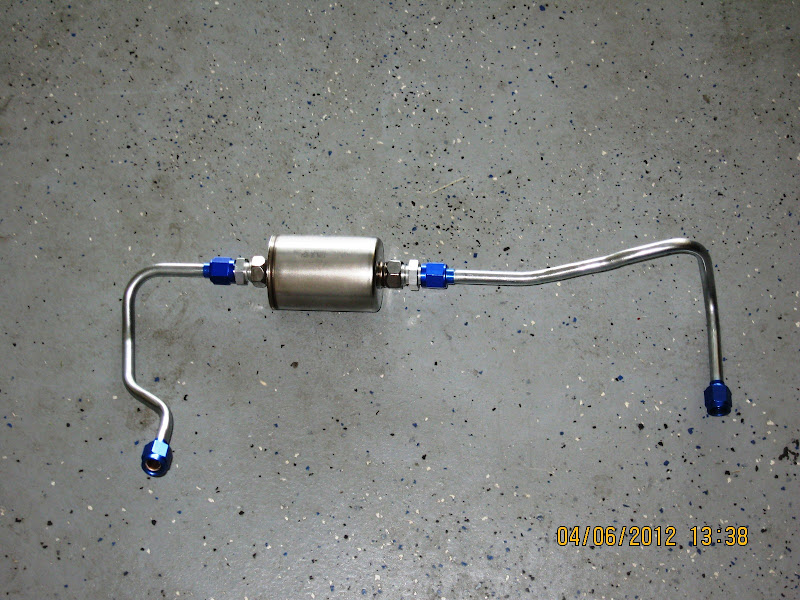

Bob,
They didn't install a fuel filter between the pump and carb? Rubber hose? I wouldn't go back either.
Edelbrock doesn't make the 8873 fuel filter anymore; I have one with a new filter I can send you. However, I recommend you fabricate a proper fuel line to avoid an engine fire with the rubber line.
I’ll post some pics of the fuel line I built for my Edelbrock 1405 (very similar to your 1411) when I get home.
Steve

Hey Steve,
You woulda thunk that, huh? LOL
I'm not a mechanic, but I'm aware of the extremely high heat conditions under the hood and cracks and disintegration of the rubber.
For the price I paid for the conversion, a metal fuel line should have been included while doing the build.
I'll post a couple of pics of the setup.
Bob

Bob,
I think they were lazy, but let's not beat a dead horse
Step 1:
Get a proper fuel line and filter in place. No use in tuning if your carb is fouling from not having a filter.
This what I did:
Used a 3/8'' x 40'' Napa straight brake line, fuel filter for an '85 Vette, and some russell fittings:
Utilized the following tools, which cost me $40 and rented a double flare set from Advance Auto:
Installed:
First fuel line I've ever fabricated, took 4 hours to bend and fit. You can do it
Steve
