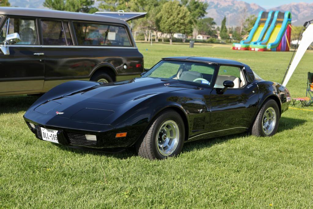

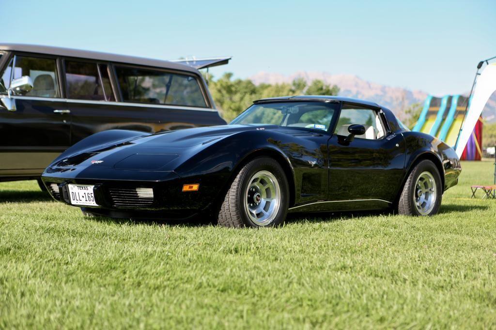

Ok so I am a little late posting this but I did get the car the 4th of July car show. It was a lot of fun but did not win anything. Going to try to go to two other car shows next month.
I don't yet have her aligned yet so I have only driven a few miles but it was a blast. Only issue that I have is the steering gear box has a catch and a pop. I am going to have to pull it and send it back I think.
