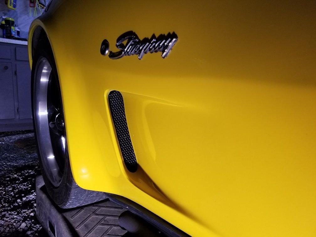

Old Sep 2, 2019 | 09:50 AM
obas's Avatar
obas
Joined: Jul 2011
Posts: 246
Likes: 15
From: Pell City AL
A bit late, but the finished product. Thanks for all the advice!
