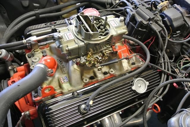

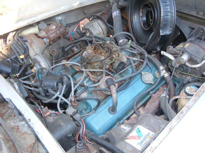

I'm guessing he's talking about the stamped tin covers vs the cast alum covers with the fins

Thanks for pics. big difference
