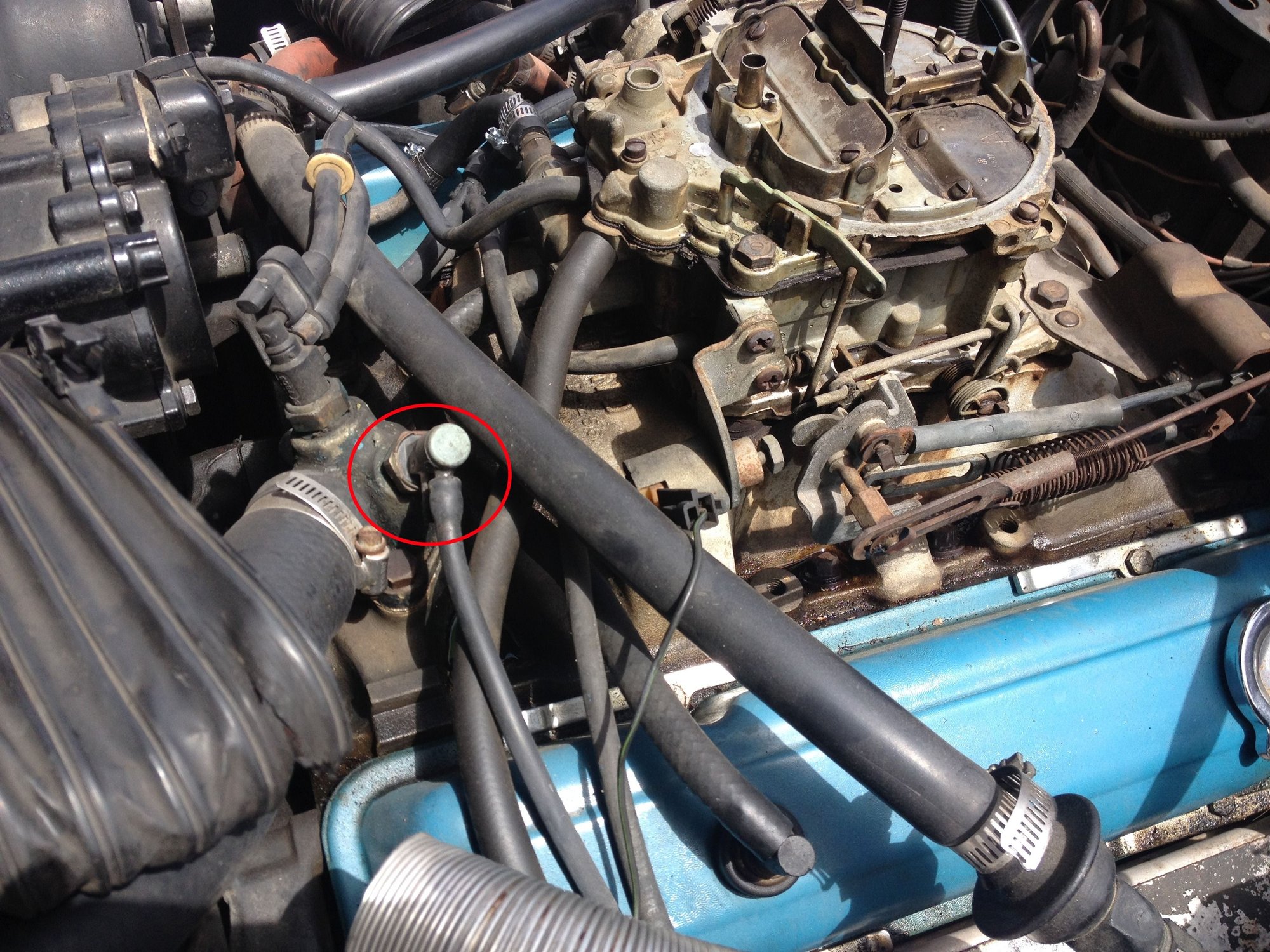

Looks like I'm missing a hose...what is it and what does it do? I'm guessing that's why I have a puddle of coolant on the engine.

The missing hose would be a vacuum line for something...not sure what. Coolant would not be leaking from the opening on the vacuum switch. Id check all the hose clamps first for the leak. See if there are signs of coolant any other place...it can spray and get blown around by the fan.

Thats the Purge TVS, it turns on the purge valve on the Vapor Canister. Looks like you have the line to the canister, so whats missing is the vac line from the throttle plate on the carb. Its a good thing to have working.
The green stuff says your thermostat housing gasket is likely leaking

Can you snap a picture of how that vac line runs from the switch to the carb so I can put a new one in? I'm trying to get this car running right and noticed that I'm missing that. Thanks!
