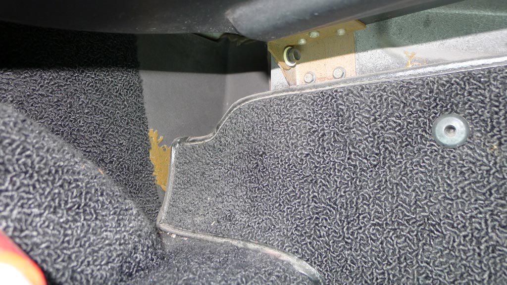

On my 73, the carpet just fitted under a rubber piece under the dash for the front carpet.
On the rear, there are 3 at the top of the carpet that ran up the back above the courtesy light.
http://www.corvetteblogger.com/image...2/101612_1.jpg
