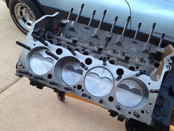

I remember when I was pricing 383 and 350 crate motors, it made sense financially to buy a 350 crate motor, but the 383 you might as well build yourself unless you just don't have the time. Having built my 383 it does take awhile to do it right, much longer than I anticipated. And if your not careful, there are some pitfalls to building a stroker motor. At least with a crate motor if it's a reputable builder you have some confidence it was built right.
Old Sep 29, 2014 | 10:35 PM
htown81vette's Avatar
htown81vette
Joined: Jun 2011
Posts: 1,704
Likes: 27
Here's my 383:
