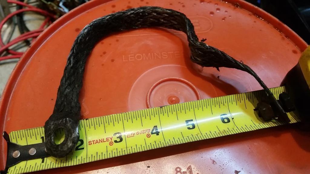

I was looking to replace my engine ground strap but none of the online vendors seem to have the one I took off. So I'm trying to decide if mine is correct, and if so, where do I get another like it?
Here's what mine looks like. It's about 7/8" wide and is silver colored, not copper like most I see with the vendors.
Correct or not? Where's a replacement? Most say they are a radio ground, but this can't be a radio ground strap can it?
It was on the passenger side engine mount bolt going to the engine frame mount.

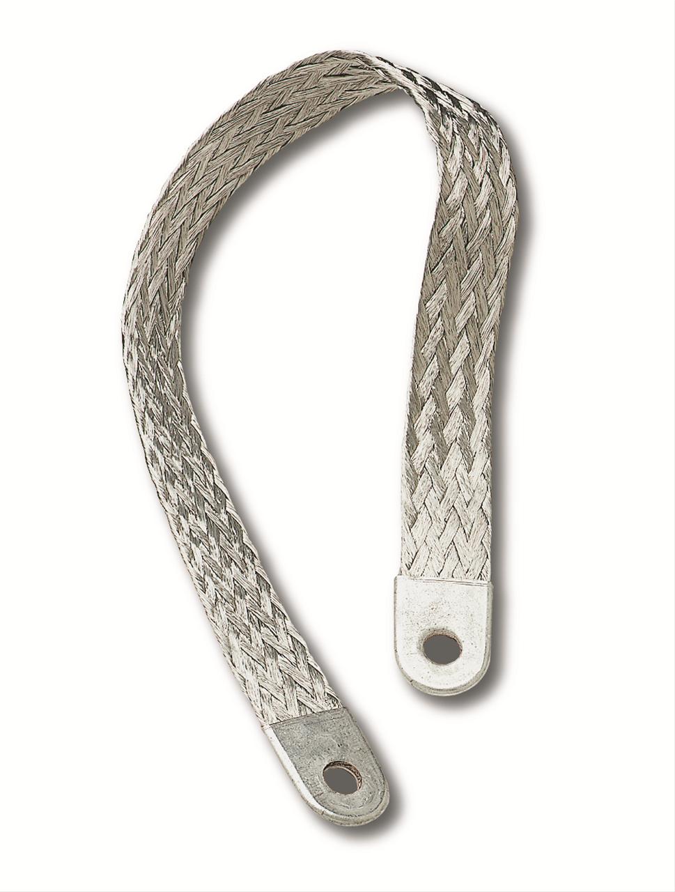

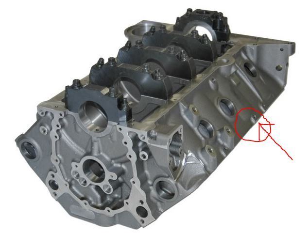

So it looks like the Dart SHP block I'm putting in has the same bolt hole for the starter brace. I'm going to be using an aftermarket starter, those don't use a brace do they?
Here's the correct strap from LectricLimited GC6871:
Or I can replace what was already there with what looks to be the same one Bubba had used from Summit at the same location (Engine mount bolt to mount frame bolt): http://www.summitracing.com/parts/rfw-gc12/overview/

My mini starter setup couldn't use the brace. I had to use a shorter bolt to mount the ground cable to the block. The power to the starter will be limited by the ground strap; the OEM is a good choice. Nice choice on the block!

Old Nov 5, 2014 | 01:04 AM
StingrayLust's Avatar
StingrayLust
Joined: Feb 2011
Posts: 850
Likes: 12
From: Shakopee MN
Originally Posted by KapsSA
pic
Thanks Kaps, excellent picture.
