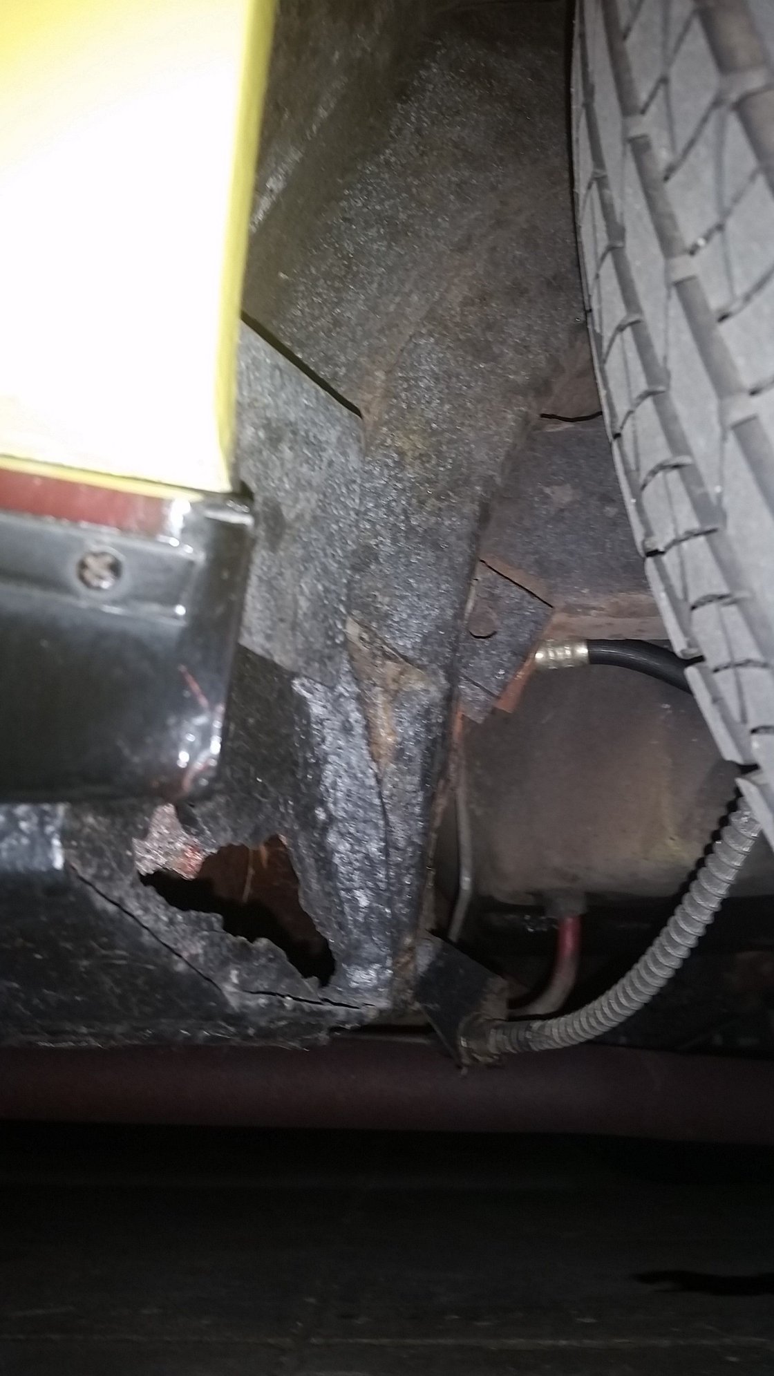

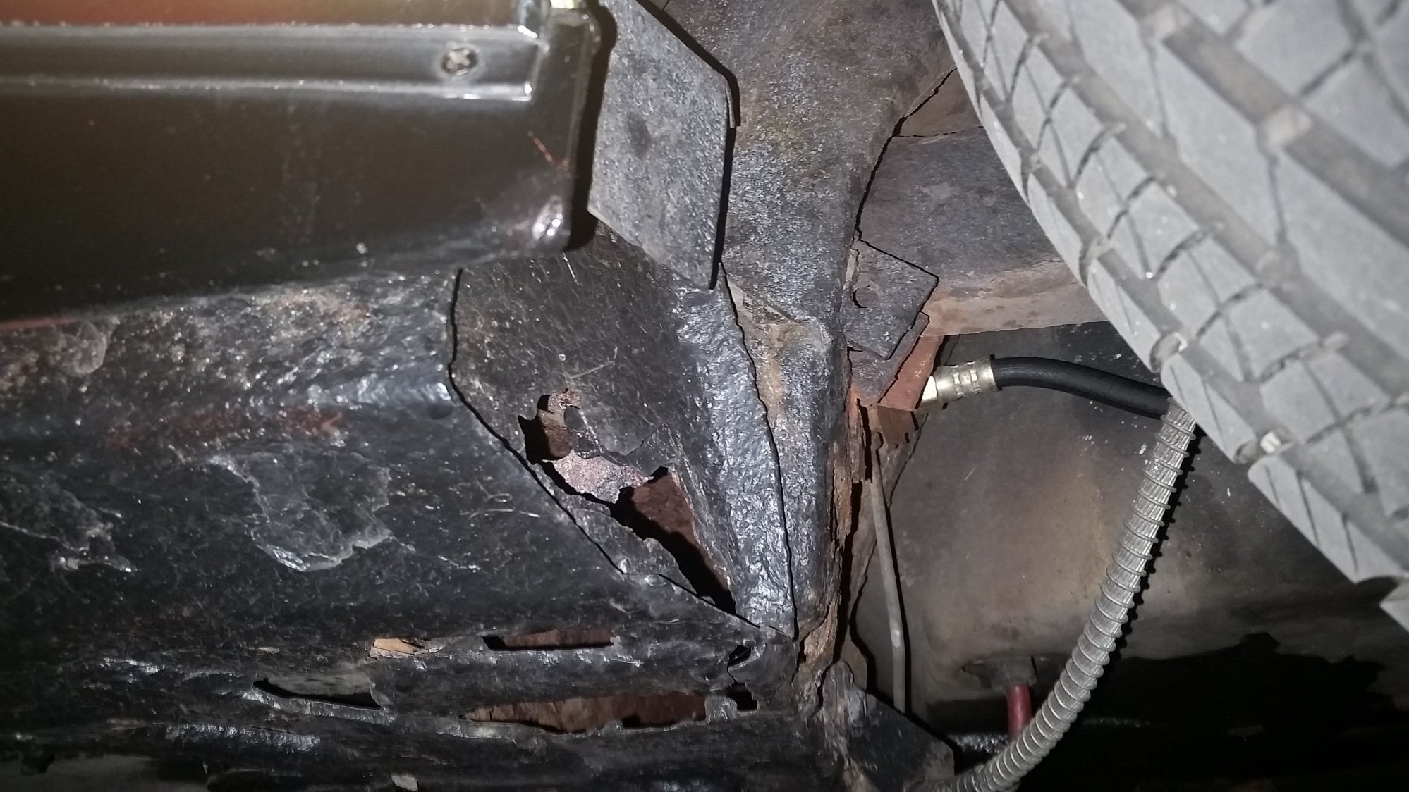

Looking at purchasing this nice (on the surface) 1969 coupe. BUT.....looking behind the door in front of the back tire, I see this....
How bad is this without seeing the rest of it?
The seller has owned it for 16 years and babied it and stored it in a heated warehouse.
Thanks for the help,
Red Perch
Behind driver's side door
Same spot
1969 coupe 350/300 manual

Hi RP,
There's no reason to PAY to get involved with a car with a frame that rusty.
There's no reason to get involved with a car like that even if they GIVE it
to you.
Sorry!
Regards,
Alan

Run, Forrest, Run!!! Huge, expensive job to repair, and that's from just that one area. The birdcage and rocker channels are highly suspect to me also after seeing that frame.

That's not a "possible rust issue", that's a serious one. The frame will likely need to be replaced. Move on, there are plenty of chrome bumper cars out there, without those kinds of issues.

I agree with the above. Stay away from that car.

I have to go with the crowd on this. Even if this is the only place showing this degree of rust, I would bail.
We see this kind of rust in the shop often and the repair can become pretty intense. Me personally.. I'd not be scared of what I see.. but what's under what I see scares me worse.
Why you might ask? Because if the rust is that bad on the back of the member, the interior structure can be just as bad if not worse. In many cases we have found ourselves cutting additional access holes in the side member to gain better access to interior damage... (if anyone is interested I have tons of pictures on the white 65 we restored.... Same issue)
I feel sorry for the guy that owns the car, it's a really nice looking car but he should have this properly repaired and then sell the car.
IMHO,
Willcox

I might as well "pile on", for the sake of the OP. I don't know if they're still in business, but there used to be an outfit named 'Collier Technology', that made brand new, replacement C-3 frames. They weren't particularly cheap, but swapping a frame on an early C-3 certainly wouldn't be as difficult as a later model car, one that has all the electrical do-dads, and pollution crap, that add dozens of wires, black boxes, etc, to the car.
However, you're still potentially stuck with a rotted out birdcage. Replacing THAT can get expensive, as all the main body sections are BONDED to it, and removing those panels without damaging them, will be time consuming (expensive).
However, if by some chance the birdcage was OK, you could also put an updated frame underneath the car, and have a slick "resto-mod"....

I don't know that I'm an expert, but I'll take a shot at some numbers for you.
A new Vette Products frame for that 69, or a restored original one from America's Finest, will run about $5,000. If your going to the trouble of replacing the frame, you might as well rebuild the trailing arms, rear, engine, front suspension and take a good look at the trans. Your also going to want new fuel and brake lines, body mounts, exhaust, assorted hardware, and likely a gas tank too. The labor for a shop just to pull and replace the body, is going to be $1,500-$2,000, not counting any additional work. That's easily $10,000-$15,000, without figuring in any body or interior work, that may be needed.
As bad as that frame is, I'd say the chances of finding rotted out a-pillars, and possibly the whole windshield frame, are pretty good. So add $1,500-$2,000 to repair the a-pillars, or maybe $2,500-$3,000 for a-pillars and a windshield frame, and that doesn't include the paint.
One of the shops I deal with, is doing a 70 right now, with problems similar to the 69. The car was bought on ebay, sight unseen. The seller claimed that it was rust free, and provided pictures of the frame. Turns out the frame was filled with bondo, to hide some extremely serious rust issues. The cowl/a-pillar area was also shot, and the body and paint weren't all that nice in person either. The price for the car was the mid teens, but by the time the frame is replaced, and the paint and body work is done, the owner will be $40,000 into a base motor, low option, 70 coupe!
Personally, a chrome bumper car with a frame like the one under that yellow car, I'd value at around $5,000-$7,000 tops, and that's IF the A-pillars and rockers are solid.
