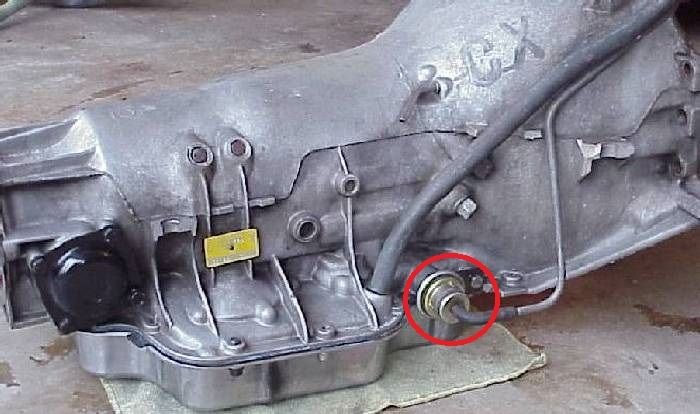

Sounds like a vacuum issue, you need to check the vacuum modulator. Check to make sure the vacuum line is not cracked and that it is dry. If the vacuum line is wet the modulator needs to be replaced.
Awesome thanks for the photo i had no idea that was there. i will put it up on a lift and take a look. the reason i asked about the exhaust is because i want to replace the current fake dual with side mounted exhaust.
If you need an excuse to change the exhaust, then yes, that's your problem.
But really I am pretty sure you have a modulator issue.
If you chase the metal line up to the engine you will find it also has a small rubber hose connected the the intake manifold, make sure to check it for cracks also.
Awesome! you have all been a ton of help. i thought the repair was gonna cost an arm and a leg but its only like $12! the soonest i can get it up on a lift will be friday or saturday but i will keep you all posted. just looking at the modulator it just pushes into the transmission? Any ideas of a good place to get the side mounted exhaust?
Yes, it just pushes in. But there is a forked bracket to hold it in place. Just a one-bolt job.
When I removed mine it appeared that the internal diaphragm had developed a pinhole leak and some transmission fluid had found its way in the vacuum tube. This caused some erratic shifting.
