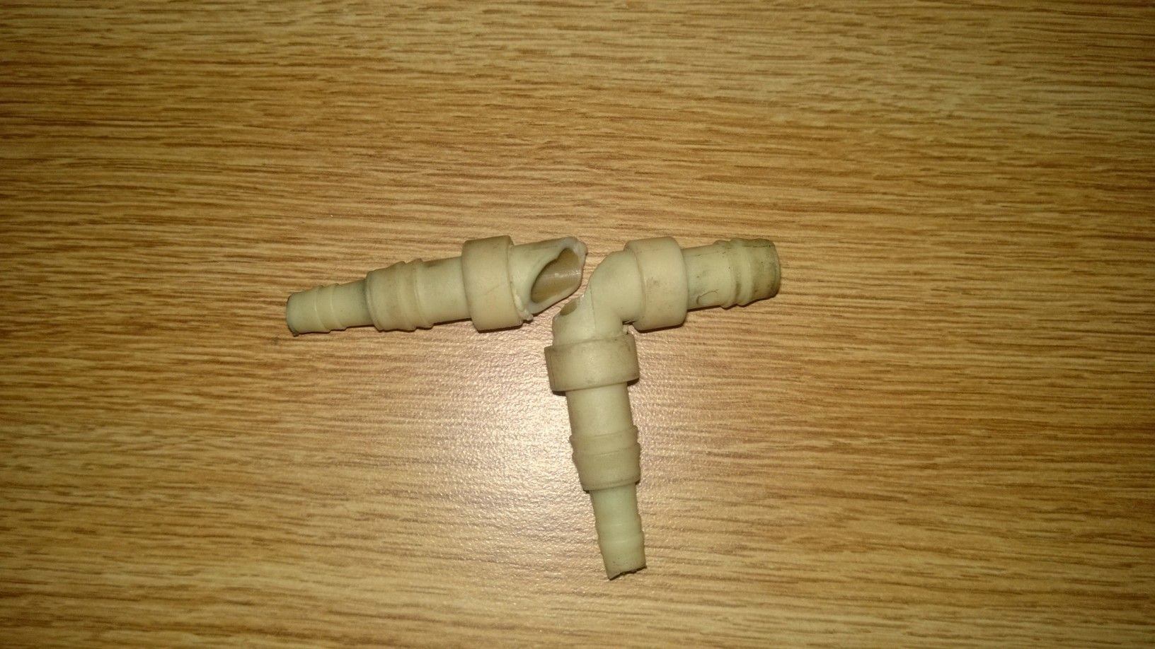

when it shifts down i don't speed up i slow down. but i traced the vacuum modulator up to the intake and i found a T where it connected and i move the T a bit and it completely disintegrated. im gonna try to replace that and hopefully that was the problem.

heres the T that broke i am going to Napa and auto zone to see if they have something to replace it with. this T has i believe the transmission vacuum line on it and a line from the brakes?

Or, you can just piece it together and 'pot' the broken joint in JB Weld stick [2-part putty] epoxy. It may be difficult finding a fitting just like that one.

oriellys had the T it was like a dollar. the transmission side of the broken T was partially clogged so maybe that was my issue?

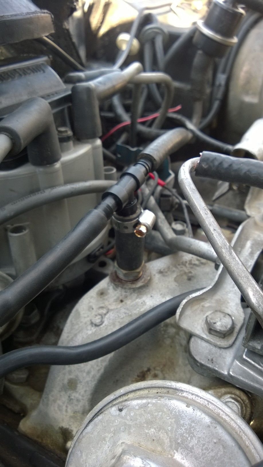

I am having a hard time imagining what setup you have at the back of the intake that would need the plastic adapter. The transmission and headlamp vacuum should come from a "metal" fitting screwed into the back of the intake (pic shows one I use but they vary from year-to-year). Brake vacuum comes from a metal tubing screwed into the back of the Q-Jet. Can you post a pic of what you have?

that T looks like what should be there. i think the previous owner may have just putt a threaded nipple in and put a hose on it then the T i currently have on it. yeah ill get a pic of the intake on here.

this is the setup i have. this is just behind the carburetor.

That looks like a later C3 L-82. The setup looks OK to me. I don't know what else to say at this point....
