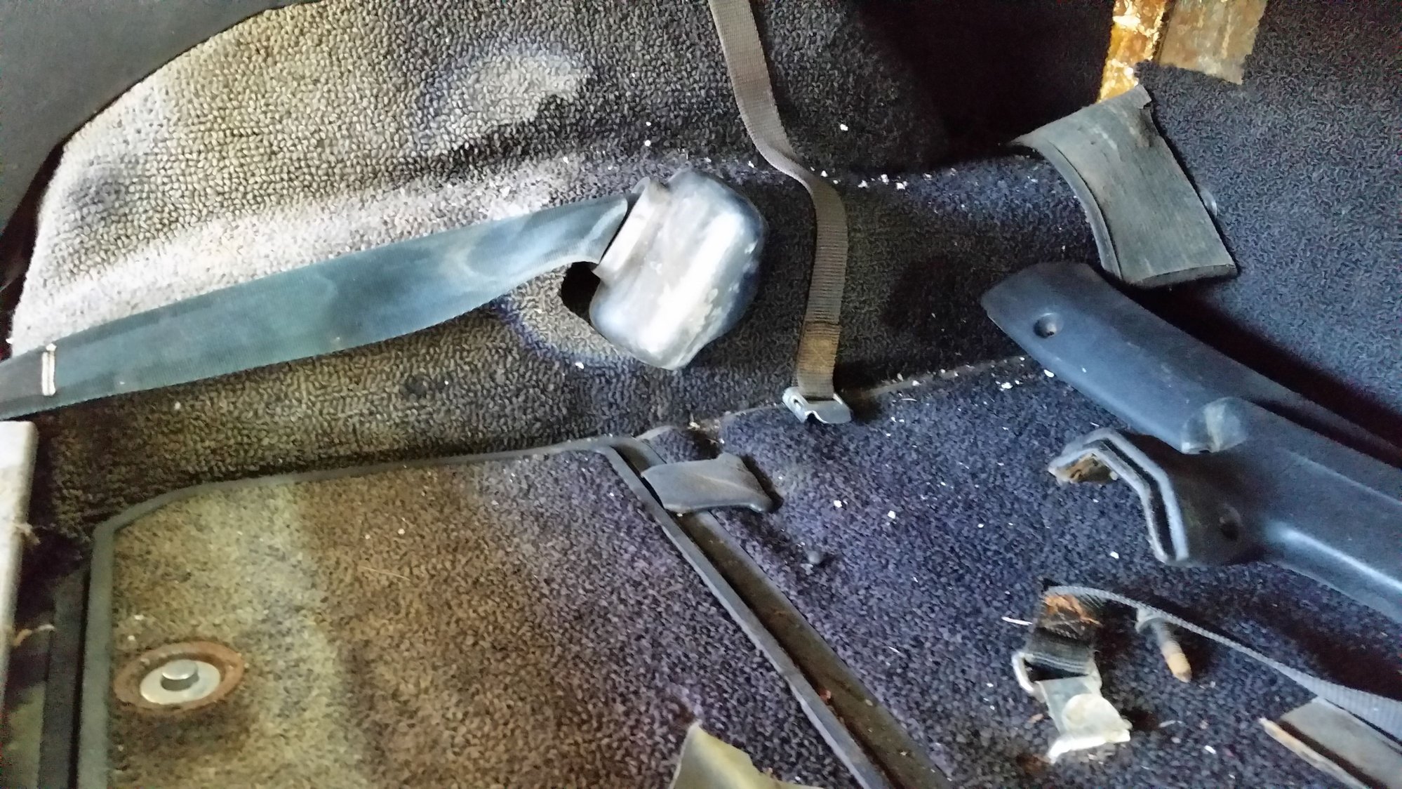

Here are a couple of pics of one off my 69. The first one is from the back side of the unit with the cover on. You can see the two spaces where you can hook your fingers in from the front to pull the cover off. The second one is from the front side with the cover off to give you an idea what's in there.

The picture sure do help. Now I can see what you were talking about with grabbing the cover. Always nice to have an idea what lies beneath something.
