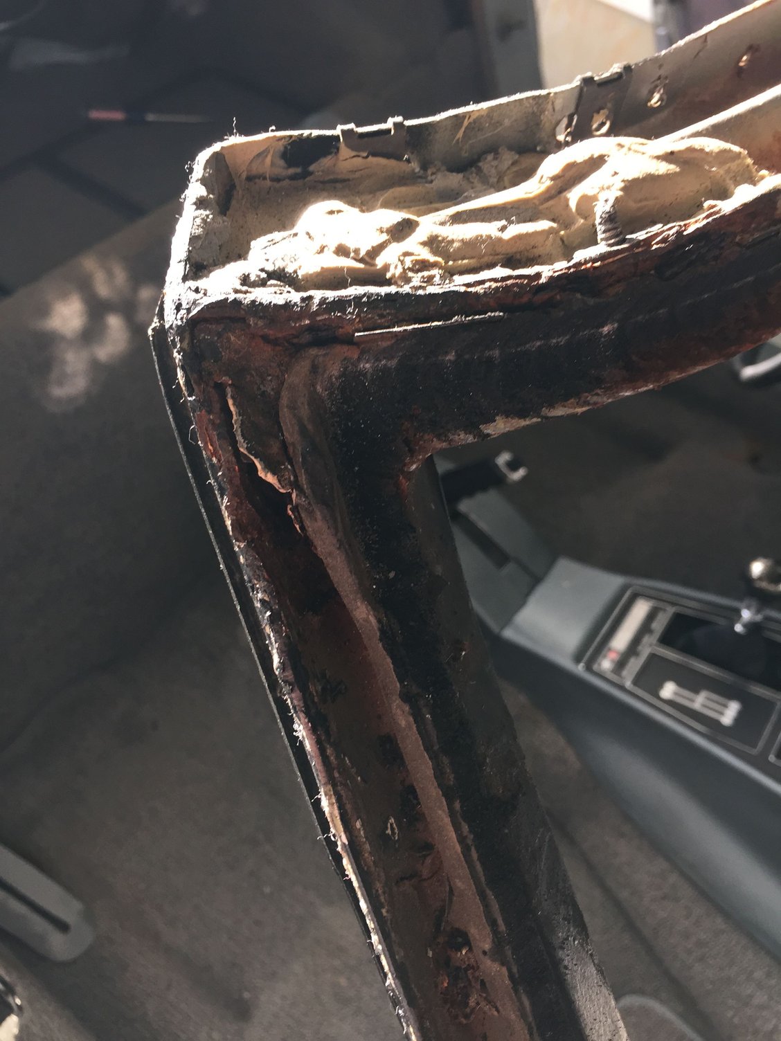

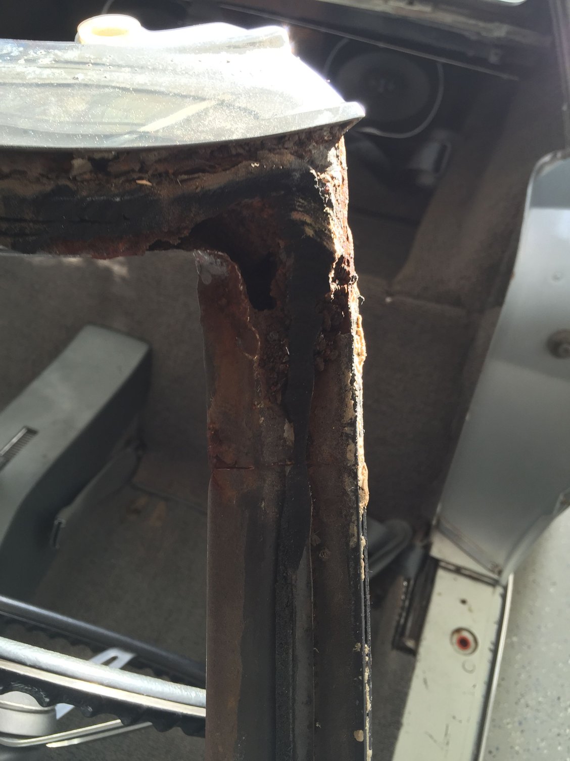

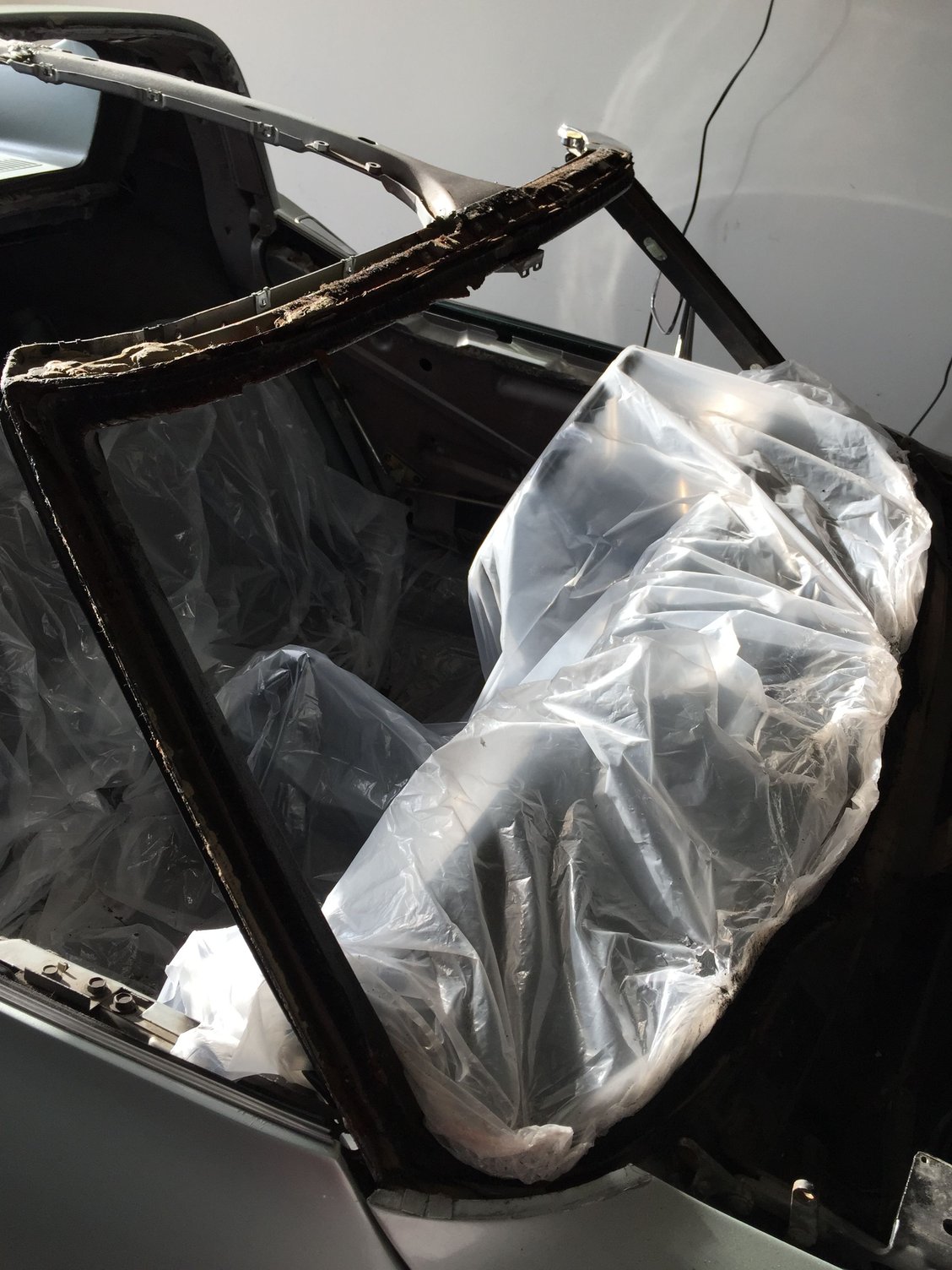

Thanks for all the advice guys. And thanks for sending me that link Willcox.. lots of good info in there. I took the windshield out today using pretty sturdy picture frame hanging wire and 2 large dowel rods as handles. The wife even helped by heating up the adhesive with her hair dryer as I sawed.
Some neat things, my window has a date code of TY, which I believe puts its manufacture in October 1970. The windshield did not survive removal.. but it was pretty badly pitted anyways. I'm probably going to go with Auto City Classic as a replacement.
I plan on cleaning up the frame with the
Eastwood Rust Brush Eastwood Rust Brush
. I will post more pictures when I am done so you can see the full extend of my birdcage damage. Here are some closeups of the corners.
I have a feeling some welding will be in my future...
