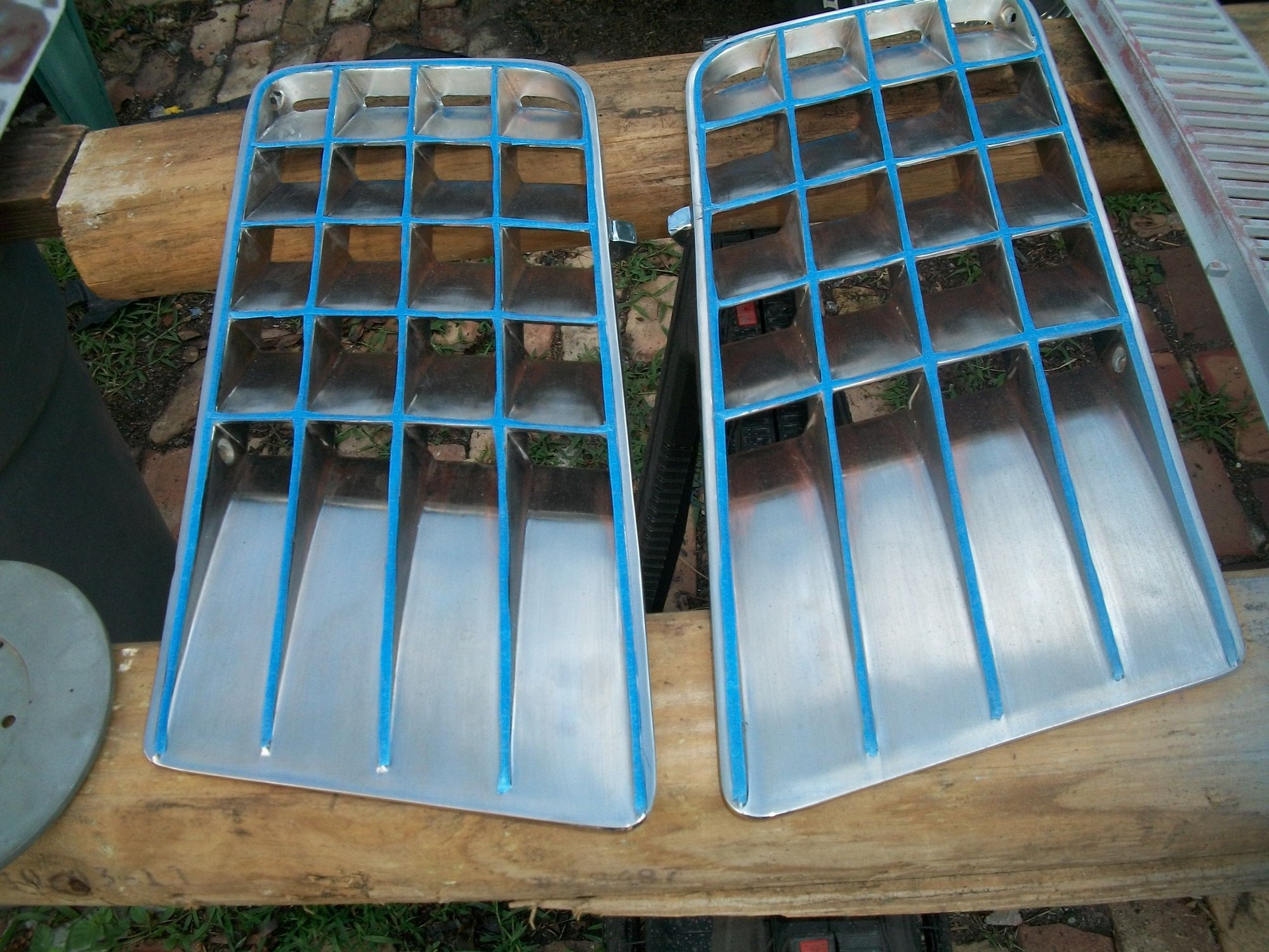

We didn`t use anything as aggressive as 40 grit, but we did as mentioned above.... taped off the ridges, then sanded the chrome (by hand)... then applied the primer. They came out pretty good.

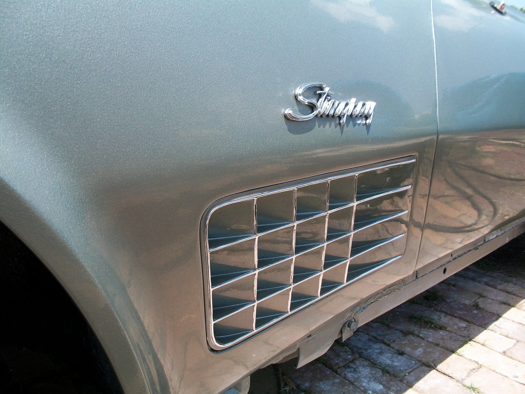

ogto shows the SIDE grills which I do think benefit from sanding with something like 220, but only on the large flat vertical panel surfaces of each grill.
